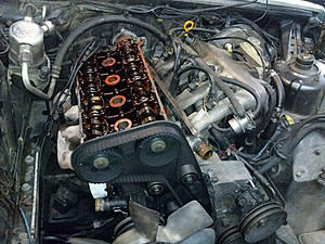

Removing the head...
Attached Thumbnails 740 2.0 engine problem: Low compression-img1629-.jpg

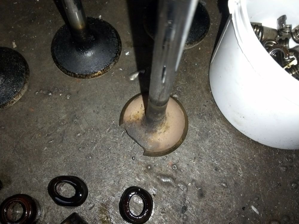

The end result is a broken exhaust valve.

Here is the broken exhaust valve:

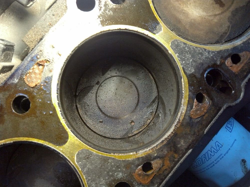

I also noticed that 3 of the cylinder heads had marks on them from valves breaking sometime in the past...

Taking a look at the piston damage it makes me suspect someone did not do a proper belt change and some of the valves hit the pistons. The GLE twin cam is an interference type engine where the valves can hit the pistons if the timing belt breaks or is put on incorrectly.

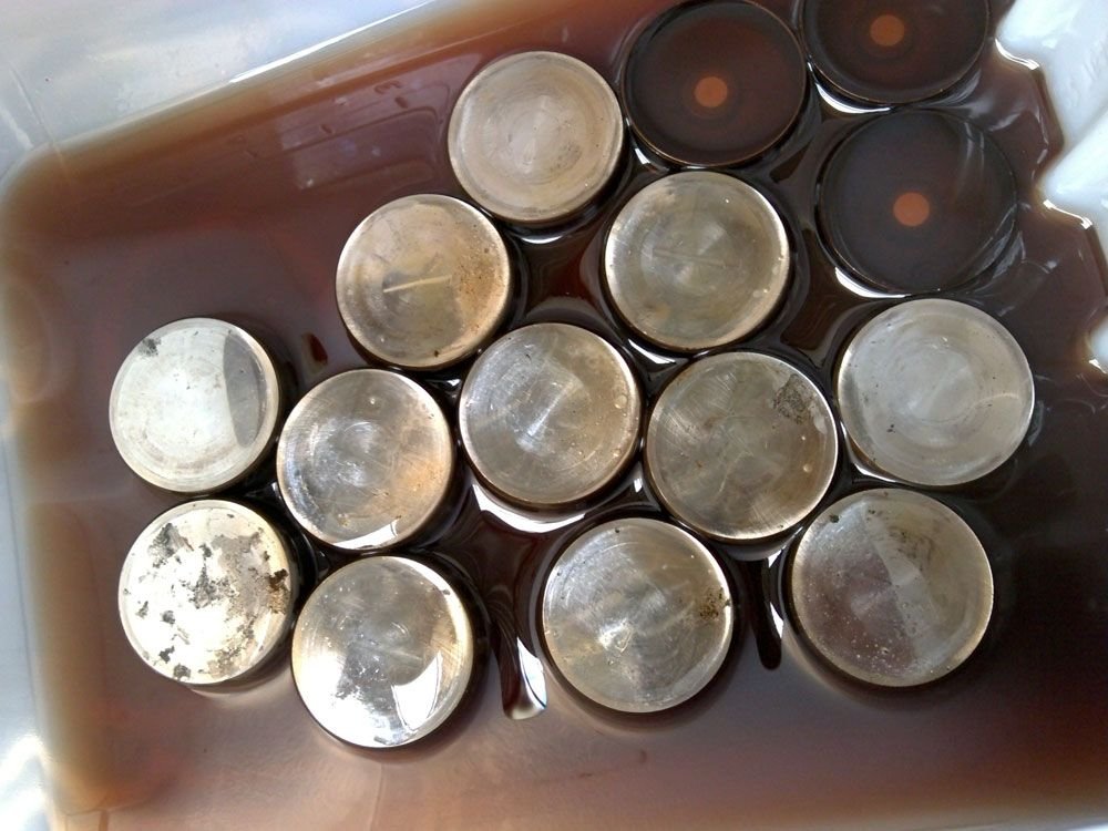

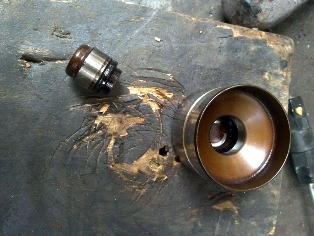

Default Hydraulic lifters
So I opened up the hydraulic lifters, as you can see in the photo the piston is very dirty. Most of them were really hard or stuck, others moved freely.
I'm cleaning them the best I can, without opening up the valve check because there seems to be a clip holding the plunger and I dont want to damage it trying to remove it.
Some people say to soak them/fill them with oil, others say leave them dry and let them fill in when the engine starts running. Opinions?
