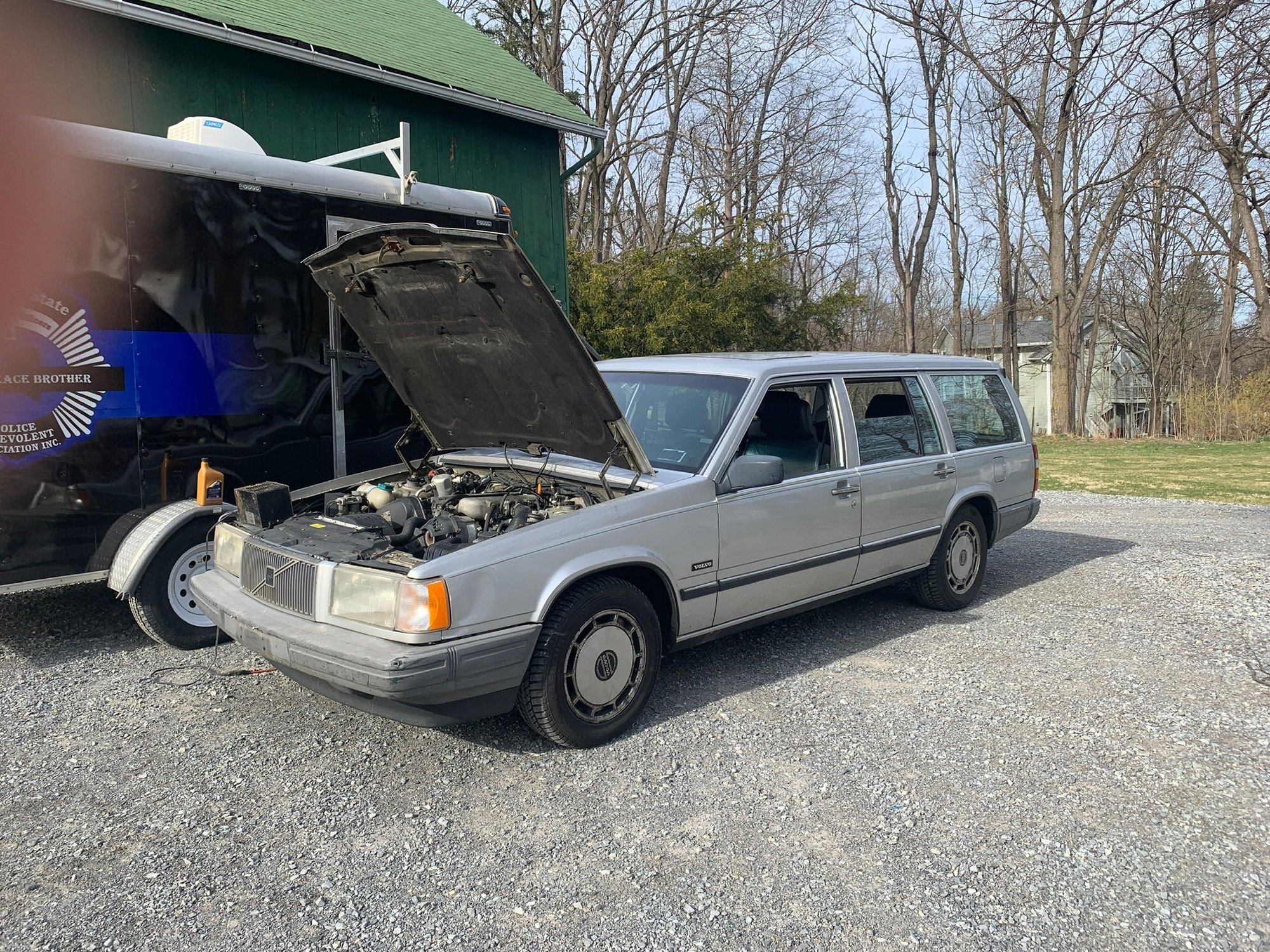

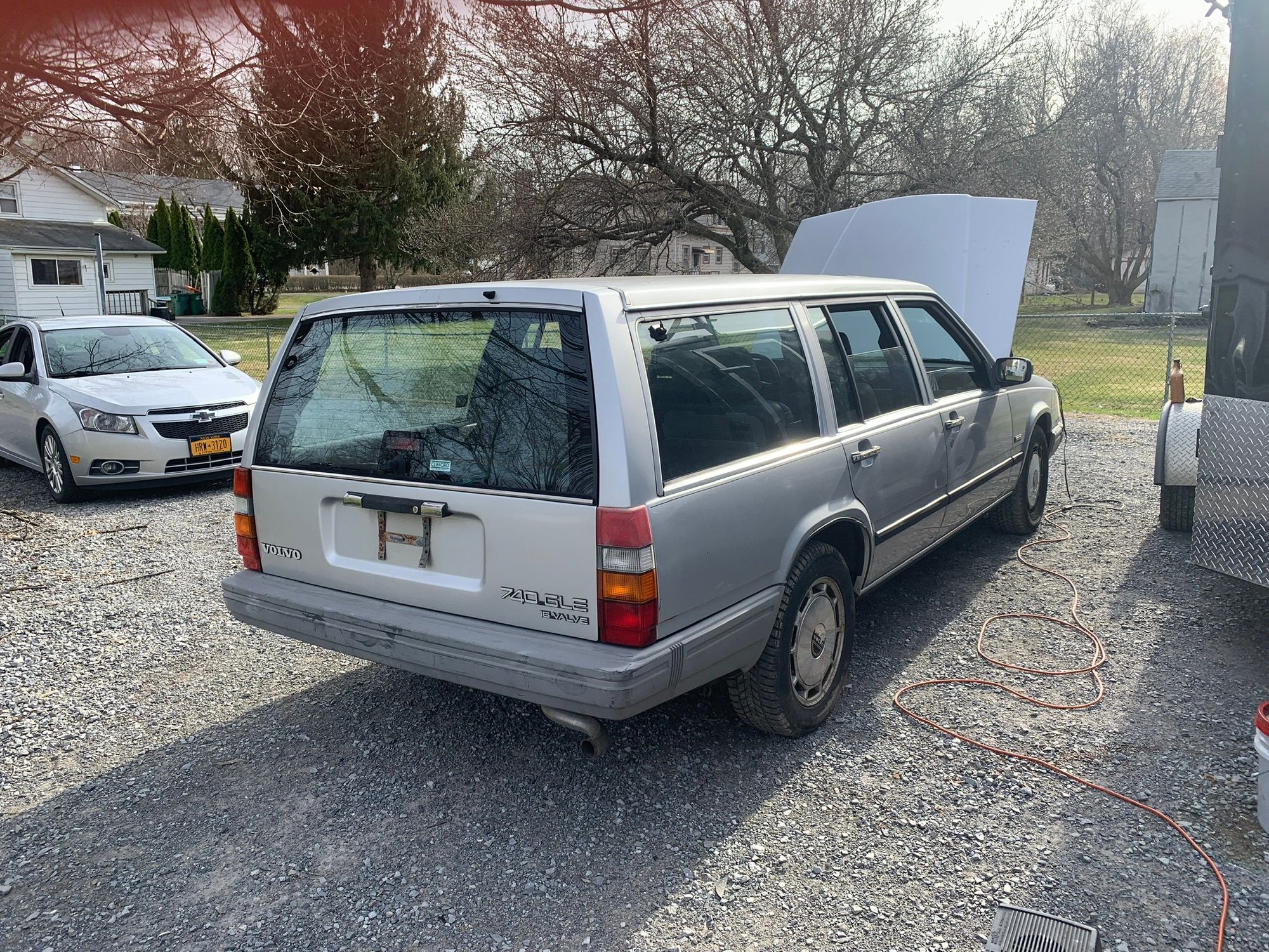

Good day all, I’m new to the forum and Volvo ownership. I recently purchased a 740 GLE and have come to the conclusion that I need to replace the head gasket based on some things I read on this forum when I was trying to diagnose a misfire that I have.
I haven’t been able to find an old Chiltons manual or anything as of yet to help me with instructions and I was hoping somebody on here might have a guide to it or a video or anything that might help me to not screw this up.
any assistance, thoughts, or words of wisdom would be massively appreciated. Cheers.
