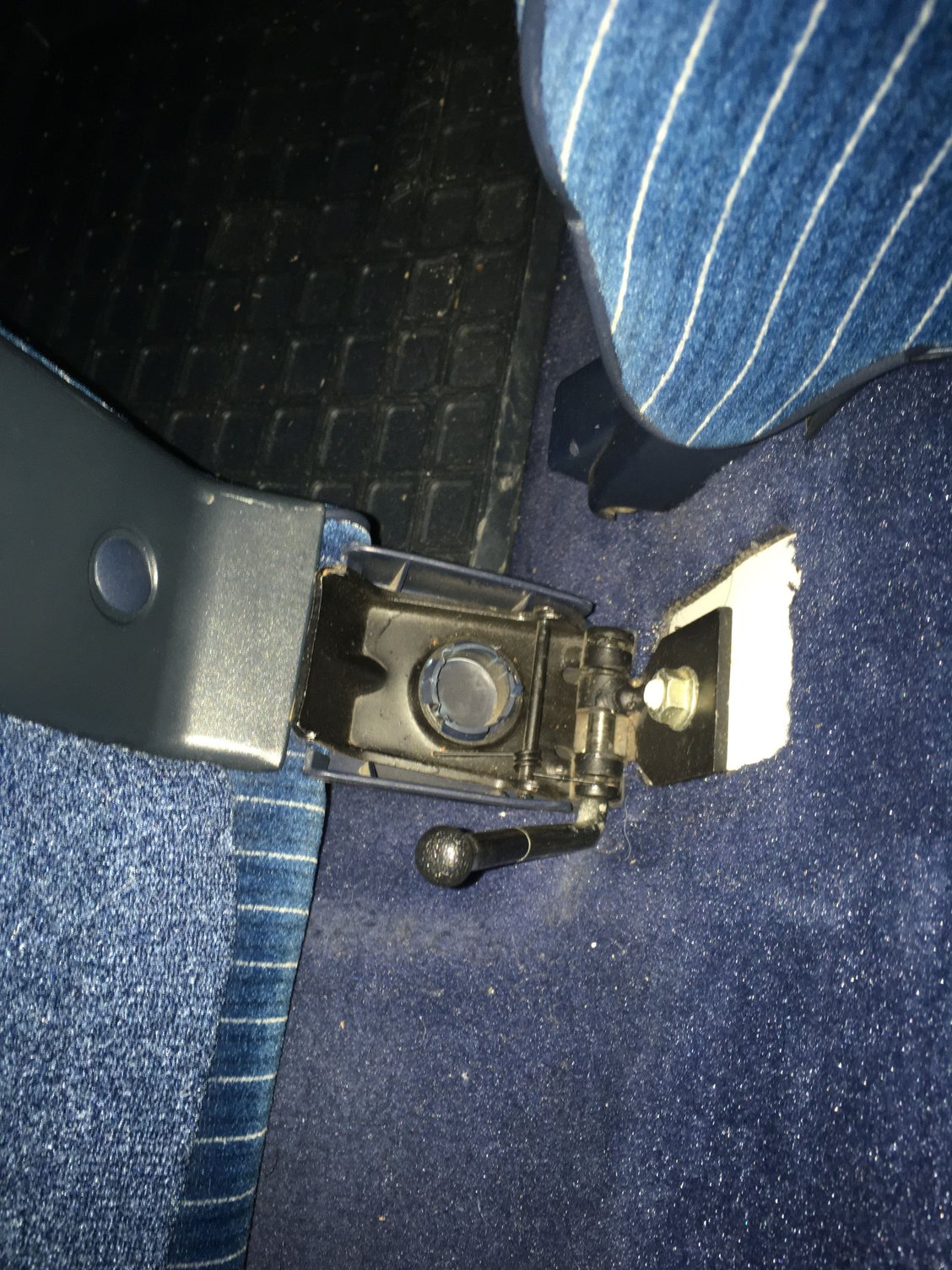

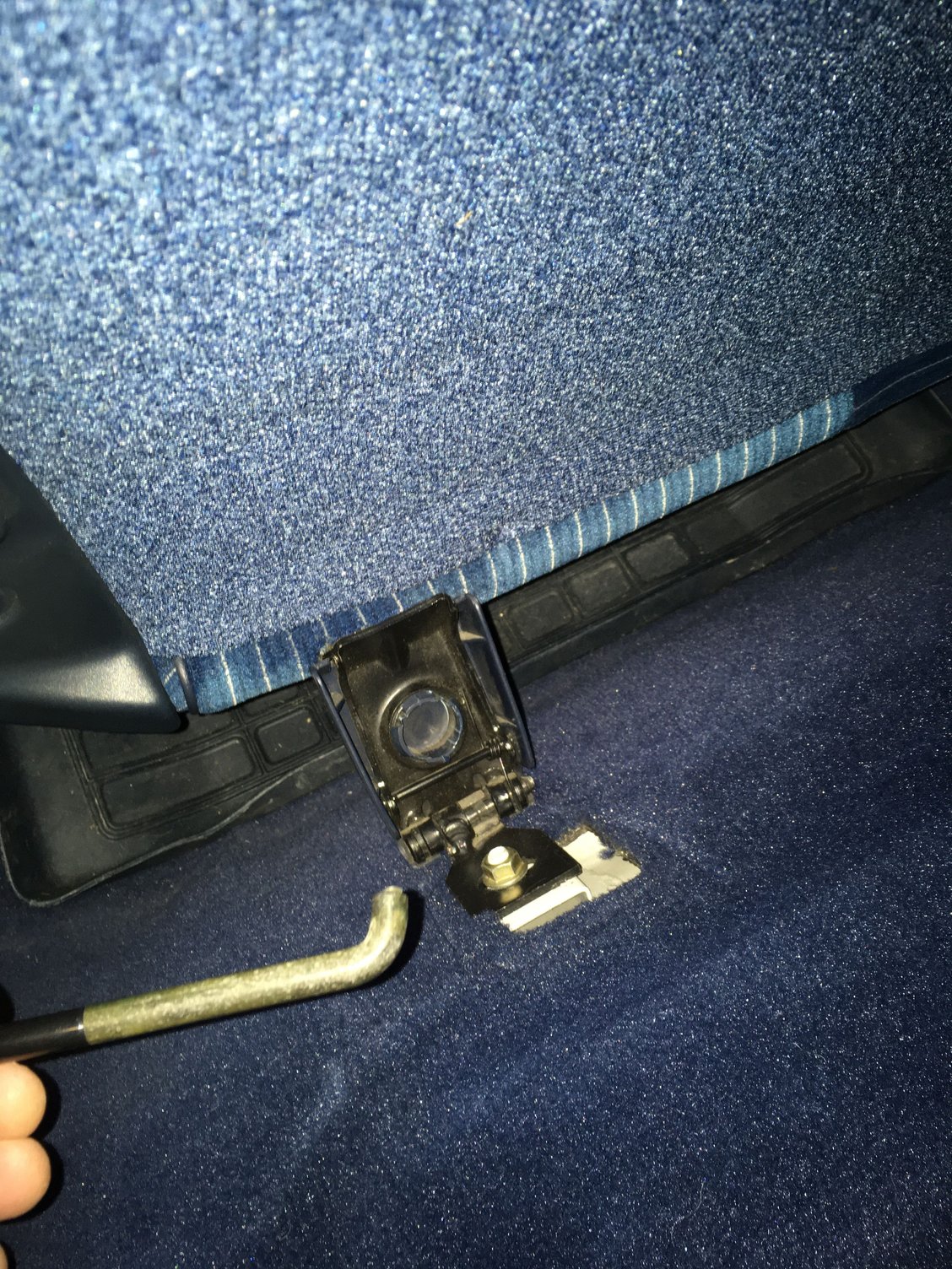

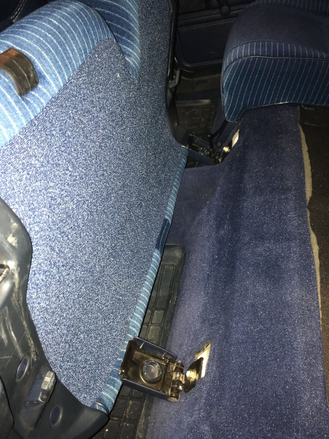

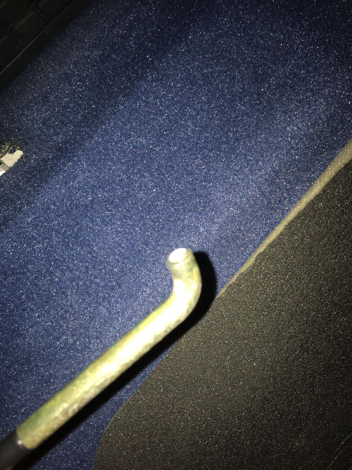

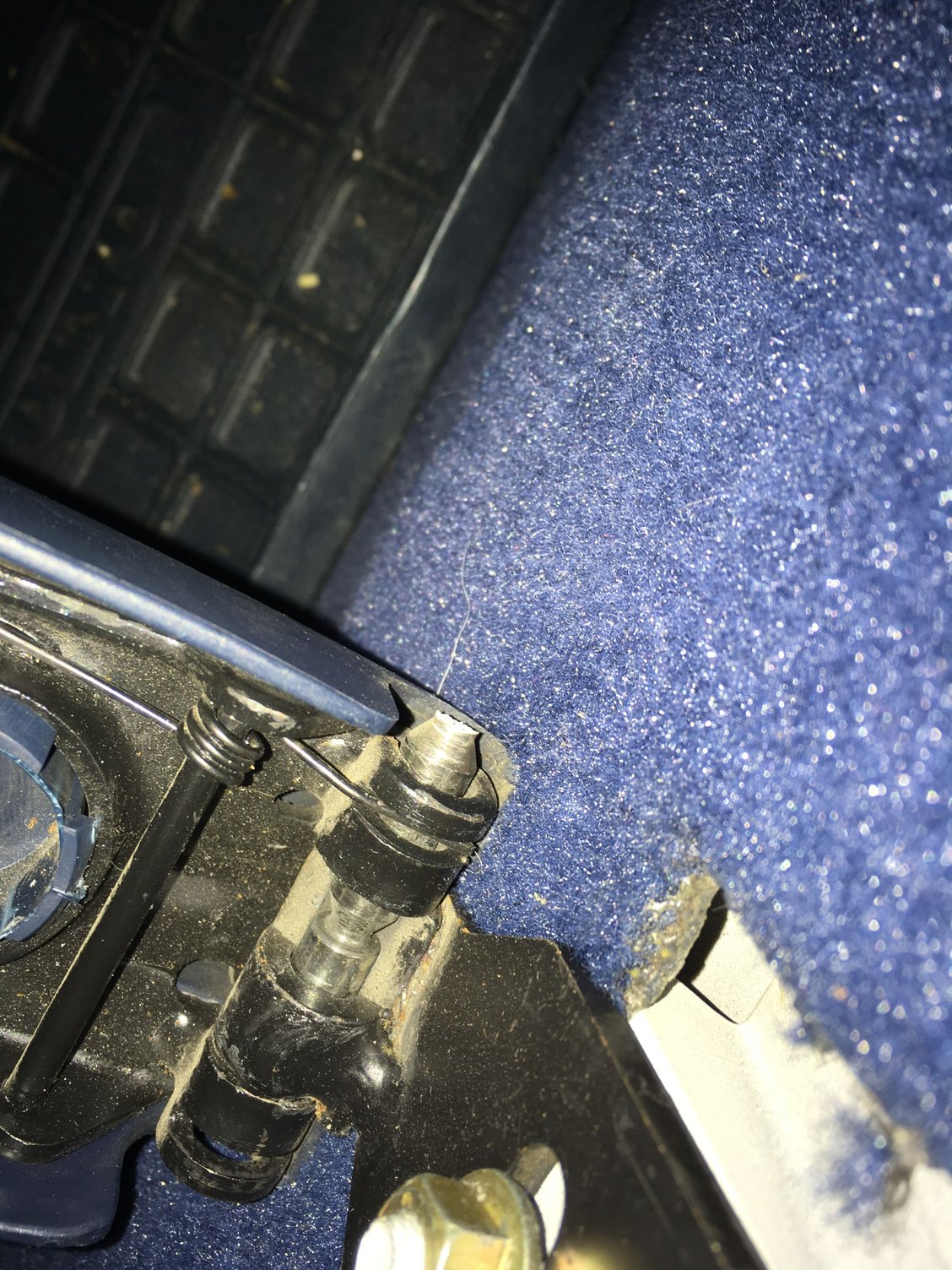

On my 740 there's the possibility to take out the rear seat by manually pulling out the pivot of the hinges through attached handles, thus without using any tool. While putting back the seats the other day, I was sliding in one pivot when unfortunately the attached handle came apart. I wonder if I can find a replacement hinge or pivot, but I don't know what to search for, what would be the name of this part I could look up for? Or perhaps do you think it could be possible to solder the pivot and the handle back together?
I'm attaching pics to better explain the issue.
Thank you very very much in advance, I very much hope I could fix this problem as I love my beautiful 740!!
The broken hinge
The broken pivot
The broken handle
A working hinge
The rear seat
Old Feb 26, 2023 | 07:01 PM
Don't know what year your car is - but you might need a 1365360
