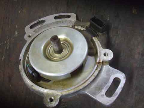

I managed to get the distributor off and it all "looks" ok (here is a pic http://i273.photobucket.com/albums/j...v/DSC01483.jpg ) but I do think the hall sensor is the issue. I'm just trying to get a second hand one at the moment. Not so easy to come by. Hope to get hold of one soon and try it out. Otherwise I'll just have to get a new one.

Yeah, that distributor looks really clean. The sensor can eventually just die with age too.
