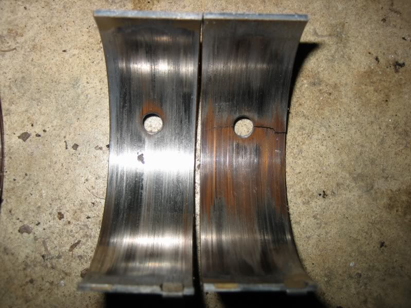

Check the o-rings on the delivery pipe,these can fail and cause low oil pressure.You also need to check for bearing damage(rod and main).If the engine has a lot of miles on it,I would change the rod and main bearings and install a new pump.
Excessively worn bearings in the pic.
[quote=Sofar.;222437]I never understood how worn out bearings could cause low oil pressure.
Excessive bearing clearance.

You'll have both oil pump AND bottom end bearing problems if you have the oil light come on at higher rpms. be prepared to replace all the bearings and oil pump.
bearings that have run dry will have either smeared bearing material onto the crank journals or ground into the journals if the bearing overlay has wiped out. Please post photos of the bearings and we'll say yes/no.
Something else to look for on a redblock is pump O rings blowing out, this is a prime candidate in your case.
Worn bearings cause low oil pressure because the crankshaft doesn't actually run on the bearing surface, the crank journals ride on a wedge of pressurised oil. If the clearance between bearing and crank journal becomes too large, the oil leaks away faster and you lose oil pressure. If the clearance becomes too great, the oil pressure drops too much and you wipe out bearings.
