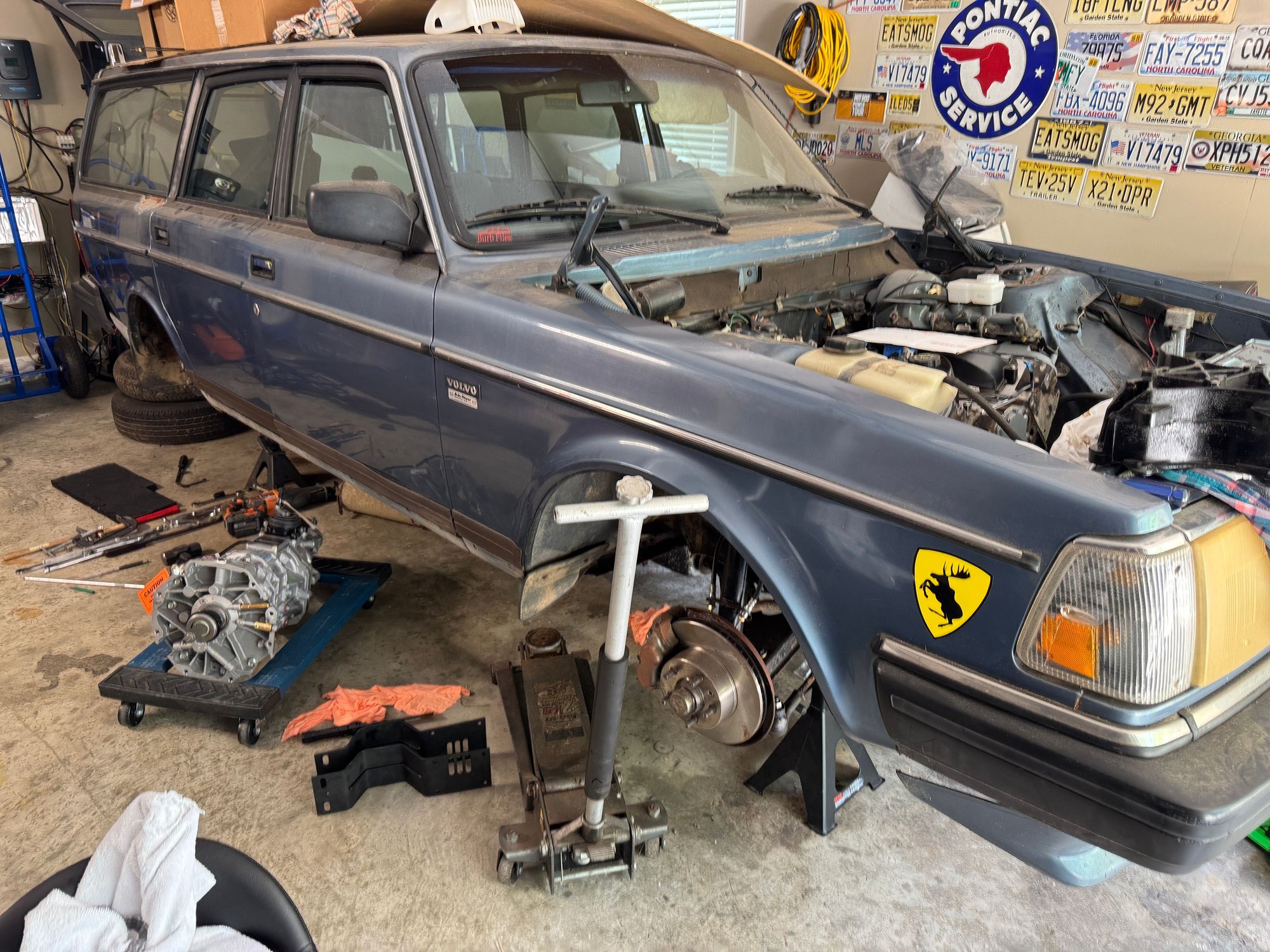

86 DL 245 Wagon LS swap... 1st episode
Old Aug 2, 2020 | 09:27 PM
1967 Tempest's Avatar
Joined: Apr 2019
Posts: 68
From: Fayetteville, GA
Exclamation 86 DL 245 Wagon LS swap... 1st episode
Follow the build here......

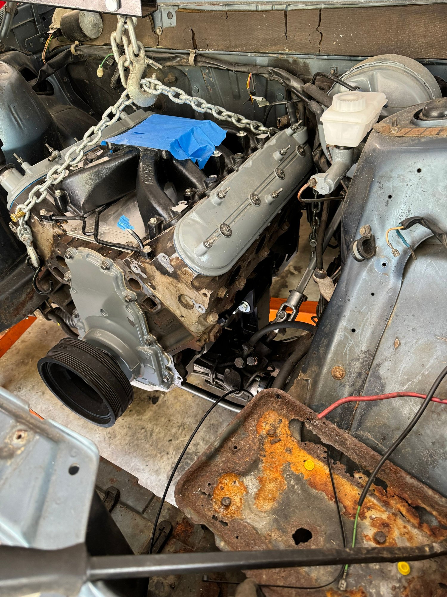

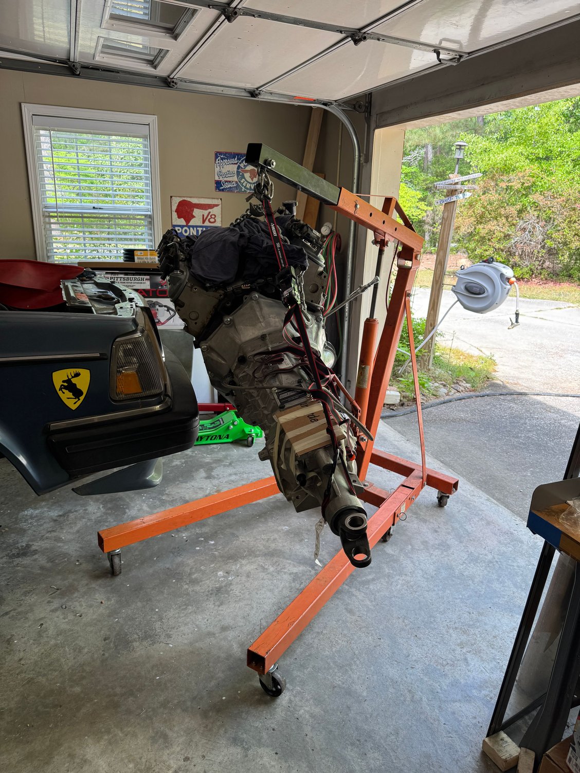

Old Feb 24, 2025 | 08:30 PM
Joined: Apr 2019
Posts: 68

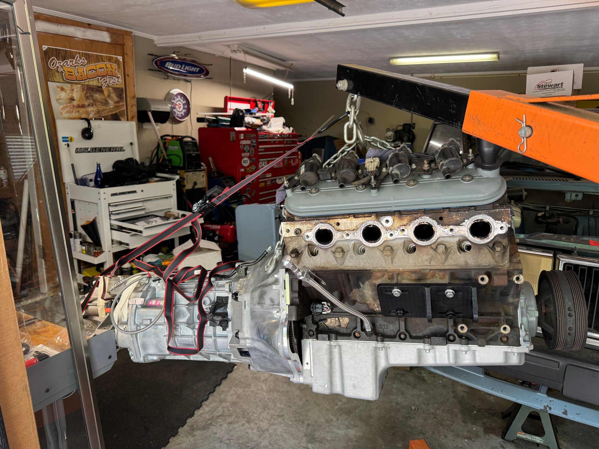

I have the engine in for the first time.. I will add a video when I get some time.

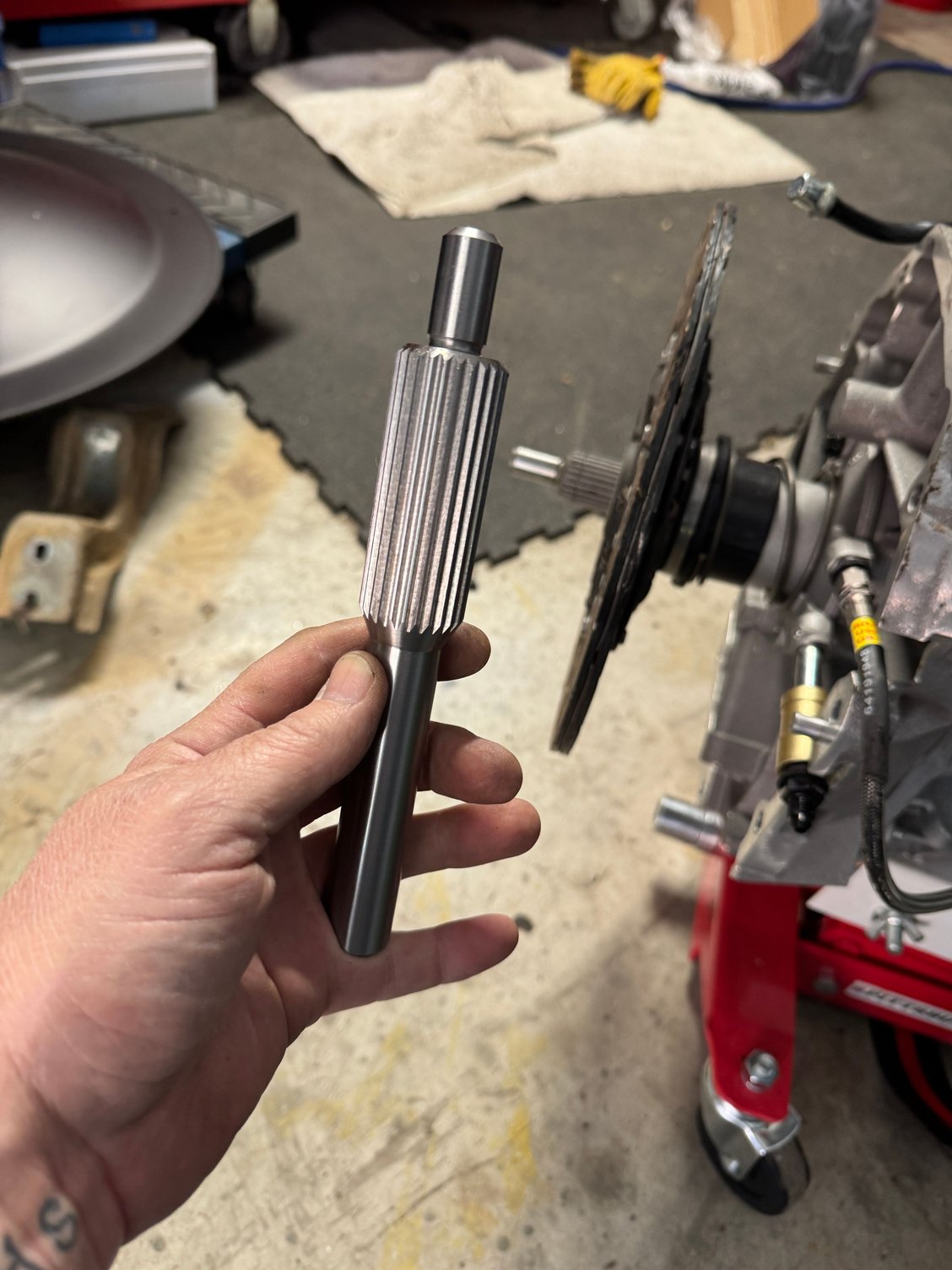

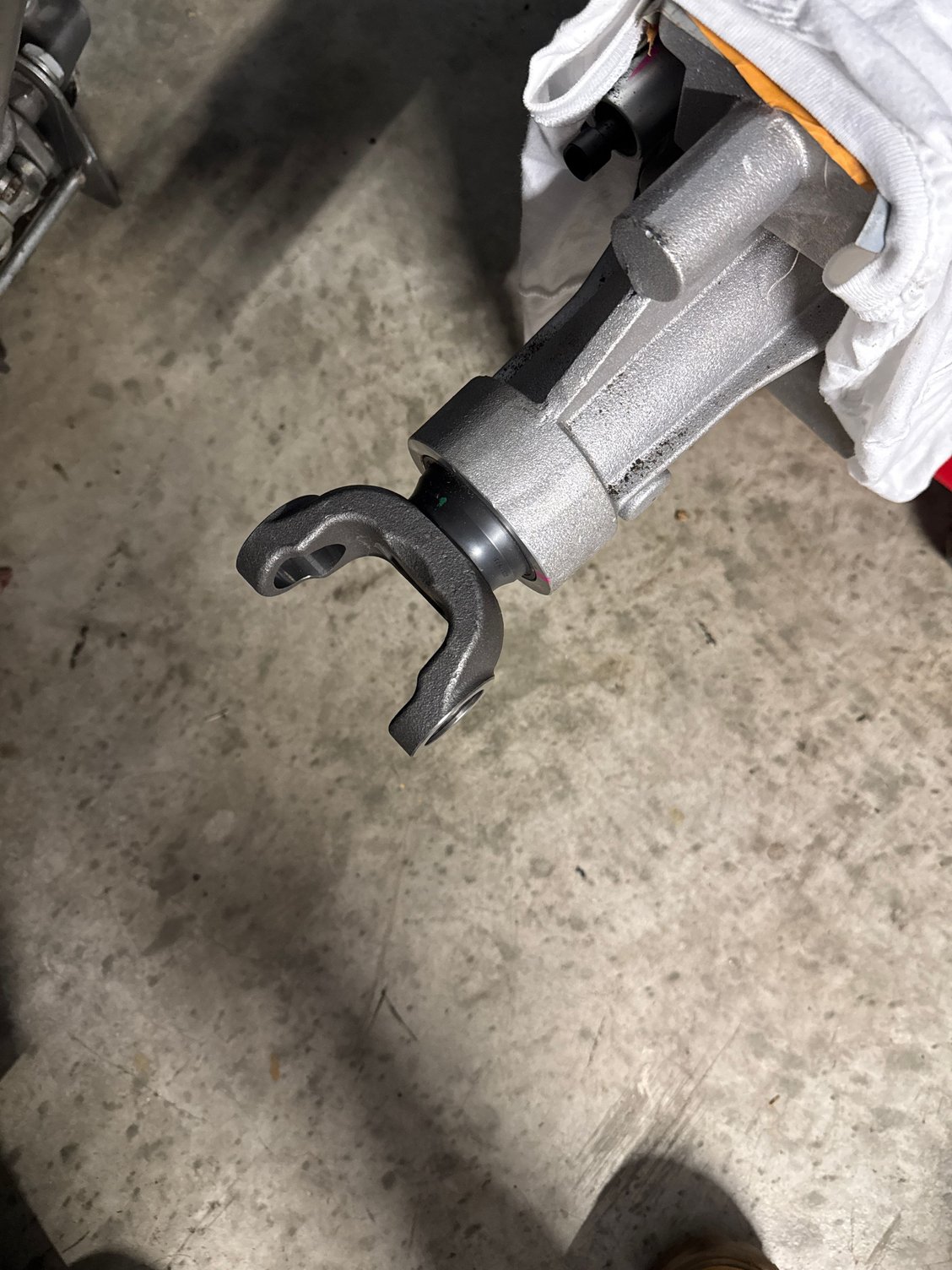

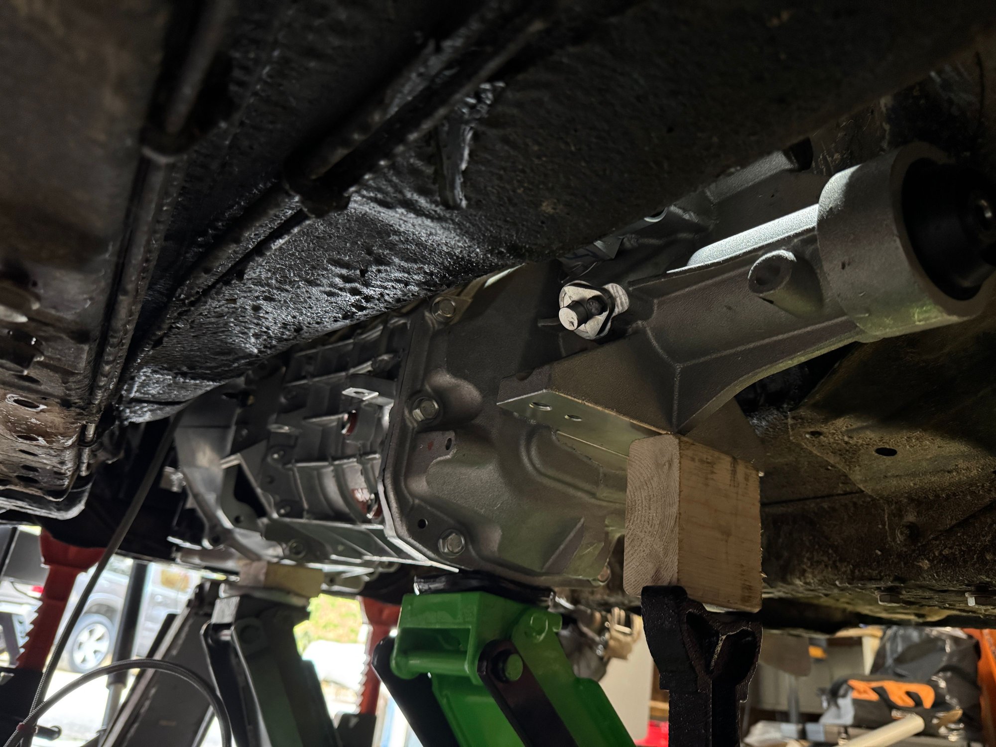

Default Transmission is kicking my BUTT!!!!
Old Apr 3, 2026 | 11:55 AM
Joined: Apr 2019
Posts: 68

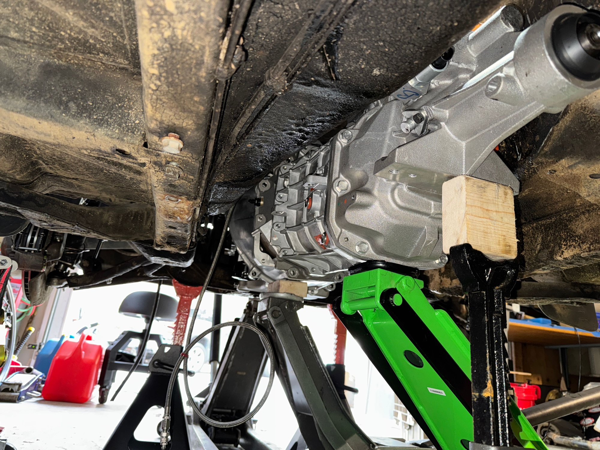

OK, found out that after 3 months of loosing my sanity, that if using a truck LS 5.3, you will need a 3/8" spacer on the bell housing for the trans. It is finally together!!!! More videos and pics top come once the combo is in the car..

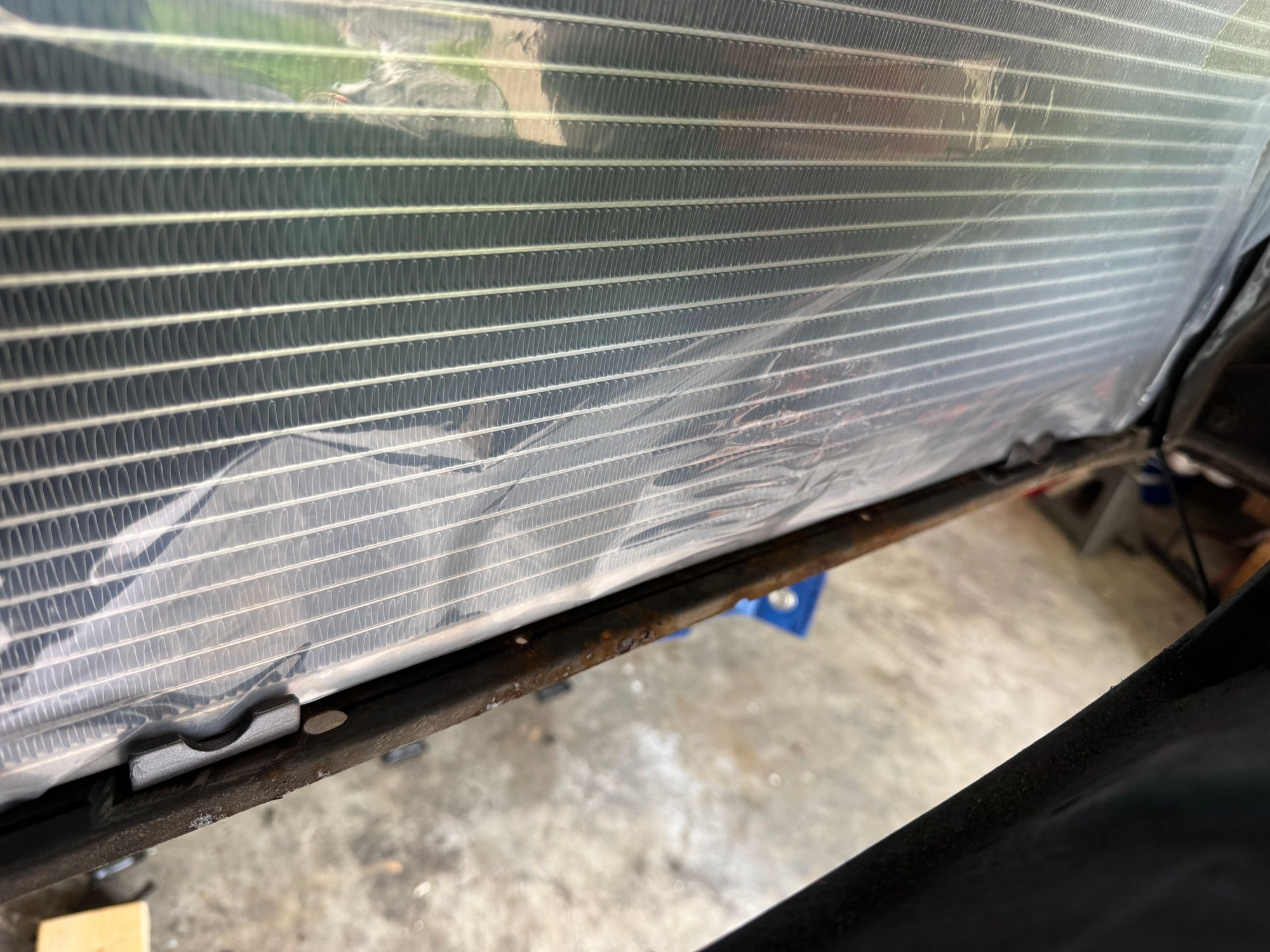

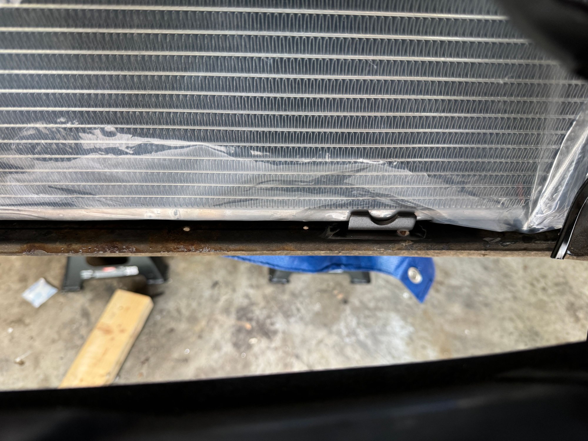

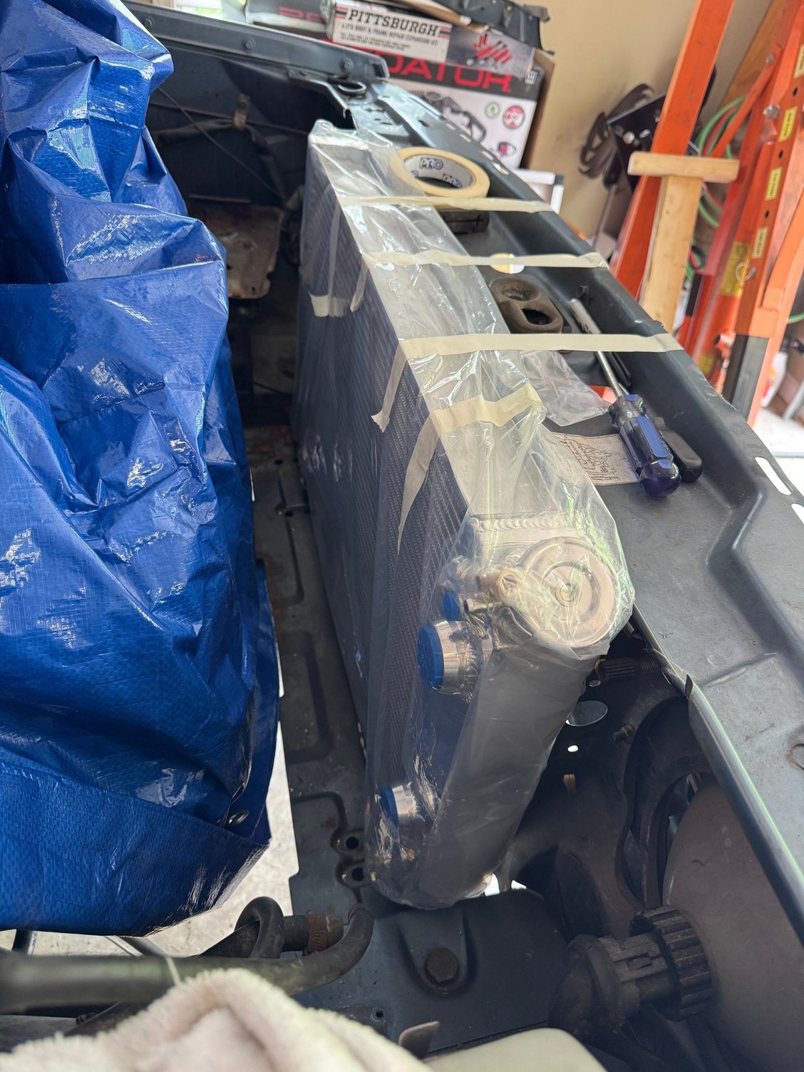

Made some custom lower radiator brackets. Just enough room in them for the fan assembly I hope.
Old May 12, 2026 | 09:05 AM
Joined: Apr 2019
Posts: 68
The radiator is a double pass 1987 Corvette radiator. Fans are for the same car. My goal is to "start" the ar at least make it bark before June 1st.

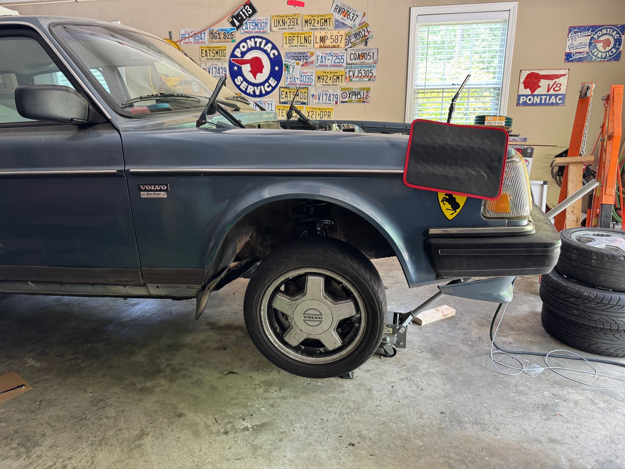

Old May 13, 2026 | 08:29 AM
act1292's Avatar
Joined: Jan 2006
Posts: 1,797
Likes: 52

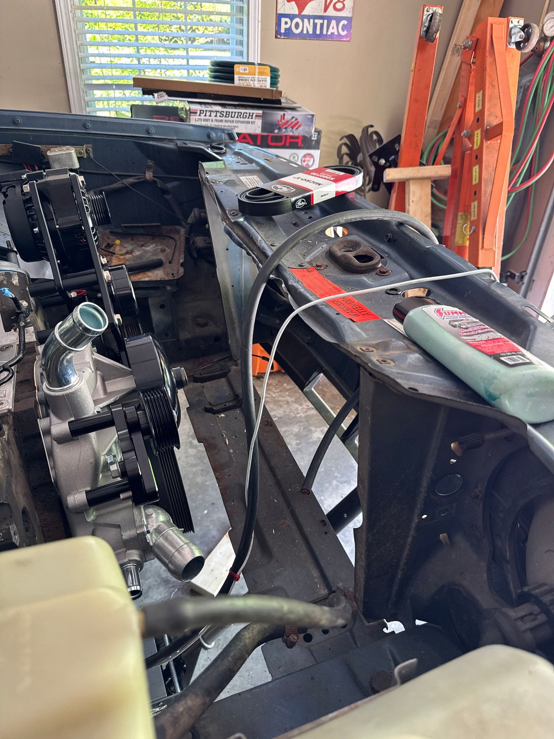

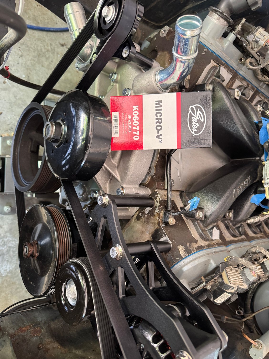

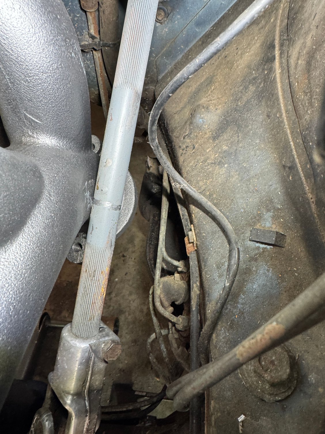

How did you remedy the steering column interference?
Old May 13, 2026 | 03:57 PM
Joined: Apr 2019
Posts: 68
yhat cast manifold is super thick. Ground down the metal till it cleared and repainted it.
Old May 14, 2026 | 08:32 AM
act1292's Avatar
Joined: Jan 2006
Posts: 1,797
Likes: 52
Will it rub when the engine torques the mounts? I would expect you need at least 1/2 inches of clearance to avoid interference under high torque situations.
Old May 14, 2026 | 04:28 PM
Joined: Apr 2019
Posts: 68
that pic is an odd angle but there is about 1/4” clearance. The motor mounts are dang near solid, so I don’t expect much movement. Plus I have other car that you can barely fit a feeler gauge in between. The flex will be more of a up and down rather than side to side. I did use a big breaker bar and flex it that way and it doesn’t touch. That said if it is in the way, I’ll have to get even more creative..

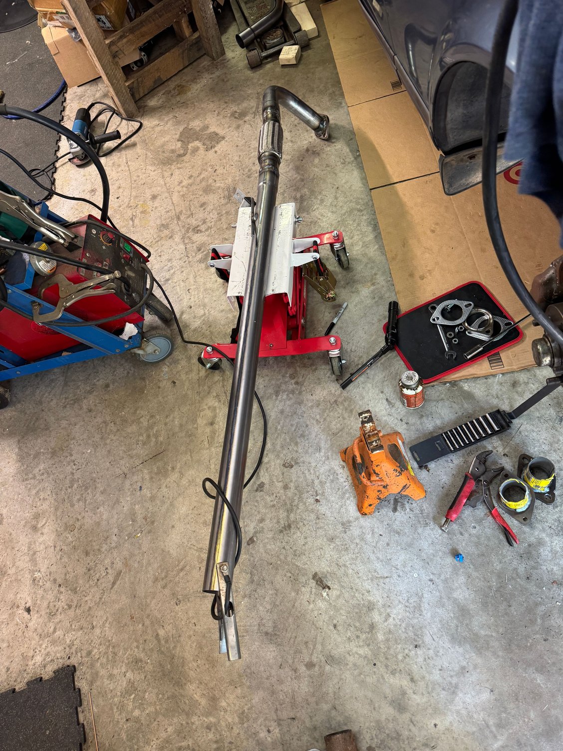

Old May 18, 2026 | 06:29 AM
Joined: Apr 2019
Posts: 68

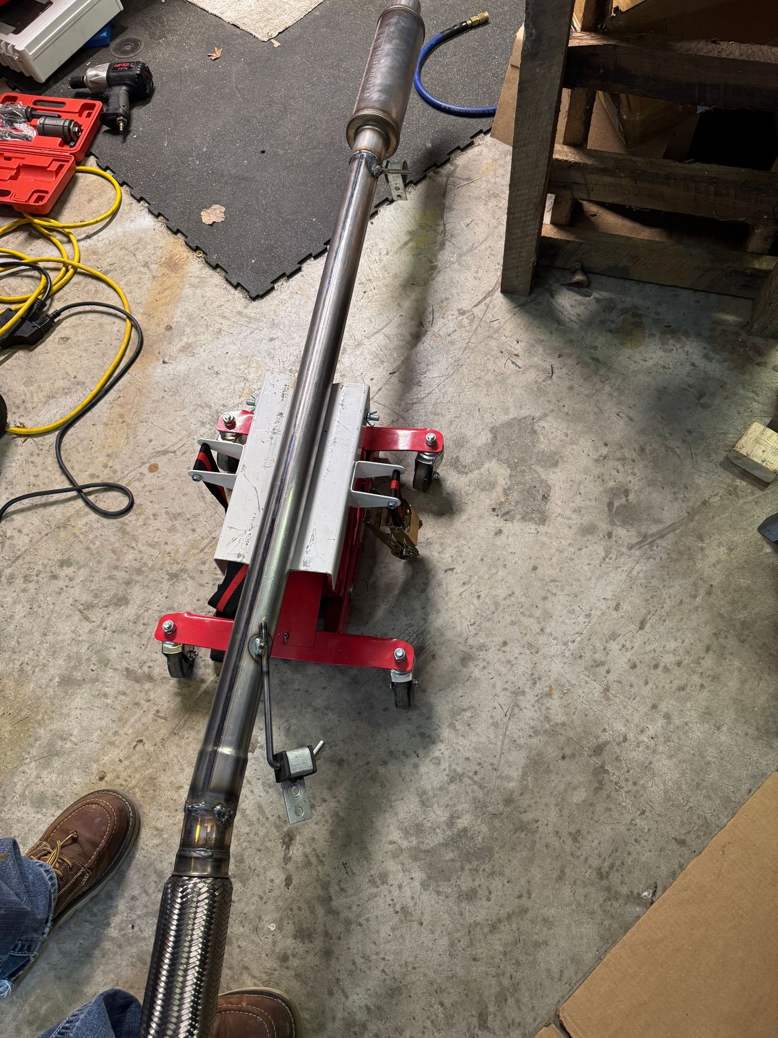

I actually made exhaust hangers!! This is the passenger side.
