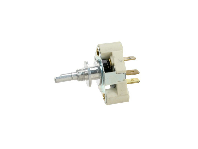

SO: LIGHT SWITCH TO FUSE 15 TO FUSE 16 TO Rheostat? the wire coming out of fuse 16 green? is joined/spliced by a smaller wire that powers "fasten seatbelt light & ashtray lighting. Well
actually I think this other wire is coming out of the Rheostat as well and not out of the wire from fuse 16....this Rheostat is the the hub to your clock, gear position light, Instrument lighting, panel lighting,fasten seatbelt & ashtray lighting.
the harness that goes to your tail lights etc...are shoved through the back door hinges atop and get cut or just corrode away....
I had to cut all of them and splice and re-route them on the inside and kind of tape them as I did not want to re shoot them down the same way...you will need to remove the back door hinges...
as far as the ECU....I'VE NO CLUE
images are not my material but belong to there respective owners/entity...I DO NOT OWN THESE IMAGES
Attached Thumbnails 88 245, Short in ECU normal?-rheostat1.jpeg   88 245, Short in ECU normal?-rheostatipd.jpg

great! thanks for the rheostat tip...i had taken it off along with the rest of the dash and forgot about it...now i have power after reconnecting.
