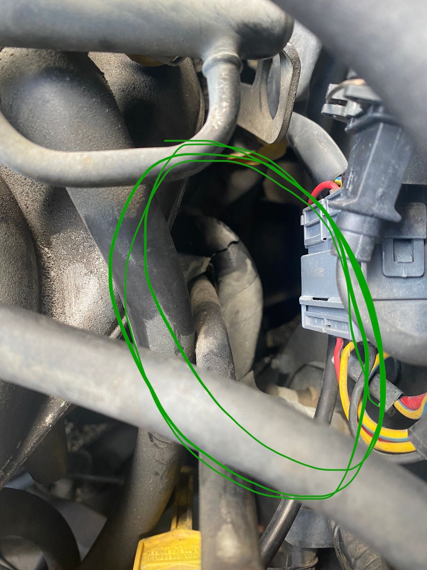

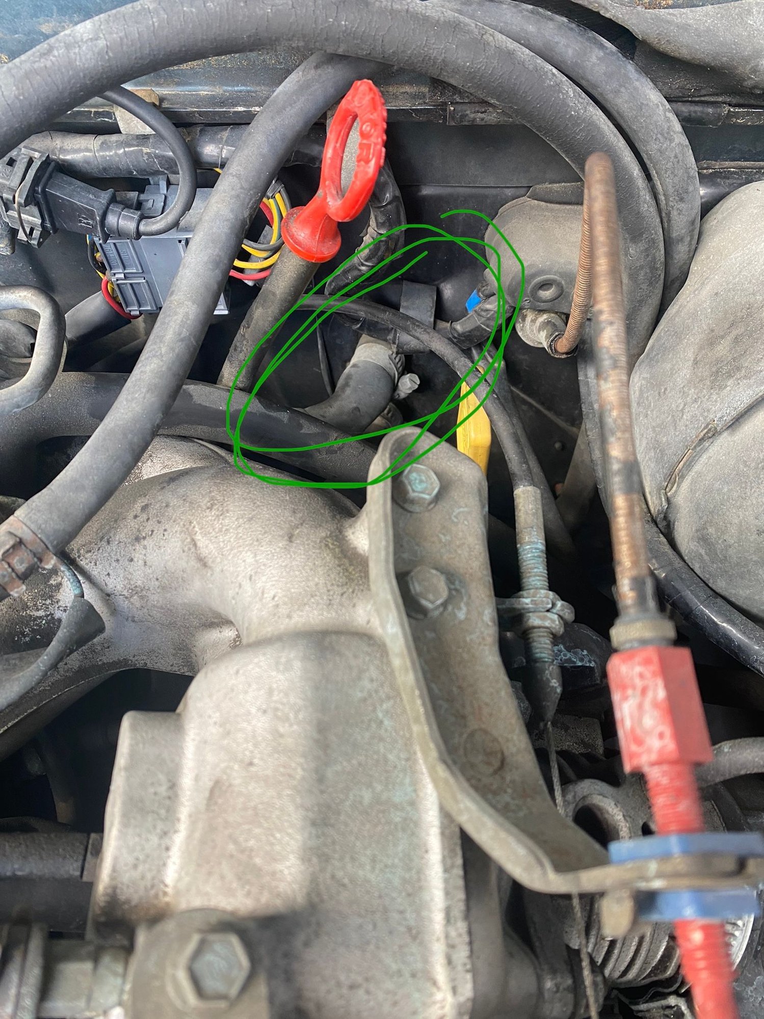

I can’t seem to find the name of this hose that has busted right behind my engine. It has leaked all my coolant or most, idk. It’s connected to or through the firewall and along side the left of my engine block. Please if anyone can help so I can get the hose and get my car Running again. Thank so much!!!

If its going into the firewall, I would assume either the feed or return hose to heater core.

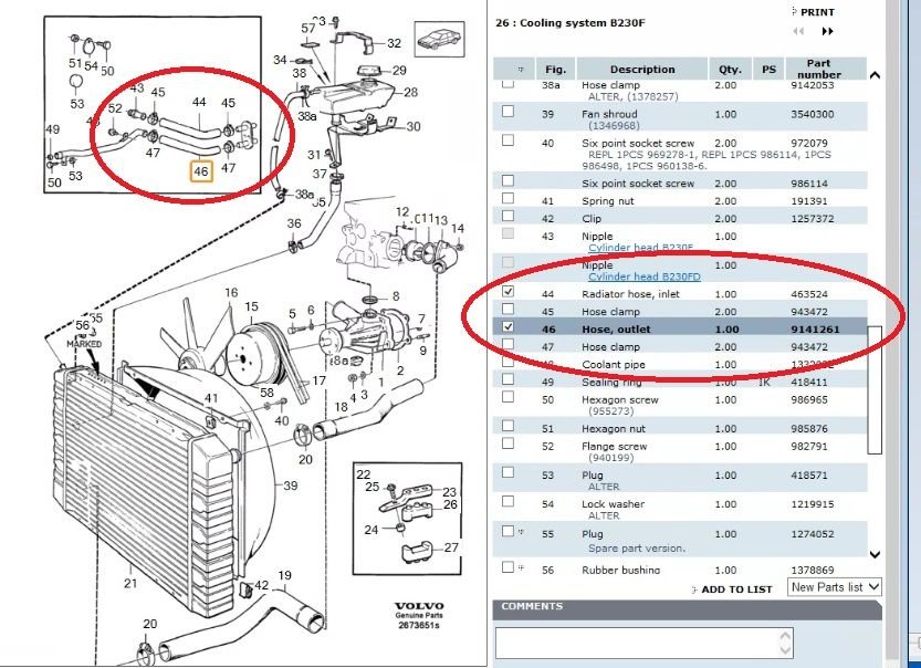

Here's the parts page - replace both heater hoses while you are there

Thank you both for responding I’ve found the right parts and have them on the way
