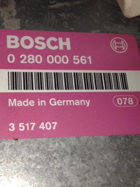

I first went with the Volvo mechanic advice and replaced the ECU. I looked under the passenger side panel and found the Pink ECU 0280000561 which I understand has common issues. I found an ECU online for $45 with same number but a white label and plugged it in.
Smell of the rich gas scent is gone. Check engine light is no longer on. It has been almost a week of driving and no issues. Driving the car is feels so different and drives amazing. Idle remains a little low like 650 but other than that I'm very happy. Vehicle has gone from 8mpg to 17mpg (City with very short distance driving).

ahhh. that suggests the cold start valve control output of the ICU was stuck 'on' (grounded)... which yeah, would dump too much gas in all the time.
