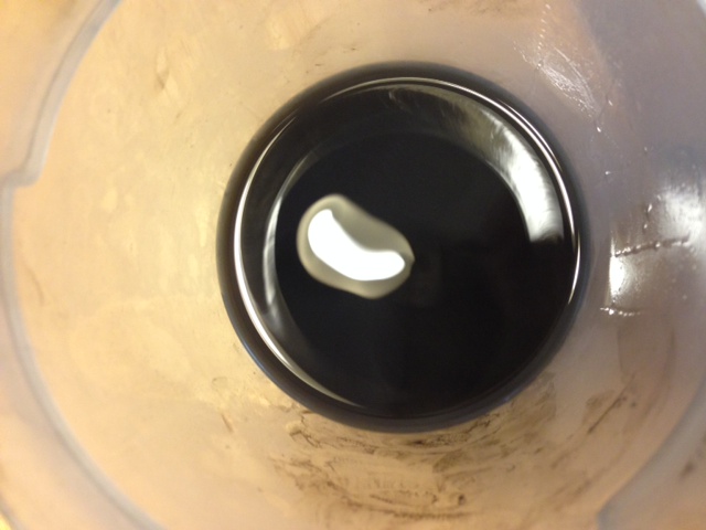

Replaced the fuel filter without too much trouble. Had to use an impact wrench to remove the end nuts. The fuel that came out of the filter was just about dark as old motor oil.

Attached Thumbnails 90 240 run out of gas and now will not start-fuel-filter.jpg

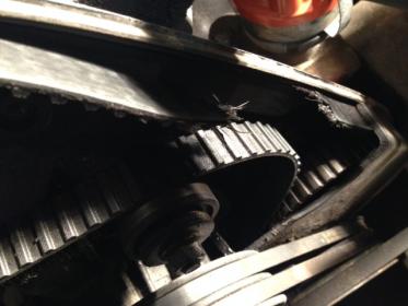

Well I believe that I may have found the problem. I'm hoping that I don't have other damage but take a look at this timing belt. Time to look for posts on this subject now.
Thanks to everyone. fochs looks like you called this one.

Yes your sure did find it....I doubt you did any other damage though ...this is not an interference engine , so that means your good to go one you get that timing belt back on.

The 240 is running once again! It was the timing belt. As a novice DIY I would recommend doing this job yourself. As long as you take your time and go step by step its not too challenging. Thanks for all the feedback!
