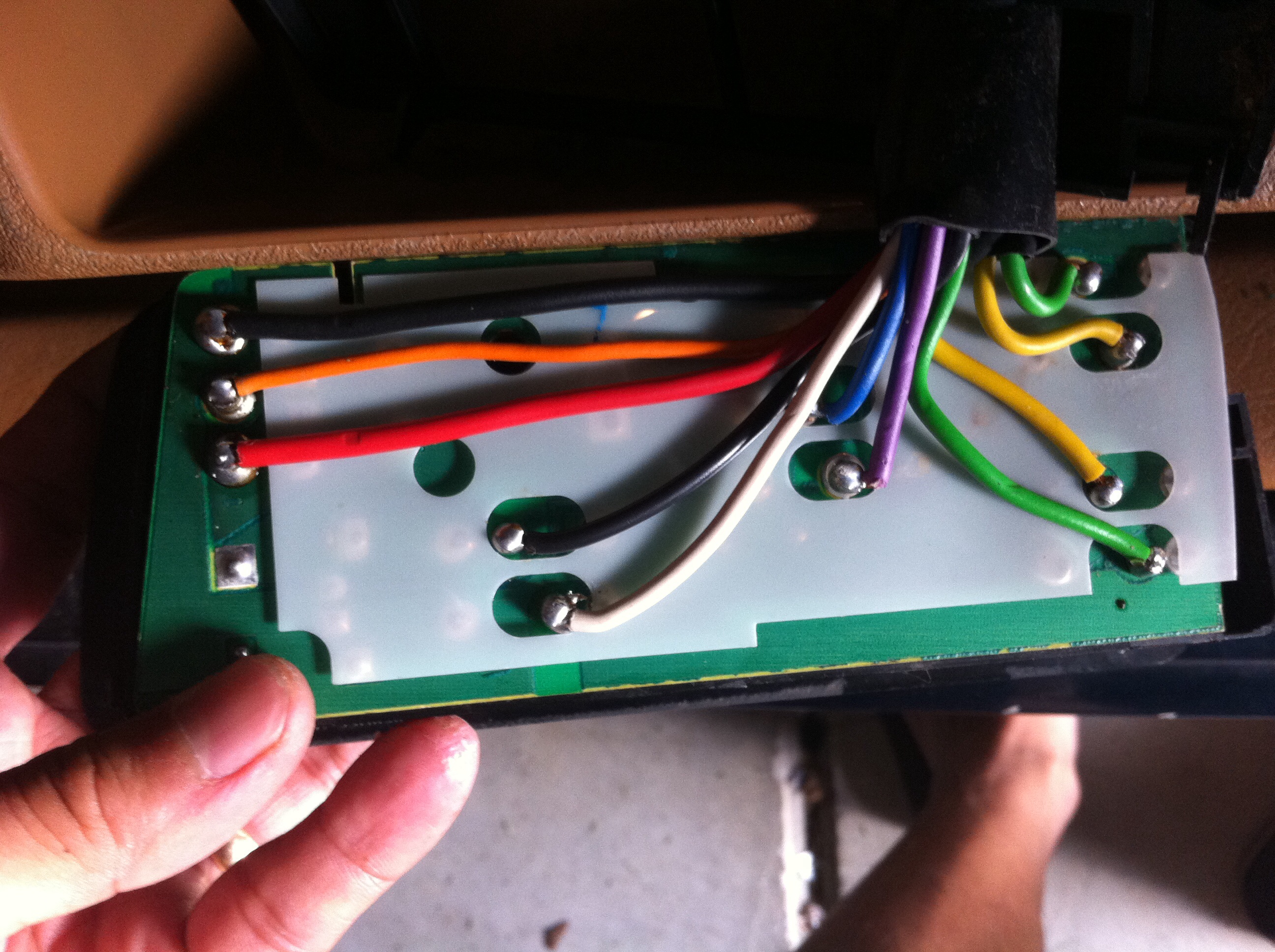

I did better. first, I found a wiring diagram for the non-memory seats. ok, orange is 'control' power for the stop button, red is 'real' power for the motors, black is ground, and the various other wires go to the motors. inside hte switch module there's a relay that the stop button activates, this relay provides power to the other switches to actually power the motors. per extensive prodding with a volt meter it was evident that this relay wasn't working....
so I figured out where the other side of this relay had to be on one of the switches and ran a wire from the red to said terminal... voila, now motors all work, but no stop button. since not a single other brand of car I've ever seen has a stop button on their power seats, I figure thats tolerable.

I just found this thread and I think this could also be my problem. How did you open up the control unit? I've been tryin to get to that module for the STOP button but I can't open the control unit. Any tips?

You think cutting the orange power wire to STOP button would make it work?
Old Sep 2, 2015 | 04:33 PM
no, the important one was the red wire I jumped to the output side of the relay (which I figured out by studying the traces on the bottom of the PCBA and comparing it with the wiring diagrams). the wire jumper you use has to be thick enough gauge to handle all the motor power (eg, as thick as the original red wire).

Do you remember where to jumper it from the attached photo.

nope, sure don't remember, but its somewhere under that milky-white insulator sheet, which I sliced up to remove.

I figured it out. Place the jumper wire from red to the solder spot I'm pointing at. Now the power seat is working again.
