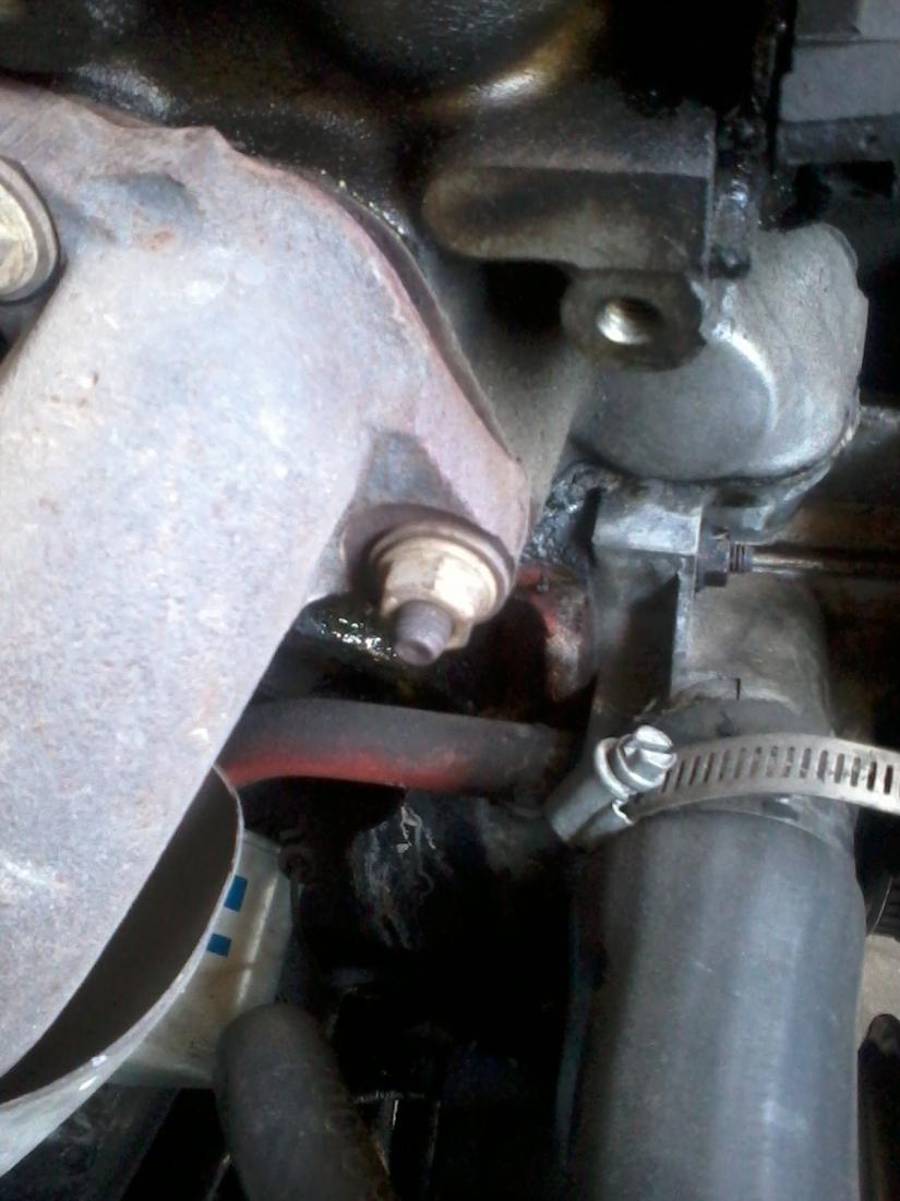

My motor is leakin anti freeze from some where, I dont know if its the water pump, a hose, a freeze plug, head gasket. It only leaks when the car is cooling over night. Plz help

Pix not too clear, but the seal between water pump and head has been leaking and has been gooped up with some sealant which is most likely your problem. The pump has to come off and be resealed installing a new gasket between the head and the pump.
Another possibility would be a head gasket leak around the same spot but not very likely...
Do the pump reseal!
