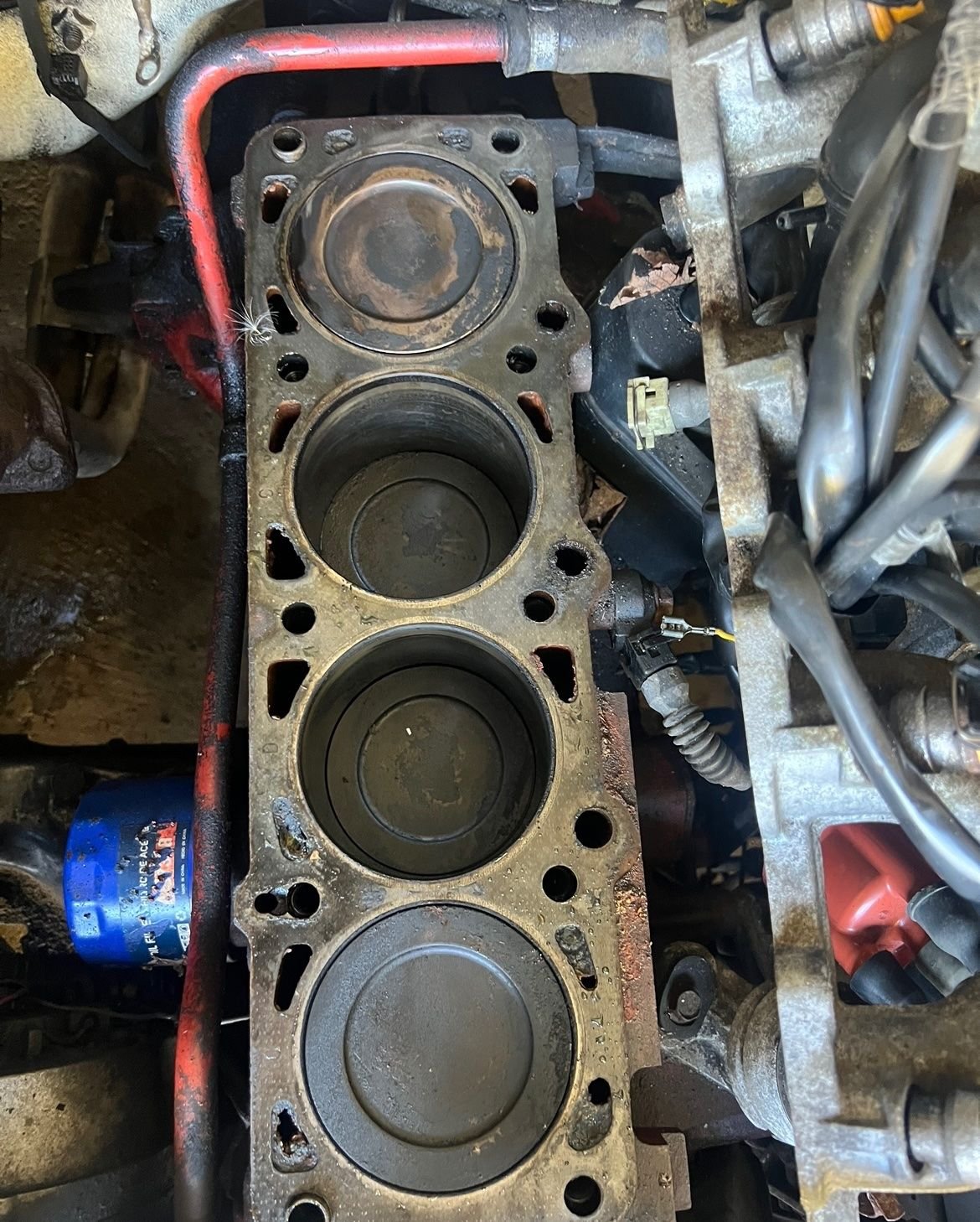

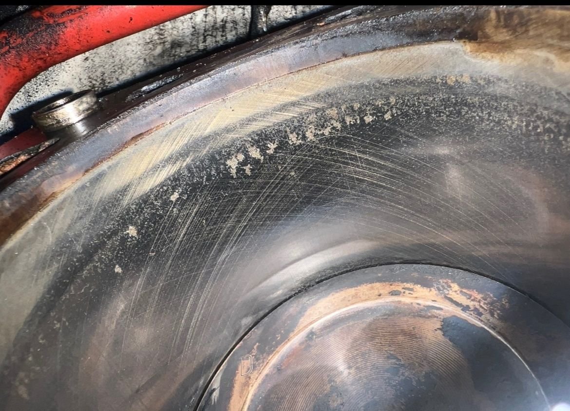

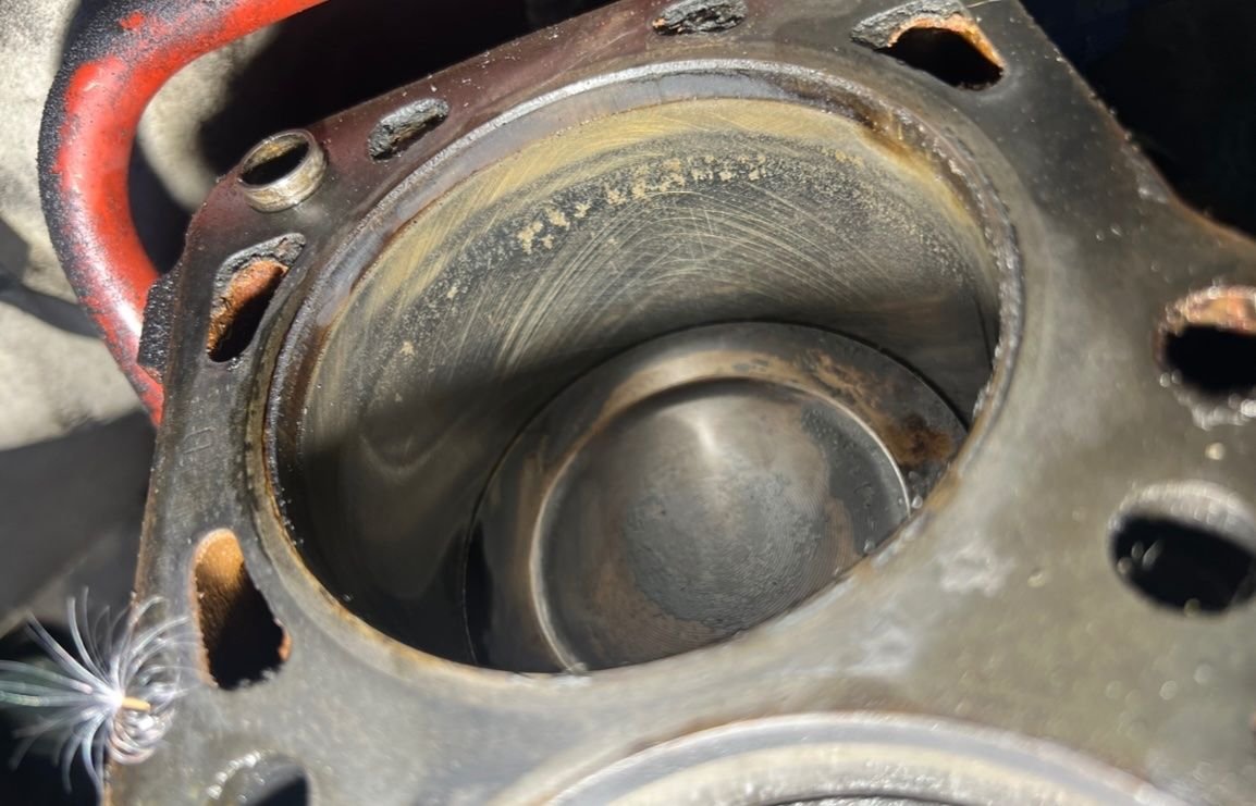

I pulled the head, and the pistons didn’t look horrible. The valve were covered in carbon, but I didn’t think a big deal of it. The back piston looks like it may have got hot, but that was the one where the injector was stuck so it washed a lot of the carbon. (Pictures will be added). The walls didn’t look bad either.

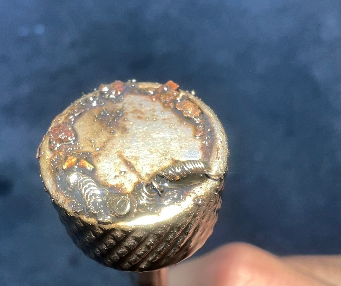

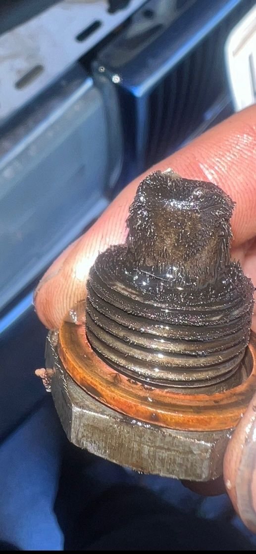

Now, I figured “okay, I’ll just do a valve job and be good to go”. I decided to drain the oil and check just to make sure and found tons of metal flakes and these unknown springs.
(Image attached)
I’ve read that these could be the oil pump relief valve spring but I’m not fully sure. It’s clearly too small to be a valve spring or anything. I’m really lost as to what happened here. The 240 ran very well and then just seemed to grenade. Would the oil pressure relief valve giving out cause these valves to stick and lead to this whole compression loss disaster?

edit- its also clear that there was tons of stop leak in this engine. The coolant jackets are clearly plugged, and when I took the head bolts off, there were flakes of metal. It didn't look like it took the threads out of the head to me; it looked like that metal material some stop leak stuff causes.
