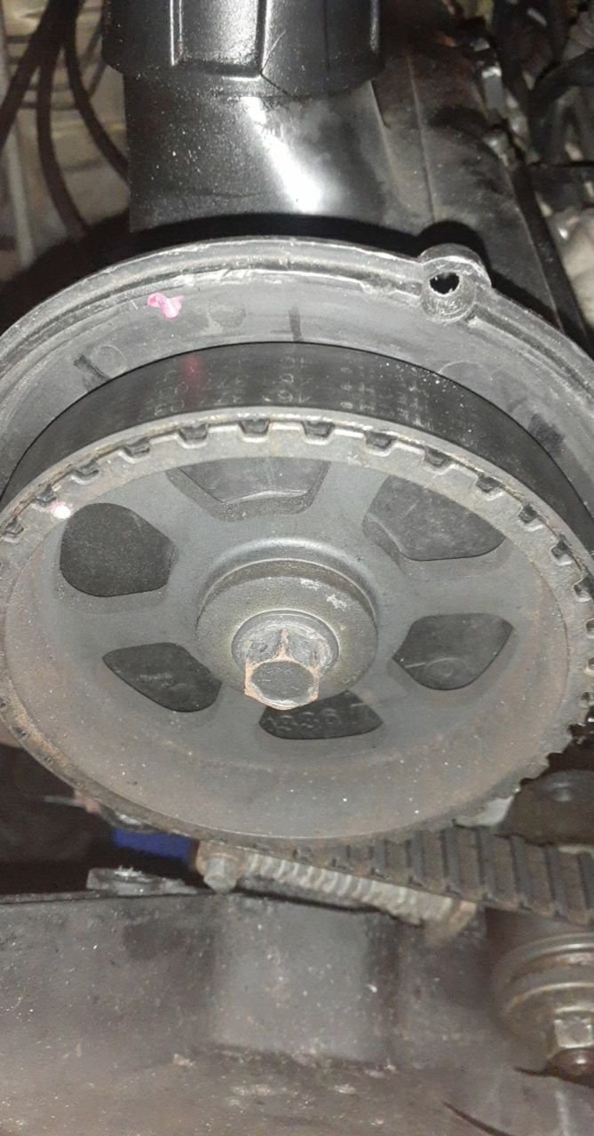

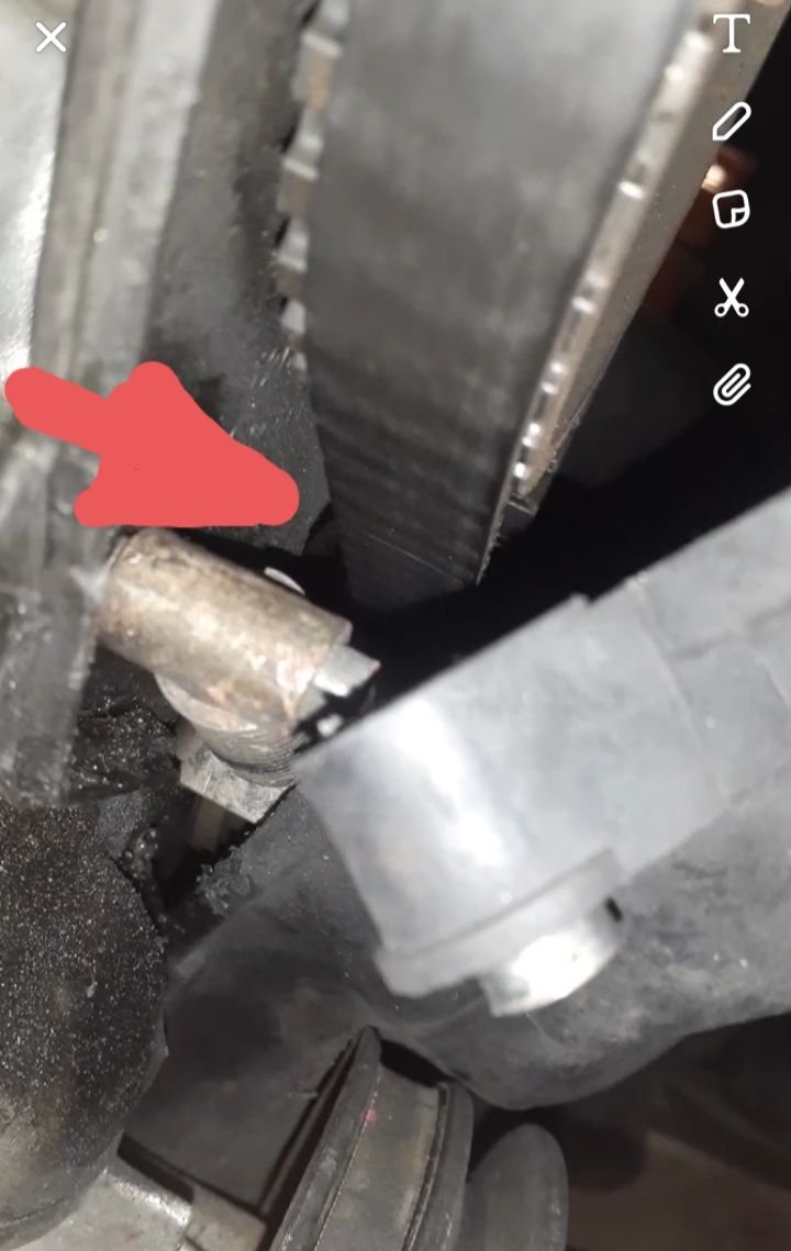

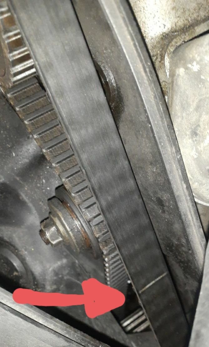

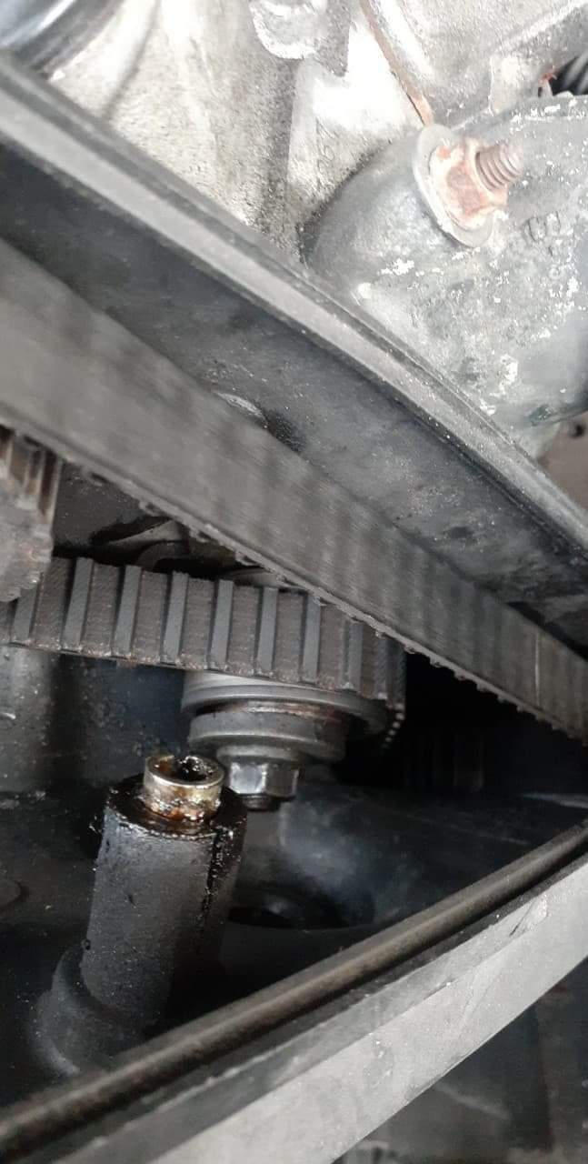

Timing belt tensioner failed
Feeling pretty dumb! At least I found the culprit... will get it back on the road this week lol...

How did it fail? The picture doesn't show a problem as far as I can see.

I'm not sure what happened but timing is definitely off

What makes you think you have a timing problem? Things don't look too bad in the pix.
That white mark you point to doesn't mean anything.

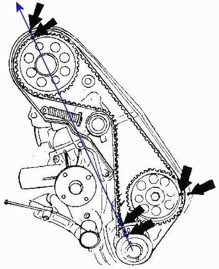

I can't see the TDC mark on the crank shaft there at all. the TDC mark on the camshaft is off by 3 teeth but that doesn't mean anything unless the crank TDC is spot on. and yeah, those white lines mean nothing. the intermedia shaft doesn't matter if you have a camshaft distributor, but it DOES matter if you have a side distributor (740's occasionally came with a side distributor). the accessory v-belts don't matter at all.
