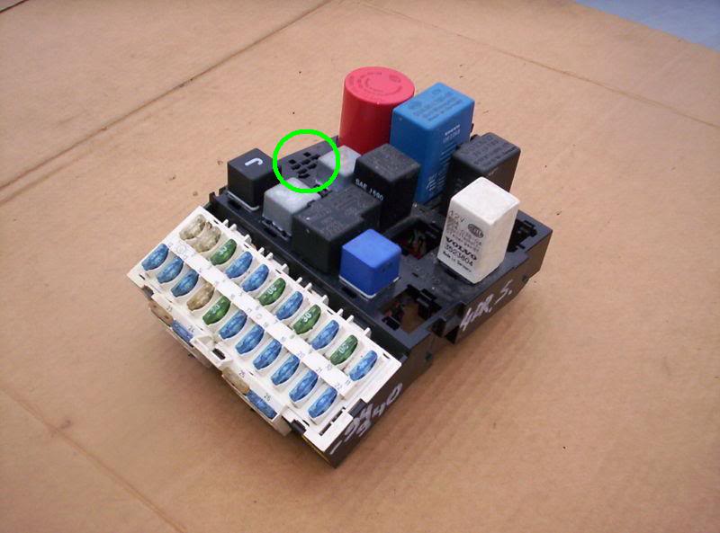

At first read I though it may have been the "fuel pump relay". But, her car does not seem to have one. From what I read, it should be in front of the "J" relay right behind the "circular" thing. Although there are holes there, there nothing in the holes for a realy to "plug" into.
I replaced the Blue relay (fuel injection?)

This however, did nothing. Next step was to clean the MAF. This also did nothing. So the check engine light is on. I figured i'd try the Diagnostic "Box" infront of the drivers-side shock tower. The "A" box checked out fine (FLASH 1-1-1) in all sockets. The "B" box was fine too. Except for the "2" socket that flashes 1-2-2. From what I read, I believe this is the "cruise control" socket. The car does not have cruise, so I'm guessing that's why it would lead me to believe there was a problem.
I'm quickly running out of hope. Any information would be greatly appreciated.
