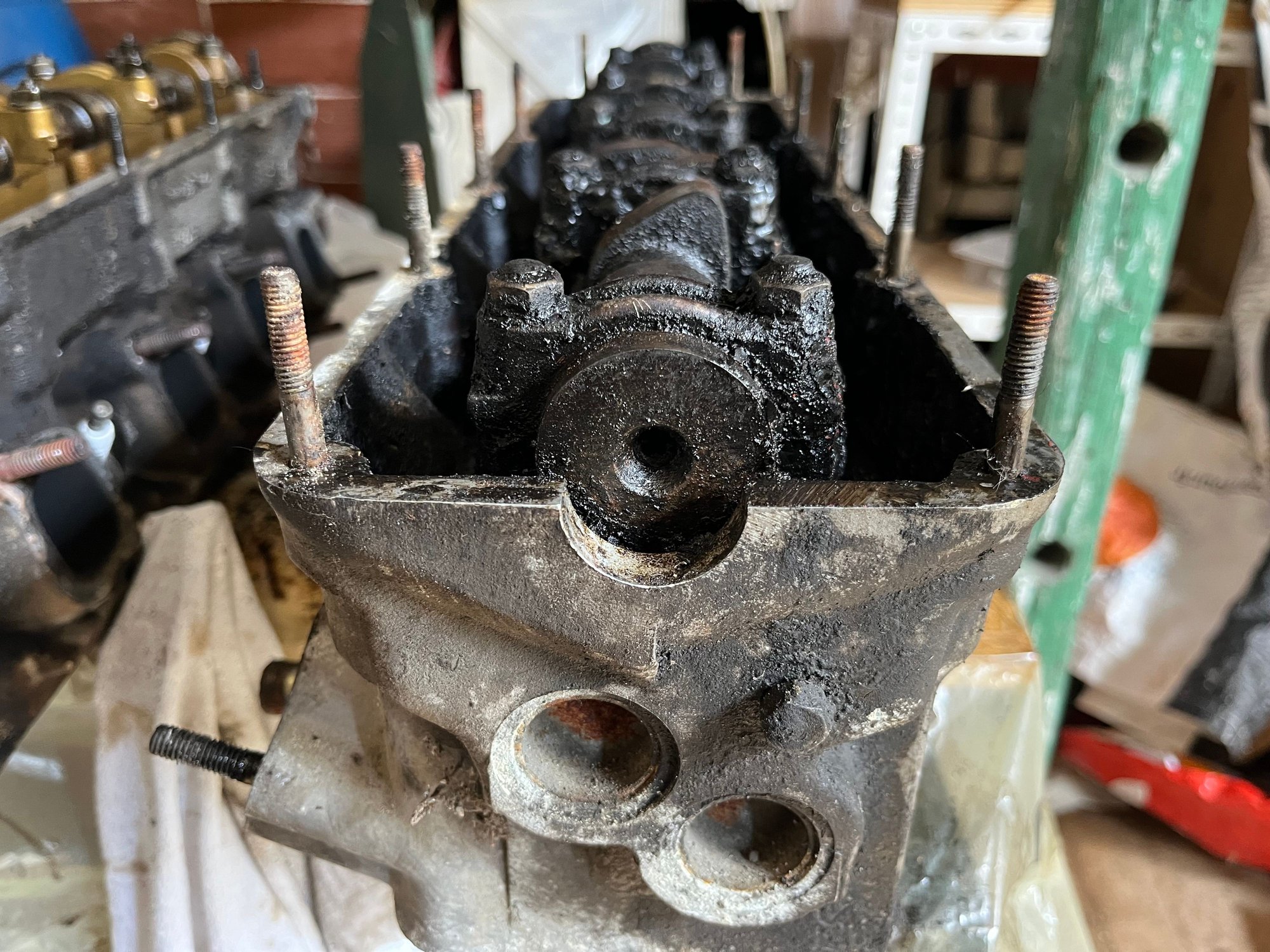

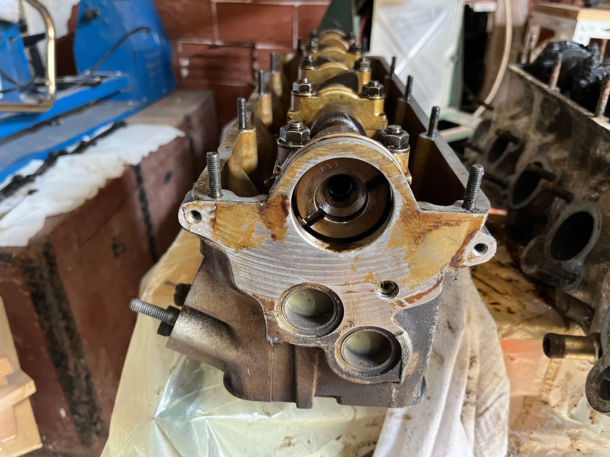

here are some pictures : the 240 cylinder head on the first pic, my 940 head on the second.
Old Aug 31, 2024 | 08:56 AM
The 240 head pictured is from a B21 engine. 2.1 liters. Used from ~1976-1985. I would not count on it being compatible. (there's certainly no way to mount your existing distributor )
Technically you could mount the 240 distributor on your 940 block, the drive gear is under that cap on your block.
The gasket set you would purchase would be based on the engine - b21, b23 or b230. If you are Mixing a head from a b21 onto a b230 - don't know if hole spacing/valve sizes/ etc is the same or what you would need! The valve cover gaskets are certainly different between a b21 and a 23-230.
It would be best to find an automotive machine shop that can repair your head. (the B21 head probably needs a valve job anyway if you were to try to use it)
