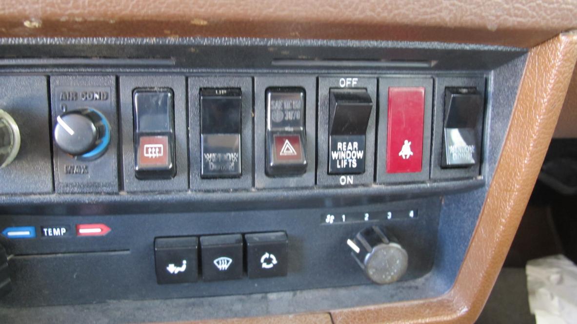

Here is the front window switches, now that i have been up in the dash a little, its obviously an aftermarket job.. but i also found the plugs for the rear, both work, and mothership Volvo claims to still have some of these switches. I will see tomorrow.

What do you guys think of the window switch situation? pretty interesting dash hua? Im trying to figure out the best place to mount the switch for the rears. they were originally in an authentic volvo black switch box on top of the center console, don't think that spot will work any longer as i found an almost matching in color armrest...
