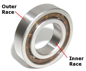

Volvo doesn't use bearing races in the head,nor anyone else that I can remember. (see pics for correct use of bearing races)

Race- The inner or outer ring that provides a contact surface in a bearing.

I never said there weren't cam bearings or bearing shells.I said there are no bearing races,big difference.Quote=TURBO245: Volvo doesn't use bearing races in the head,nor anyone else that I can remember.End=Quote A lot of engines use cam bearing's and inserts,but...not bearing races.
I agree with the definition of bearing race,spot on.If you'll look at the 2nd pic I posted,it shows the inner and outer race with ball bearings in between,just like the dictionary says.Weird...no not really.
