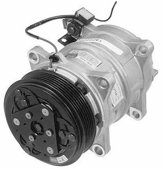

could be as simple as a radio frequency noise filter. can you take a picture and post?

does it look like this?
Attached Thumbnails a/c trouble again-volvo-ac-compressor9171345.jpg

thanks jp, that sure does look like it. What is that little square off the back that the wire goes through? Is it a strain relief, or some kind of sensor? I don't have alot of experience with volvo electronics so I'm a little afraid of taking out another component that I will have to replace before the Texas heat comes back.(79 degrees today , the second week of November)

As the magnetic clutch cycles on and off it creates an electronic pulse (emp) the emp radiates in an rfi (radio frequency index) that can effect the quality of life in the am (amplitude modulation)radio band and slightly in the FM (frequency modulation) band ergo the little square thingy is most likely a solid state choke coil (radio Filter)
