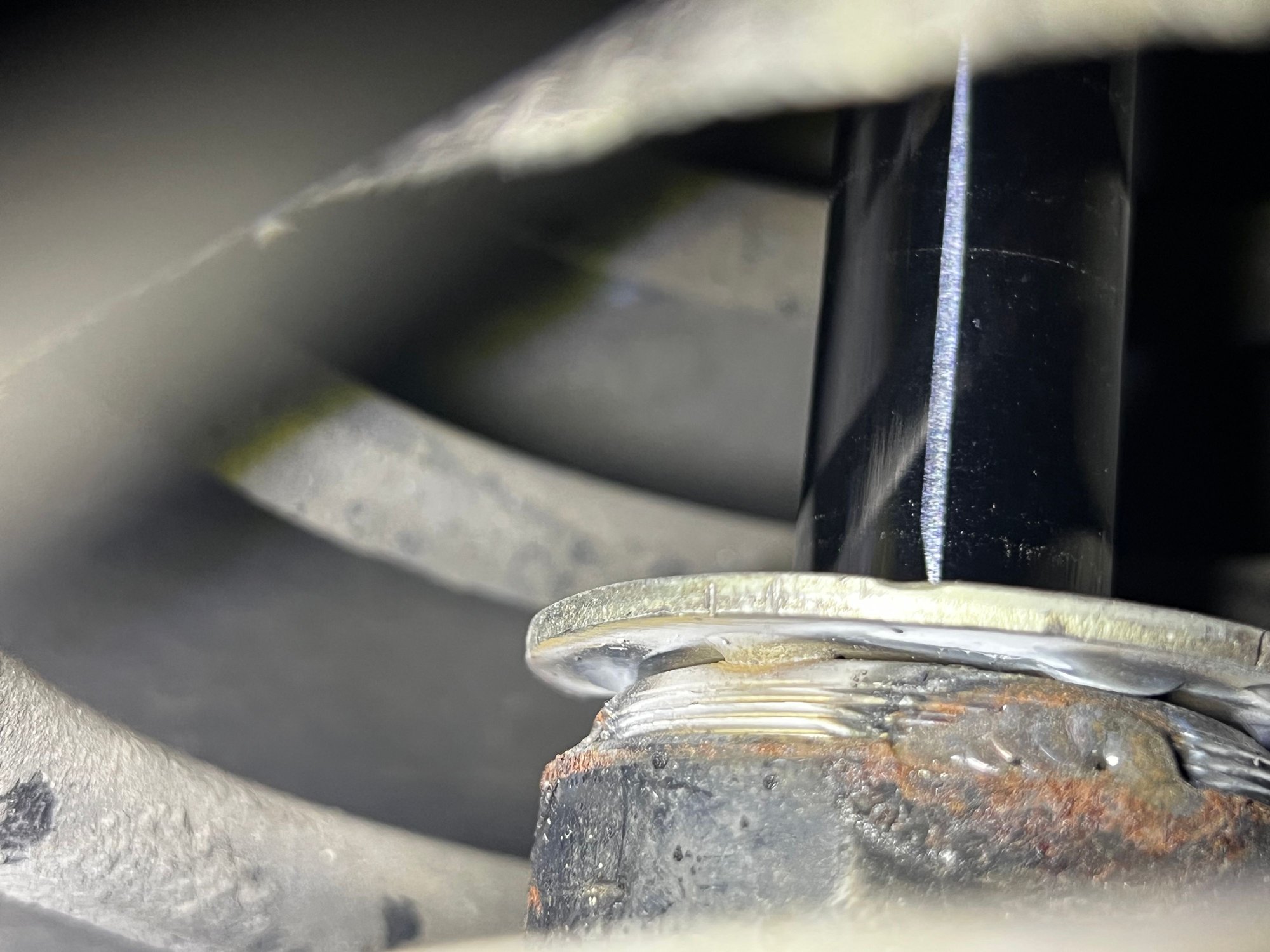

Ive got a 1983 245 that has a clunky metal to metal sound when I go over bumps. Sounds like from the driver side suspension. I’m pretty sure the sound came after I replaced front end parts (inner and outer tie rod, ball joint, wheel bearings). I properly greased everything and checked for tightness as well. I’m going to retorque everything again and degrease the ball joints. Someone said it could be gland nut and I finally got around to taking a look and this is what I found-welds on the threads. I’m guessing this could be the culprit? I had an alignment done after front end parts were replaced if that also is helpful information.

That would cause your issues as the gland nuts are a fixed point even if welded
Check your control arms and the threads on your ball joints my brother!!

Correction.. that wouldn't cause......
