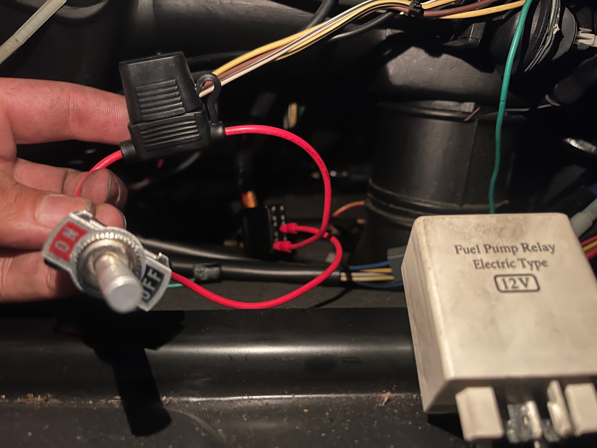

Now, I wanted to use the gauge to test my fuel system since I have a lean running condition, so I put fuse 6 back in, tightened negative battery terminal back in, and then I made this jumper with an on/off switch and a 20 amp fuse, which I used to short out the fuel pump relay harness to test the fuel pump.
I jumped red/yellow wire and red wire. I turned on ignition II and turned jumper switch to on. I could hear the pump working from my seat and I saw the installed gauge building up pressure till I reached steady at 38 PSI. Put fuel pump relay back in.

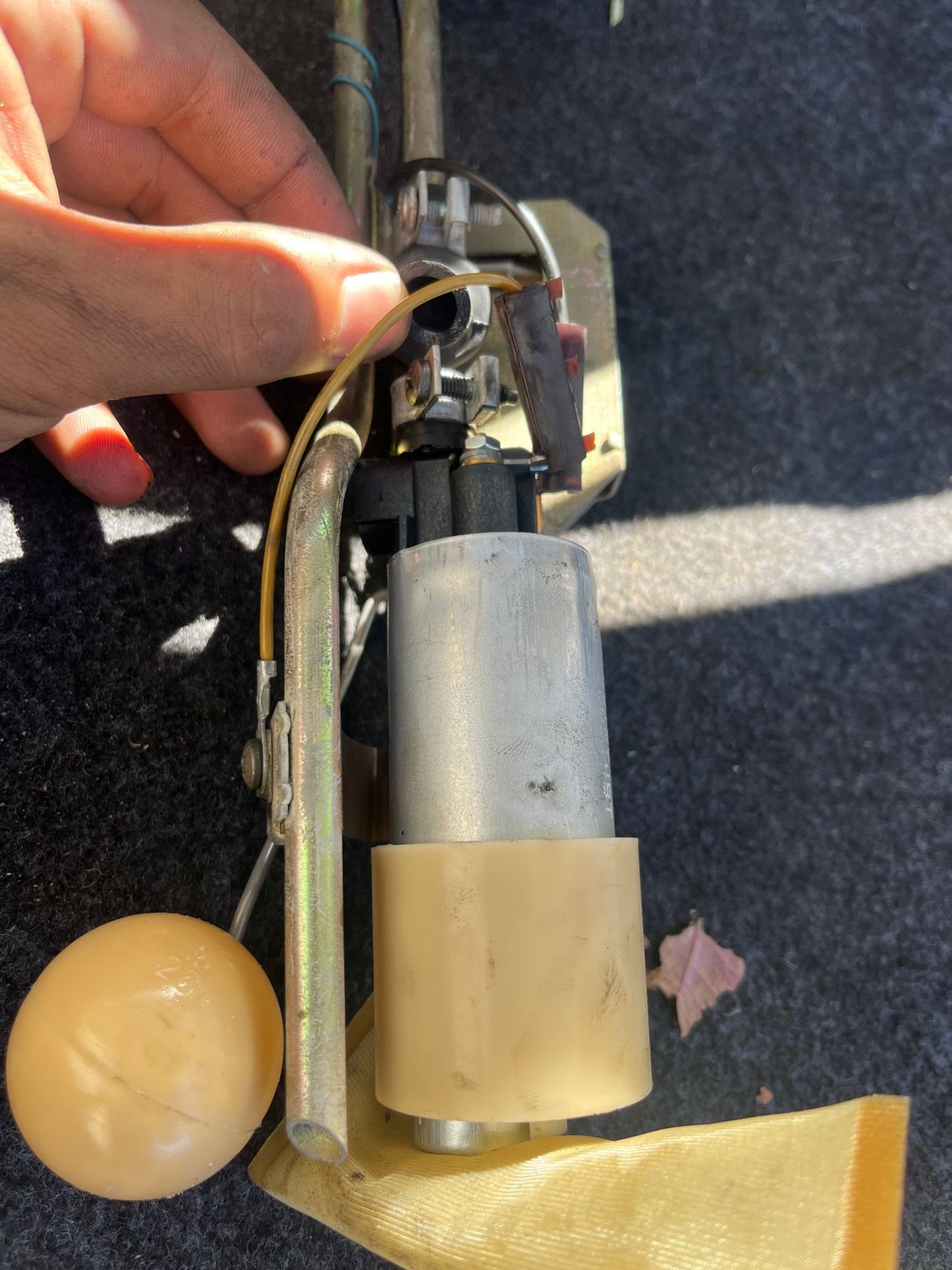

Default Problem Solved
I replaced the Crankshaft Position Sensor and Ignition Control Module. There was still no improvement, so then I moved on to inspecting the fuel sender unit from the fuel tank and I found the problem (the hose was cut in half right next to my thumb)
I replaced the hose, reset the ECU, let it sit idle for about 15 minutes, then did a test drive through the streets and freeway. All issues are gone and drives so much better. Thank you for all the help everyone.
