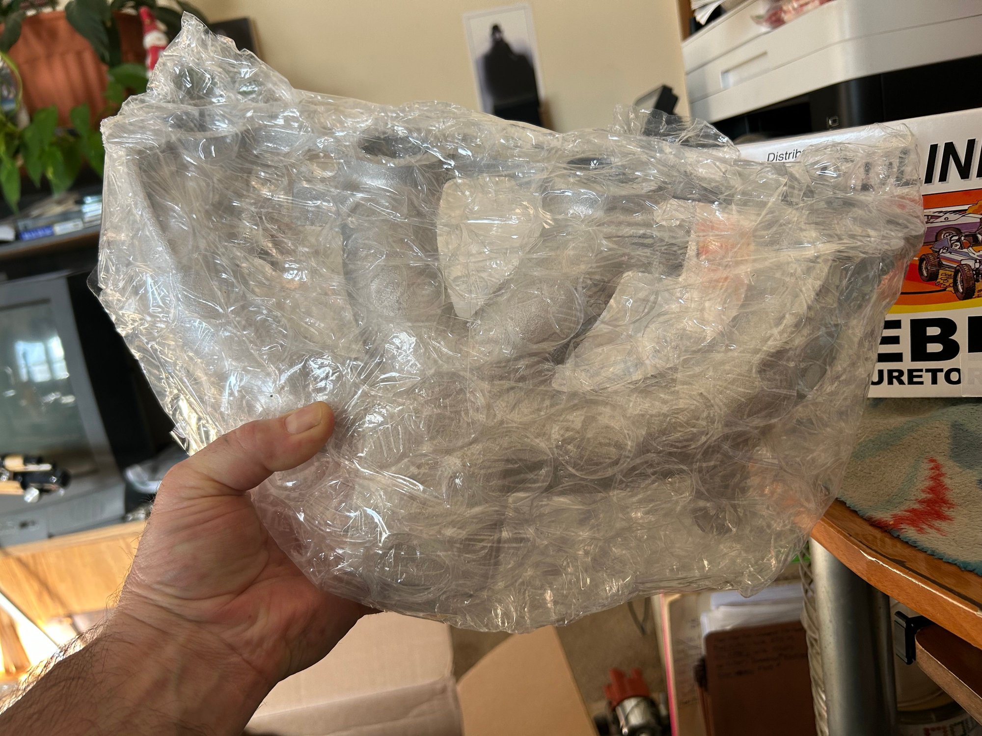

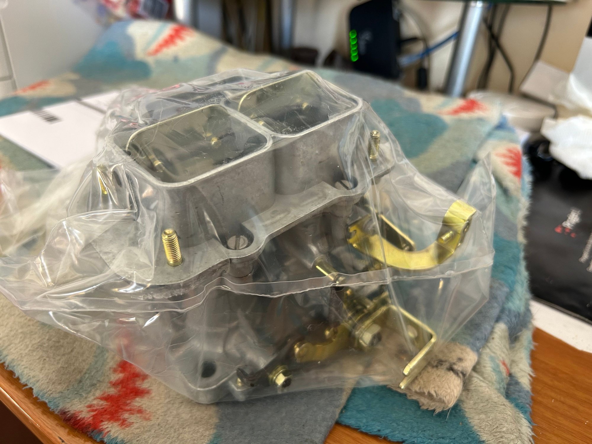

So now it’s my turn!
The original car I had mentioned in the previous posts (a ‘93 Regina system) is still running great, but I ended up with a 1994 940 as a winter beater that has been giving me trouble on a cold start. Tired of screwing around troubleshooting.
Has a new temperature sensor (for the engine computer, NOT the gauge), clean throttlebody, clean AMM, clean idle air control, zero vacuum leaks, plus a fresh cap, rotor, plugs, and wires, all top shelf stuff – Bosch and NGK.
Thing is impossible to get running unless you hold the pedal to the carpet when below 60°. This tells me it is an overly rich condition… BUT… the problem gets much worse in colder weather, which is the opposite of a rich condition. Huge PITA.
Once you manage to get it running it runs on 1 to 2 cylinders for about 30 seconds - quicker if you hold it at high RPM. The higher the quicker it clears out. I usually hold it at about 3500 RPM & it clears out in 30 seconds.Eventually, it smooths out like glass, & idles very low. But once past this point, the car is drivable.
Once warmed up it idles at 1400 to 1600 RPM. When driving, it pulls nice and runs smooth from idle all the way to redline so I don’t suspect any valve or engine issues.I suspect the AMM is probably junk (whenever the temperature drops more than 30° since last driven and I can’t get it running, unplugging the AMM gets it started), but I’m done troubleshooting.
Got myself that same Weber carburetor and intake manifold kit off eBay will be installing that next season. Going to try to get through this winter with it the way it is for now.
I was sitting here, thinking about the project, and realized that nobody anywhere on the net that I could find has ever tried running the stock computer controlled ignition with the carburetor. In theory, it should still work if you can rig up the throttle position switch to the carburetor. These computers aren’t very high tech and will work with 90% of the inputs or outputs missing.
I’m going to give it a try this summer and post back my progress on that when I have time to play with it and experiment. 👍
