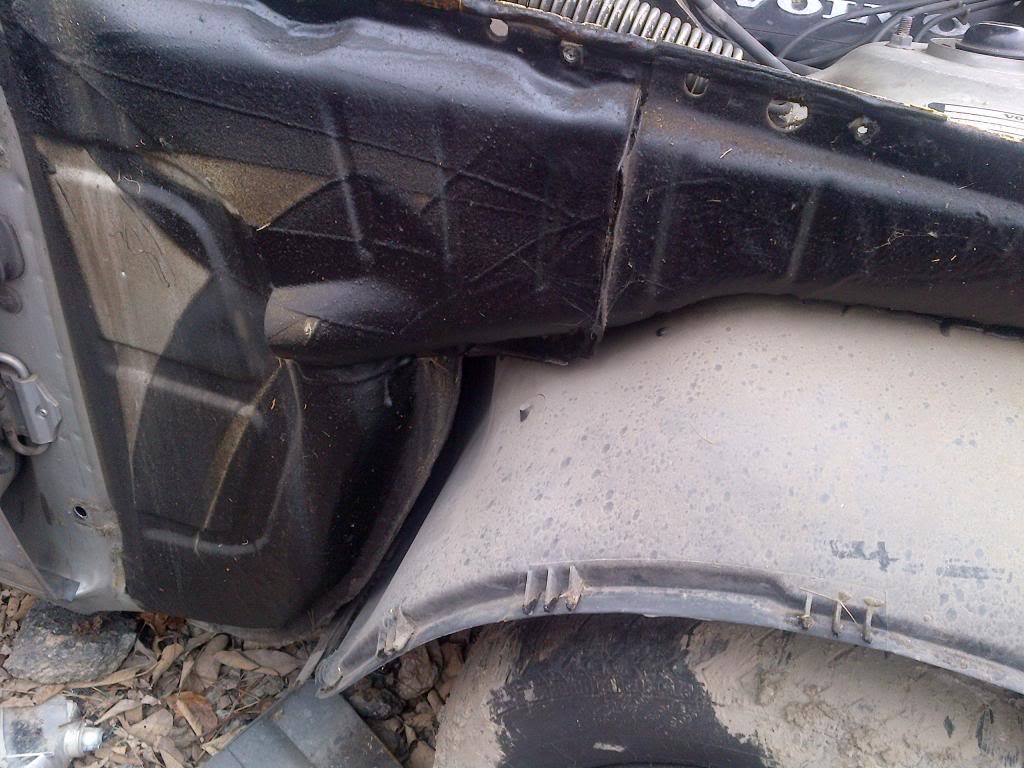

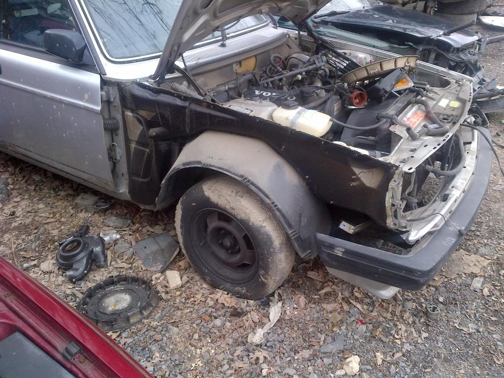

Some things to note about the 86 240 is the pre 1988 Volvo's tend to rust easy. by 1988 they made the cars more resistant to rust. By way of better treated metal.
Here is a 1991 Volvo 240 sedan in the local junk yard (I bought the head lights/floor mats from this car) with the fender off. It seems like Volvo treated the metal to a tar like undercoating to better fix the issues that caused the cars to rust in the past
