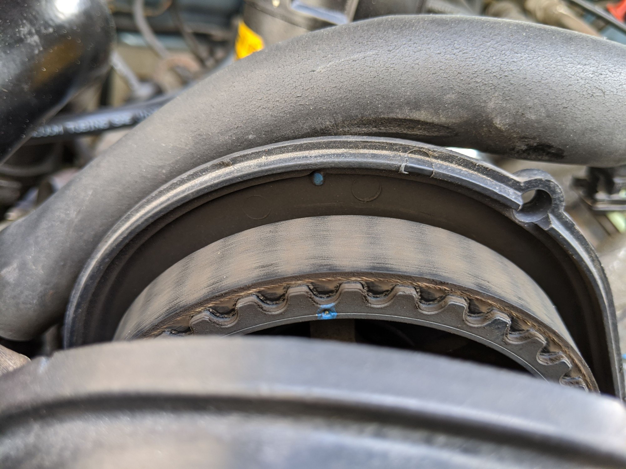

Thanks, Lev. I did just that. Loosened the tensioner and the belt tightened up nicely. Then I tightened the tensioner nut. Wondering if the loose belt might have skipped a tooth, I checked the timing. I lined up the blue marks on/behind the cam pulley and then examined the timing mark on the crank pulley. Pictured below is what I found. To these amateur eyes, things look poorly timed (and maybe the source of my engine woes). But I would appreciate feedback from someone who has been around this block before. Thanks.
Old May 15, 2021 | 03:50 PM
  #19
lev's Avatar
lev
Posts: 4,540
Likes: 137
It's not off by much... I don't think that's a skipped tooth.
How many miles on that belt?
Still the same driveability issues?

Yes - the car still stumbles at idle, misses during acceleration, and runs fair but not good at top speeds. Starts right up though. I'll go ahead and move the timing belt over one tooth tooth just to see. I found a "known good" used original MAFS sensor on ebay for $70 currently being shipped. If it's not the timing or the MAFS sensor, then it's back to the drawing board for the next idea.
