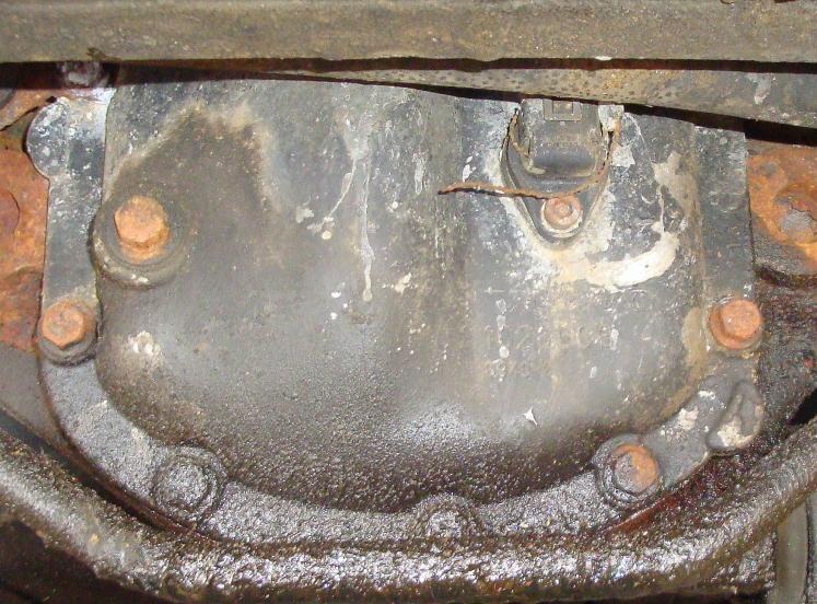

Default Help locating differential fill plug?
Thanks for the advice and pictures. I can't seem to find any way to get to the top of the case to locate the fill plug. Could you take a look at my pictures and let me know if it's in the photo? Looks like it could be the one to the left center? THANKS!!
If the picture doesn't post here being too large, can I send it to you directly?
Attached Thumbnails Help w/ Rear leak Differential?-dsc05649-1.jpg

You can fix the leak by replacing the diff cover gasket and refilling it with fresh gear oil. If it's too much of a fight you can pay most shops to do it for less than $50. As far as car repairs go not too bad. I did my own for $10 gasket and around $8 for the oil. and I used a good quality 6 point socket and an 18' 1/2' drive breaker bar all the bolts came out fine.
