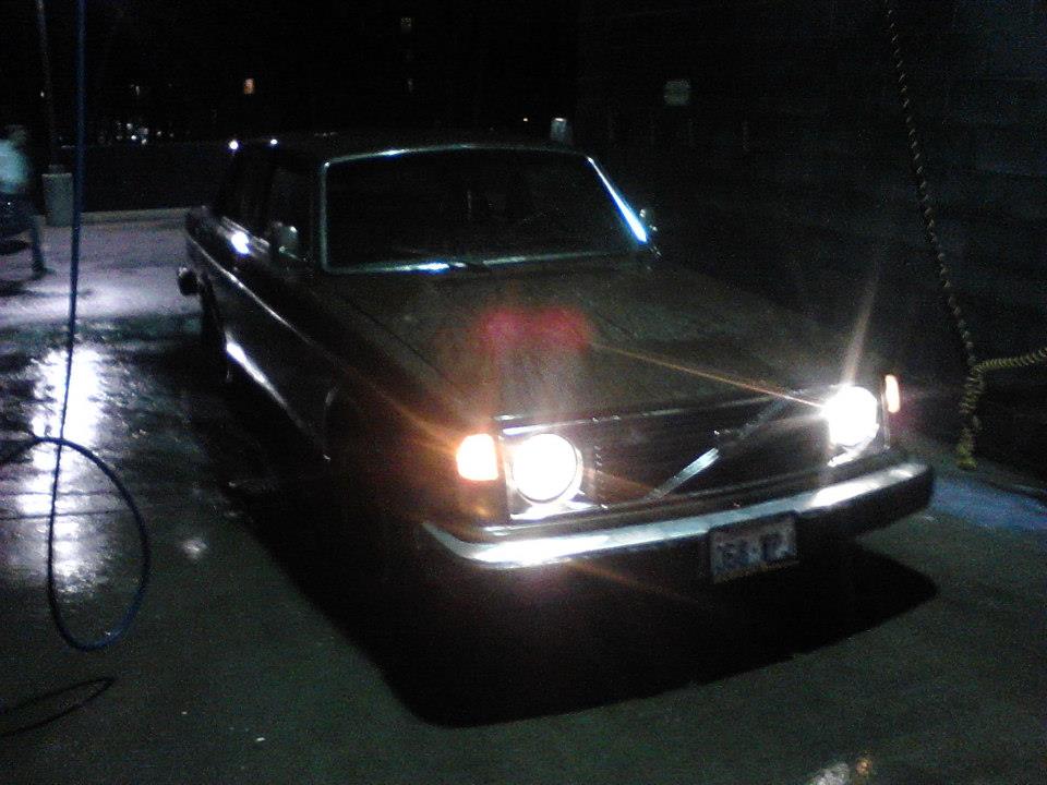

So after waiting almost a whole week my parts finally showed up. So with a full bottle of seafoam in the tank (and a lil less than half a tank lol) new plugs and wires, i hit the throttle body with some cleaner, and i just soaked my injectors in seafoam. Started up faster than its ever started before. And its been cold for a week. It actually has a little bit of pep too. I know as i got pulled over for Exhibition of Power HAHAHAHAHA. Thanks you guys you have been more than helpfull.
but I washed him up nice and cruised for a bit and Rufus is running well.
