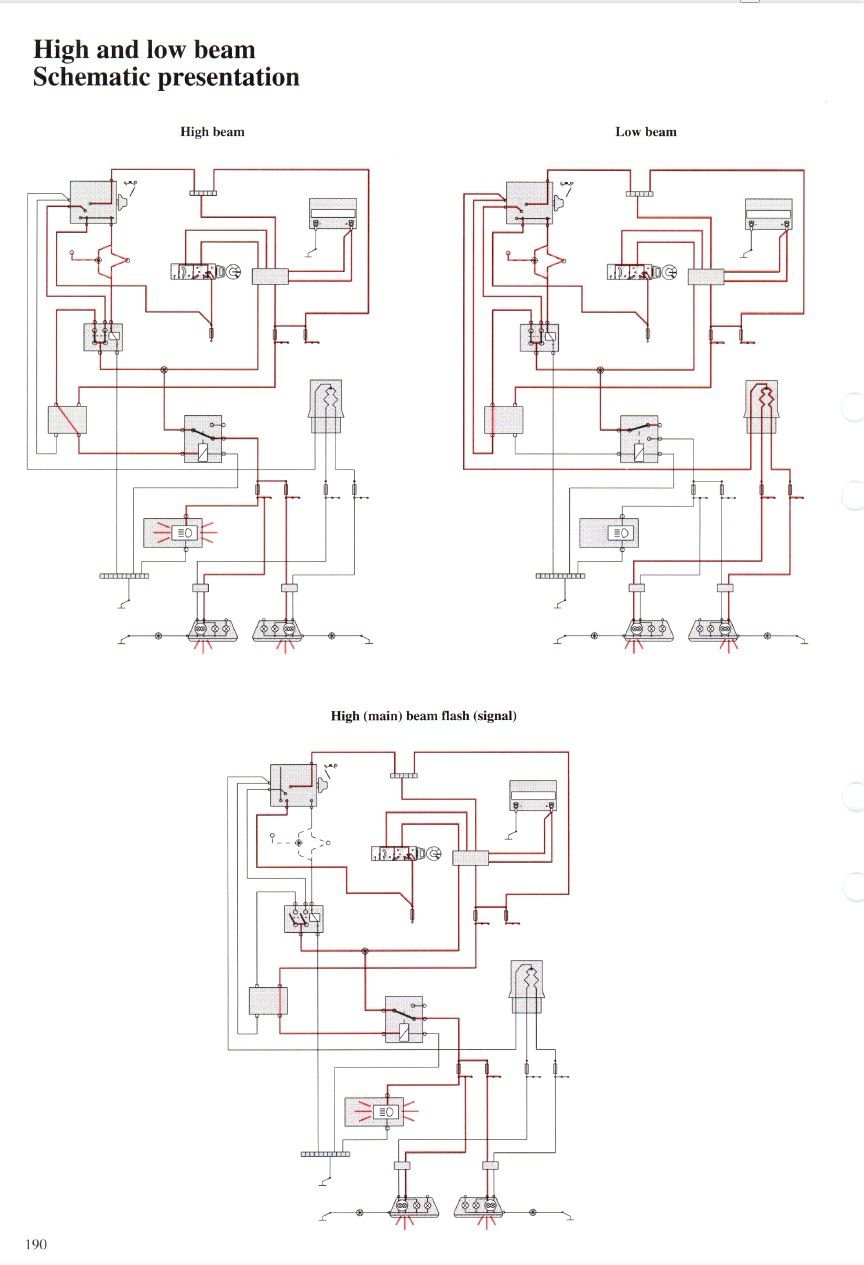

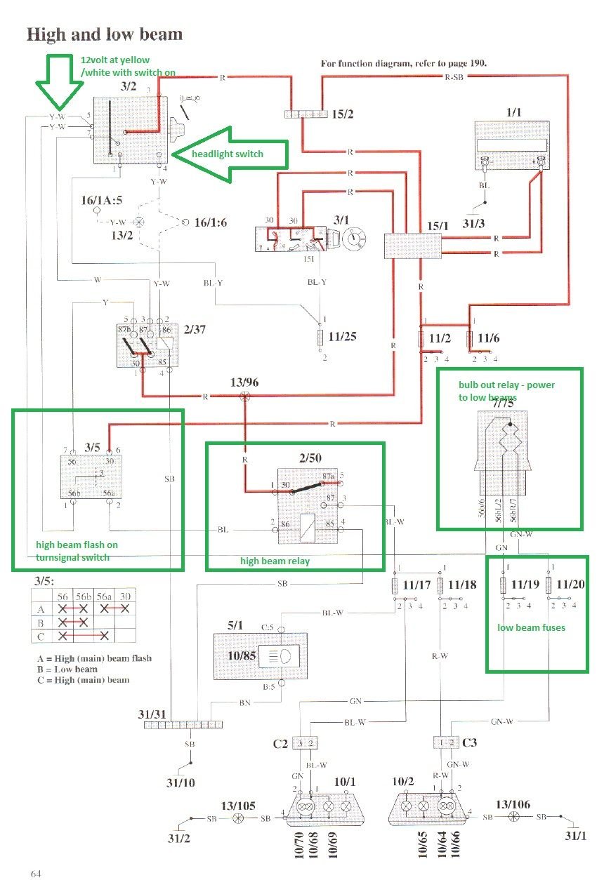

Do you have power at the 3 yellow/white wires at terminals 4 and 5 on the switch with switch turned on? For low beams power goes from the switch to the bulb out relay to the 2 fuses then to the bulbs. High beams - there are 2 relays
involved 2/37 and 2/50. Here's a wiring diagram and function diagram from Volvo

Right, Hoonk, Trying the six parallel spades of the Bulb Out Relay instead of focusing on the K relay. Thanks for the tip. Pretty sure that's the path. Though my ability to read wiring diagrams is on par with my arabic. D Day
