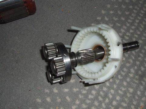

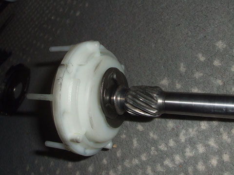

I pulled it apart... here's what I found. I saw a sticker for manufacturing. I checked our records and it shows a new one was put in in November of 99 at 87.5k mi. No one seems to remember having this done, but nonetheless, it's been done. I was under the impression that my year of car came with an older non-gear driven starter, if I's correct, then it looks like this one is a newer style one.
Anyway, the damage is the plastic outer ring gear. It fell apart and broke in several places. Then rest seems to be in good shape. The brushes have an acceptable amount of wear for their age, but the commutator looks like only very minimal wear has occurred. If the ring weren't plastic I'd say that I have another 100k mi in this guy. Sourcing parts may be the snag. So now I'm off to price out a new starter, unless I find some readily available rebuild parts.

I started with the transmission. The output shaft and outer tracking gear are first. The tracking gear is the part that failed. I packed them with grease and slid the tracking gear over the end and put the large thrust washer over it too, with grease on all sliding parts.

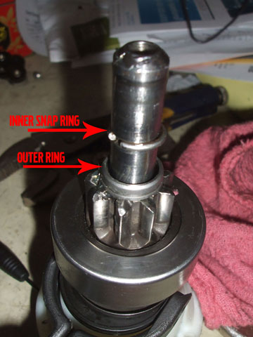

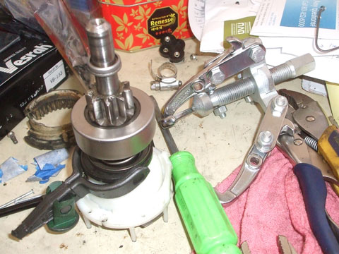

Then next part was the most difficult part in both disassembly and reassembly. There’s a funny snap-ring with another solid ring around it. I hit it with a screwdriver and hammer back towards the gear. The outer ring came off and then I spread the snap-ring with vice grips. So to put it back on, I put the solid ring on first and then the snap ring. Once it was in the groove I clamped it shut with the vice grips and ended up using a small puller to pull the outer ring over the snap ring. I had to hold the 3 jaws together and it started it on easily. Then I finished up with the vice grips.

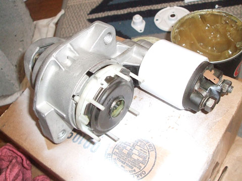

Throw in the solenoid core with the spring and the rubber block next.
Then I put the solenoid coil one and only snugly fit the screws on.

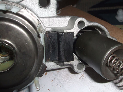

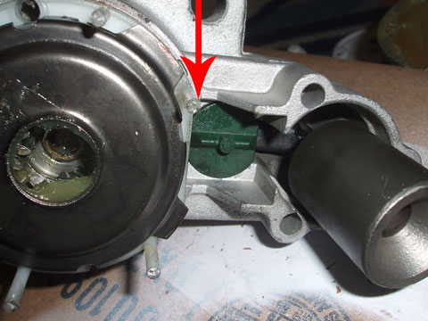

Slip the armature housing on next. Align the cutout with the rubber block.

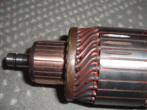

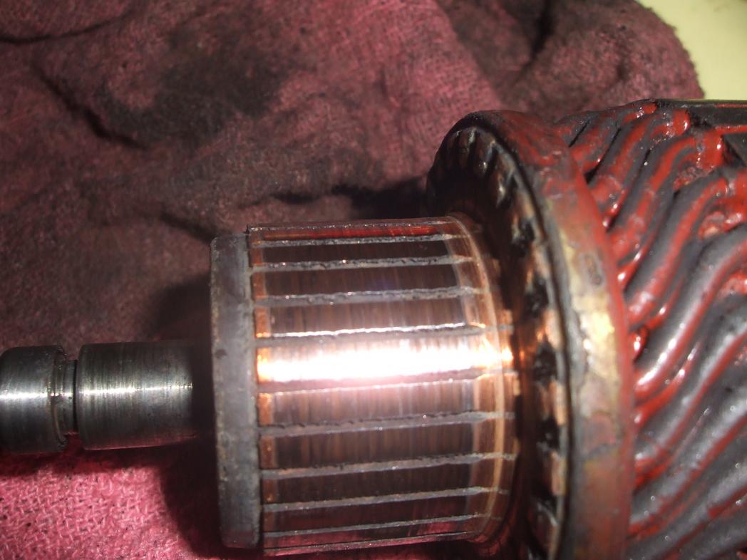

Before hand, I cleaned up the armature commutator. It was in pretty good shape already. It showed very little wear, but leveled it with a block and sand paper. It just took out any minor grooves. I finished with 2000 grit, but that was excessive. 220 to 400 to 600 is what I did before the 2000.

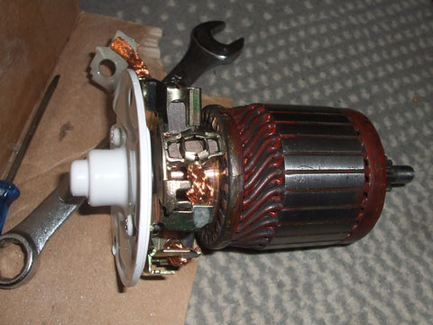

Before putting the armature in, it’s best to put the brushes on. The holder was a little misshapen, but I turned it so it would spread the brushes wider and it went over the commutator easily.
Then grease and throw the back cover on. Put the washer and c-shaped locking thing on with grease. Then put the cover on and the screws hold the cover to the back plate and the plate to the brushes. I left them a little loose.
Toss the whole thing in. My armature shaft was a little swollen on the transmission end so I filed and sanded it a bit to make it fit, earlier.

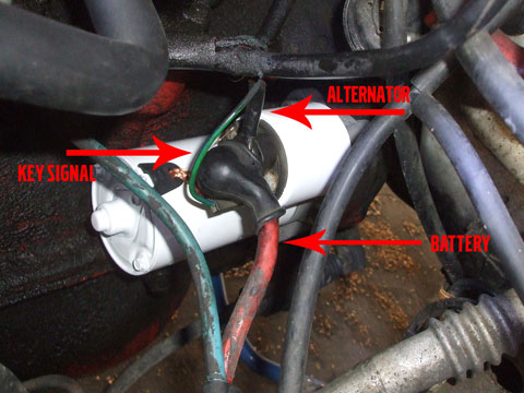

That’s it. It’s rebuilt. Put it on the car. The main bolts on the bell-housing are 19mm (which is ¾ in). Connnect the alternator and battery wires to the top lug on the solenoid and the Green and Blue striped wire to the outmost contact and it’s ready to run again!
