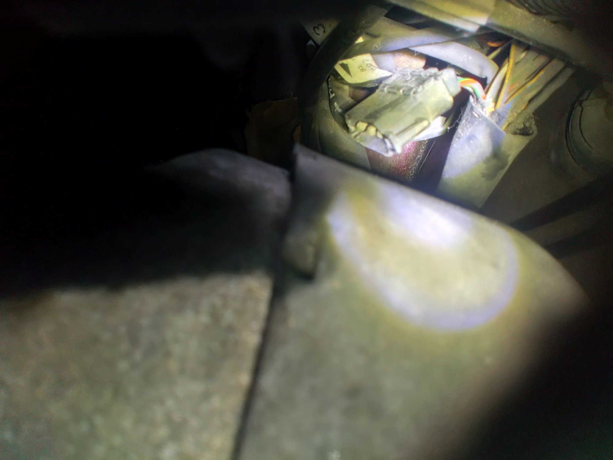

Will th lack of a lambda throw th other sensors out or at least baffle th ECU or am I grasping at straws a little, and where would th lambda plug into, once I've obtained and fitted one, I've found a spare connector, below th intake manifold, below th engine coolant sensors, which both appear to be wired up, I'll attach a photo of this. Any views, tips or inspirational moments welcome, as I'm beginning to wonder if I've finally bought a lemon, despite th engine having very healthy compression figures, and it's first wash in 8 years revealed it to be a quite attractive metallic maroon and not a dirty faded red as I first thought... Cheers folks, John.

Sustained by pints of proper deep orange coloured tea, motivated by a pint of teeth chatteringly string coffee and calmed by a few swigs of rum, I've braved th seasonal monsoon, had a look and found an unconnected plug. Looks nothing like yours, but that doesn't mean it's not it... I'll attach a pic.
Anyway, using a pdf of a factory manual, and referencing my chassis plate for engine and build specifics, and referencing that to another page, I've obtained th OEM bosch part number, located one, and have just ordered it. Let's just hope it is th right one, and that this is th plug, guess I'll find out tomorrow.... Once more, thank you for all your efforts and replies so far, tho I'm sure this is just th first chapter of quite a long book.... J

Th connector in question......
Old Apr 25, 2019 | 11:37 PM
every 80s and newer volvo I've seen, the O2 sensor has two connectors, a 2-pin square one for the heater circuit, and a 1 pin round one for the signal. and even on the venerable 240, its near the top of the firewall, on the right side of the car, where its shown near the coil in that one pic. Note that the coil itself can move around on different cars.

Aye, that's my concern too, but that's all I could see or feel in there. Well, I've ordered th sensor, oem part number, let's see what falls out of th box.... Tho, to get from where th sensor isn't plugged into th exhaust, to go up into th engine bay there, that's quite a distance, tsk, if only I had a vehicle lift,life is so much easier when you're not scrabbling about on your back like a Friday night drunk...

Well, slap my thighs and call me Cuthbert, further scrabbling around in th grit, th grease and th grime has revealed not only wiring, but also a lambda, only this is mounted at th front of th cat, on th inboard side, and th wiring takes a quite circuitous route, to th aforementioned style of connector. Well, that's something at least, I'll replace th front section of exhaust as I don't like th look of what I've got too much, I'm not convinced th plug sealing th lambda hole is going to come out, but I'll still chuck my new lambda in and just leave th other in situ but without wiring. Darn it, I'll clear these codes off and see what happens, we'll, as I've got to charge th battery I'll do it that way, see if things settle down a bit. I thought it bad practice to mount an 02 sensor in th cat, that far away from th engine. Hmmm, blimey, I think I mignt get someone who knows their Volvos to have a butchers at this, see what they reckon... Its at times like this that th vagaries of JAP V twin powered Morgans seem inconsequential....
Old Apr 26, 2019 | 01:52 PM
  #17
that plug was there from the factory, its for inserting an exhaust gas analyzer before the cat.

Ah, well, that makes sense, after charging th old tubs battery, she's started perfectly, and, so far her tickover is nice and steady, no wandering up and down between 5-900, even th lambda light stayed of for 10 mins and after a quick squirt up and down th road, she seems far smoother than she did. Tho, as its dark and raining again, I think I'll call it a night and resume play in th morning, with fresh road tax and a hopeful spring in my step. Tho I have detected a slight oil weep from th front, poss crank seal, ah well, fix one thing, find another, I was expecting to have to do all that, so thinking it'd healed itself was a bonus, onwards and upwards and pass me th rum...
