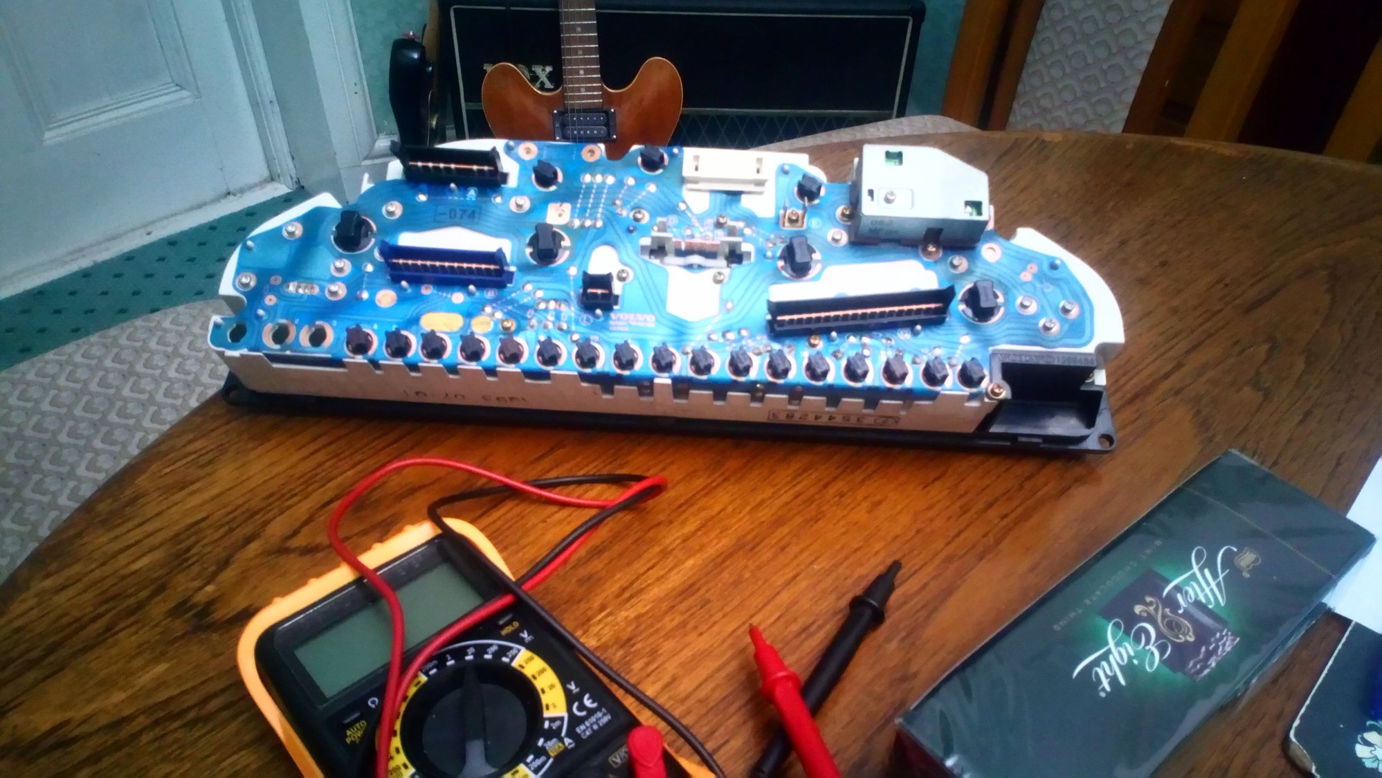

Well, after consuming an entire box of after eight mints, thus ruining th strings on my guitar with childlike sticky fingers, and many hours of poking around in th depths of my gauges, I've restored function to th fuel gauge, I can cope without a speedo for a while, tho I've also picked up a box of assorted capacitors from a local electronics repair guy, who's offered to do th job in return for a couple of bottles of rum, I'm going to have a stab at it first tho, exciting times, exciting times....
Th rum fuelled minty choc smeared testathon
....I've got th function i most wanted back....
