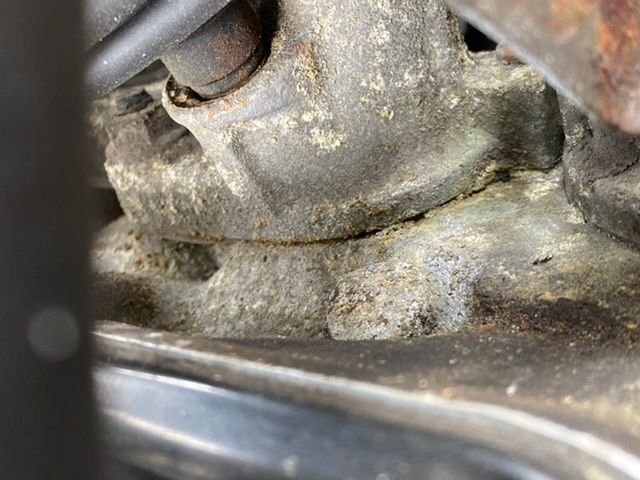

Edit: I went out and took a look at the car. I was initially thinking of trying to make a valiant effort at replacing the sensor without taking the intake off. But the intake gasket seems to be in a bit of a poor shape by cylinder 1
So I’m thinking of going about the following way:
1. Disconnect fuel pressure relay and crank the car for a few seconds to relive any fuel pressure.
2. Disconnect the intake accordion hose and the smaller hoses to the idle control valve and the flame trap.
3. Disconnect the injectors and label the wires
4. Remove the 8 bolts that hold the manifold in place.
5. Figure a way to zip tie the manifold to the strut tower or hood hinge.
6. Replace crusty manifold gasket and suspect coolant temperature sensor.
Does the above seem like a logical way of doing things? That way, I won’t have to fool around with any of the fuel or throttle stuff. Or is worthwhile to replace the throttle body gasket while I’m doing this. The throttle body gasket would most likely have been exposed to oil for a while due to the severely plugged up oil separator box that I cleaned recently.
