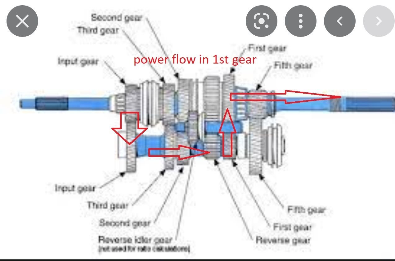

Originally Posted by bømlobrick
all i'm left with is 4 gear. Can anyone explain this and why?
Here's a diagram of the insides of your transmission. The laygear in the bottom of transmission is used for gears 1,2,3 reverse and 5th. 4th gear is "straight through". The laygear is one big part. So all those gears on the bottom spin together. Gears on the top row can spin independently (of each other on the top row) giving you 1,2,3,5 and reverse. The m47 has an aluminum case and is a "weaker" trans than the m45/46.
So you broke something related to the laygear - Maybe the teeth off of the small input gear.
