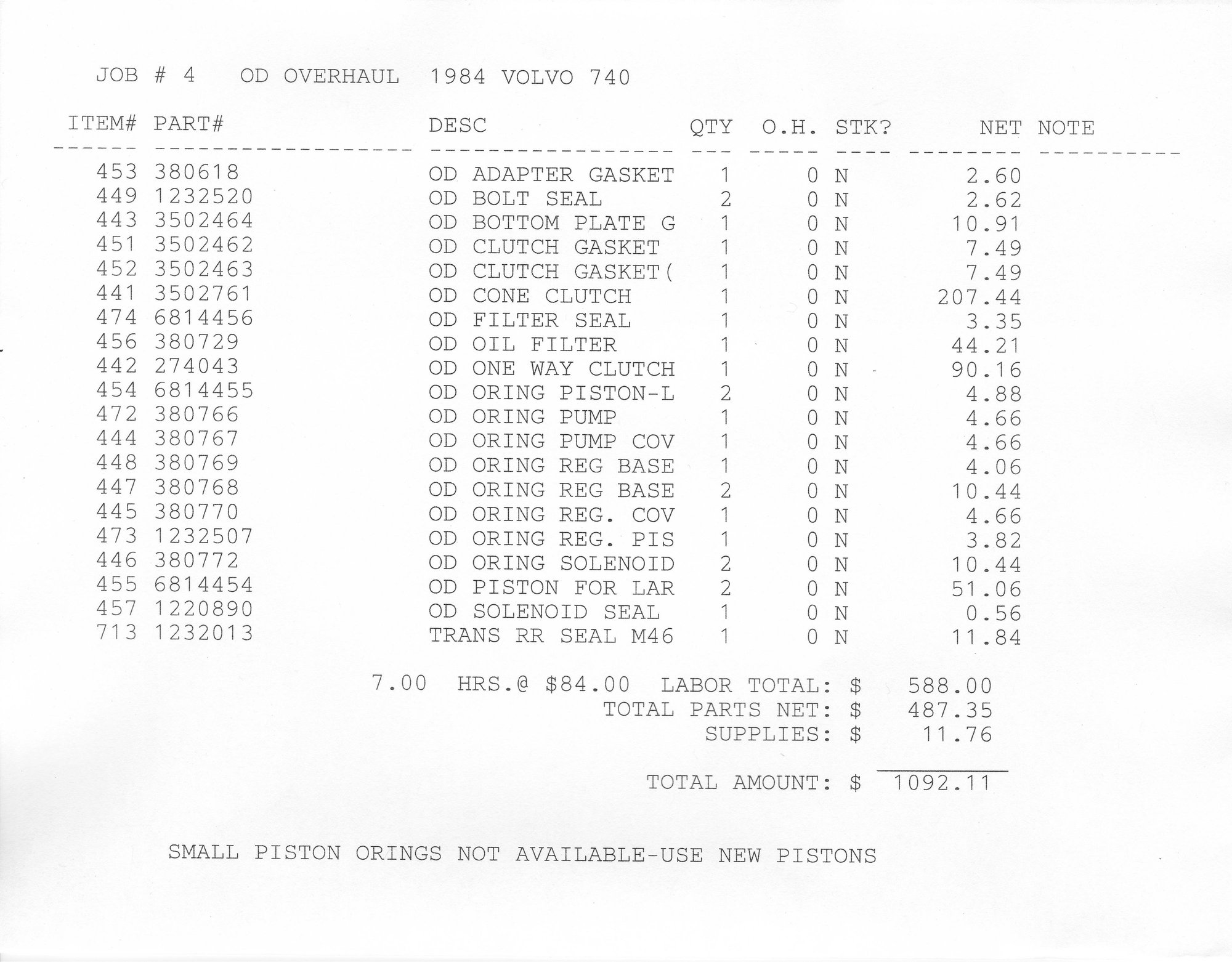

The overdrive units wear out - I've rebuilt maybe 20 of them, but none in the past 23 years - does it work, and are parts still available?
If you are going to put a manual in - consider the pure 5 speed the m47 - yes it's not as reliable as the 4+od but won't have a bad overdrive unit on the back of it or need wiring, a switch and a relay to make 5th gear work. .
If you are curious what parts for an OD might be needed - Attached is a copy of my OD overhaul job list - the parts prices are from 1997, the last time I did one -
