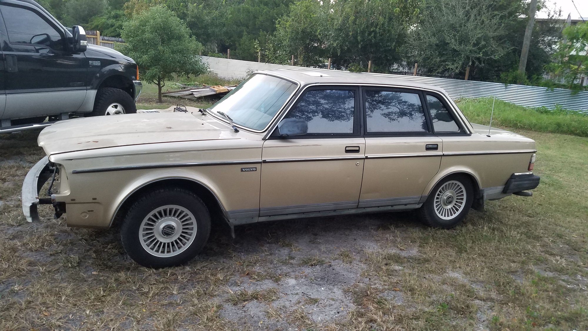

I was thinking as I was looking at the wheels today...are they just painted/powder coated silver, or are the aluminum...a brushed metal of some sort? I like the stock wheels, going to see how clean I can get them, otherwise I want to paint them silver again. But if they're something that I can polish down to a nice shine and clean finish, I'll do that.

depends on which wheels you have. I believe the Corona umpteen-thin-spoke 240 wheels are machined, then clear coated. the ones with a more silvery finish have Wirth Silbur wheel paint and clear coat.
I've seen the Corona wheels glass bead polished, clear coated, and mounted with chrome lugs and no hubcaps, they looked pretty good. the original center caps on the Corona are rattly annoying things.

I believe it's the multi spoke ones you mentioned, they look painted, and the caps look like aluminum. They can be seen in the pics in my first post.
Old Nov 4, 2017 | 02:32 PM
  #25
the center caps are brushed stainless steel, I believe. we had the same wheels on our 87

the wheel is aluminum alloy, a stainless steel wheel would be very heavy (and expensive). aluminum has to be anodized or painted or it quickly pits and goes dull.

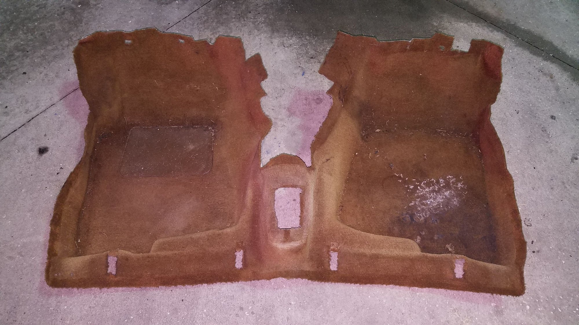

@pierce...you are awesome! i was able to use a battery and give power to the drivers door window switch harness and was able to roll all 4 up. at least they're up so i don't have to put a tarp over it anymore. now i need to search for the issue that is causing it to not work. i have the center console removed and i didn't see any relay(s) there, but it was getting dark so i will look again tomorrow in the daylight.
i did a quick pressure wash on the front section of the carpet, it got it a lot cleaner (the water was BLACK as i was pressure washing the carpet. i'm going to do it again and wetvac it dry real good, then let it air dry 100% and reinstall it. i hate nasty carpet more than anything.
before
after

going to remove the rear section of carpet in a bit and go pressure wash it. while i did get the front pretty clean, i am not sure if i want to keep it or not. well, i'm going to keep it, but i may glue some aftermarket black carpet on top of it. my upholstery guy has done this before as well as myself in my 04 mini cooper, just glue carpet from a roll (it's pretty stretchy) to the factory carpet since it's just from a roll and not made to fit the volvo specifically. but i will decide that after i get the stock carpet as clean as possible and reinstalled.

oh wow, this really makes me want to dye my carpet now. i was never one to want to dye carpet, always thought it would look like crap, fade quick, not cover every fiber completely, etc.
but this "RIT" dye you can get right at walmart seems like it's a great way to dye carpet!! check out this thread i just found, the pics of this guy's carpet is insane! it looks like factory black carpet, you can't see the old tan at all, and at the end of the thread he posted 2 years later that it still looks like day 1. i think i'm going to do this, and of course i will take pics along the way to post here.
Finally Black Carpet - Dyed my Tan Carpets Black !!!!
they make it in liquid and powder, both you mix with water, so i don't see why anyone would buy powder if the liquid is available, seems like liquid would be easier IMO. from what i read they make it in multiple colors.
