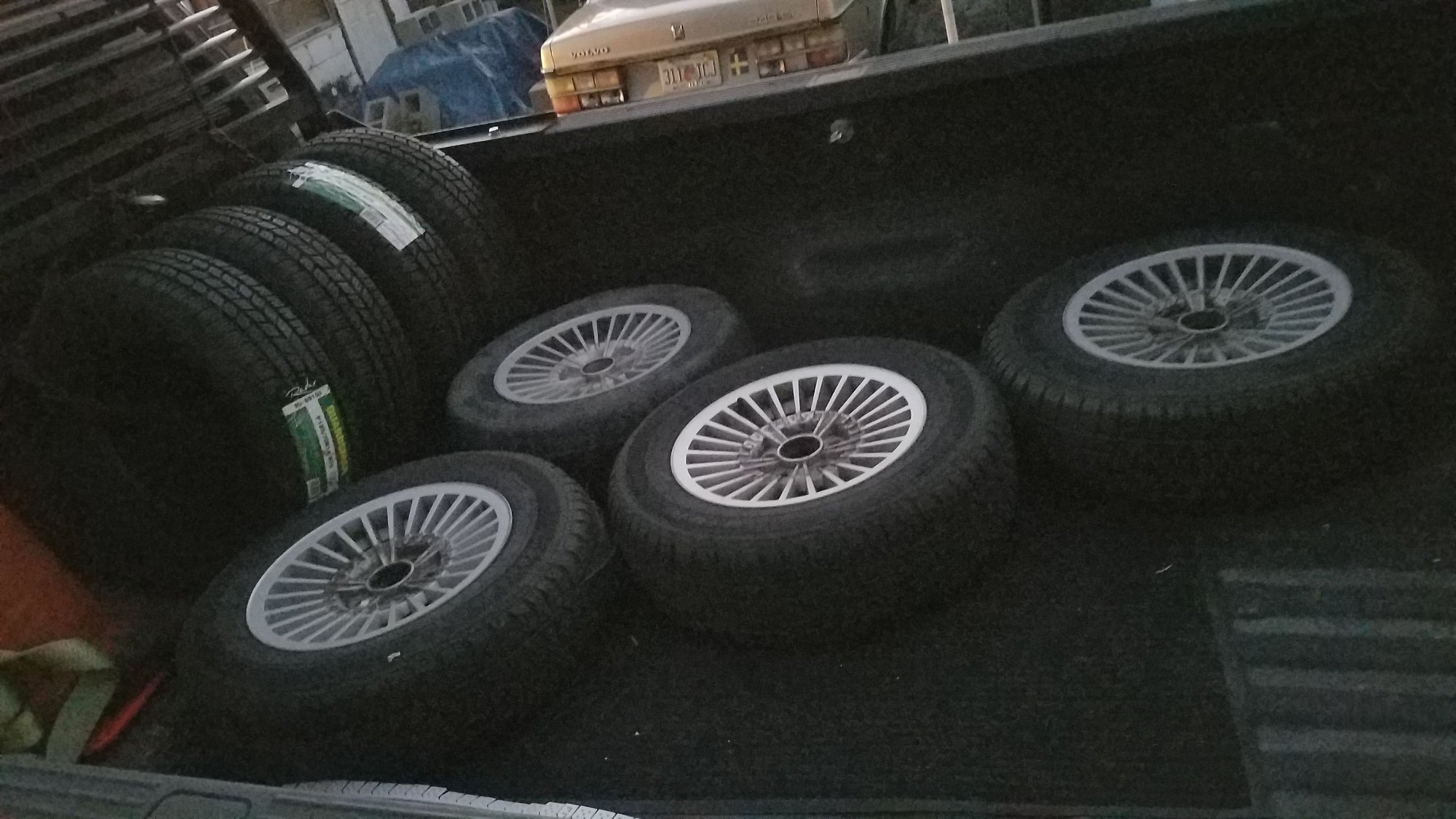

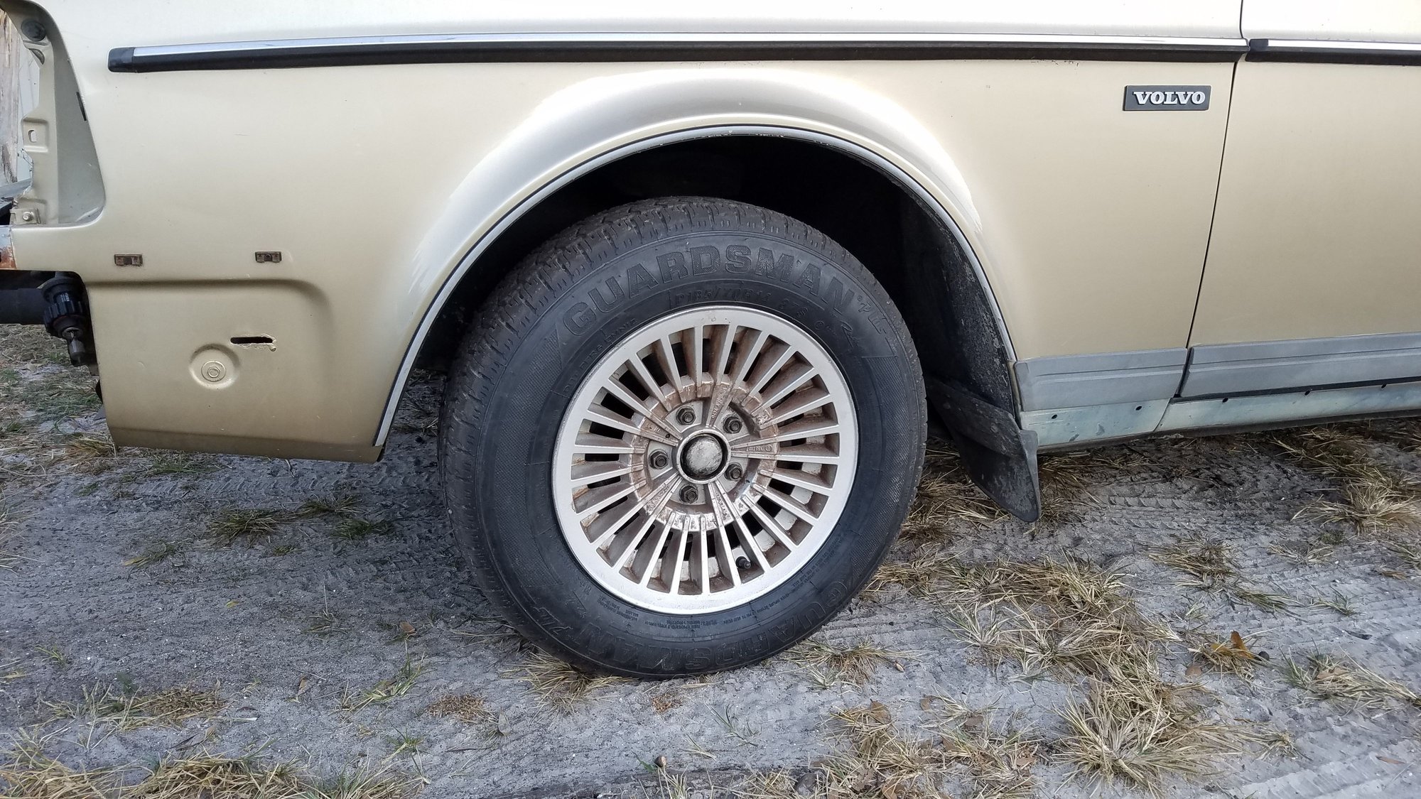

Got the wheels and new tires loaded up to get put on tomorrow.
Old Nov 19, 2017 | 12:31 PM
  #55
ufvj217's Avatar
Joined: Oct 2017
Posts: 37
got my new tires on

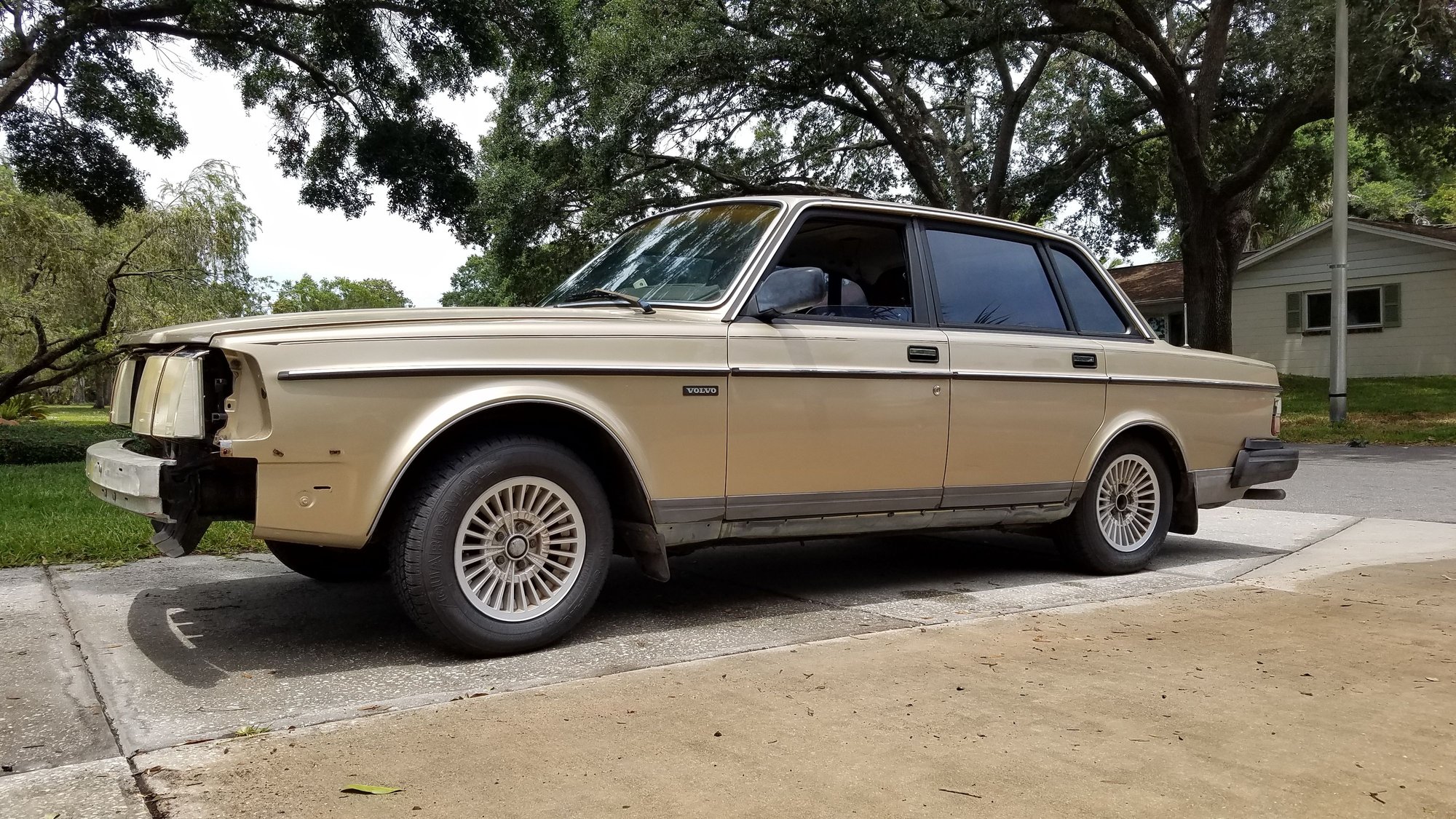

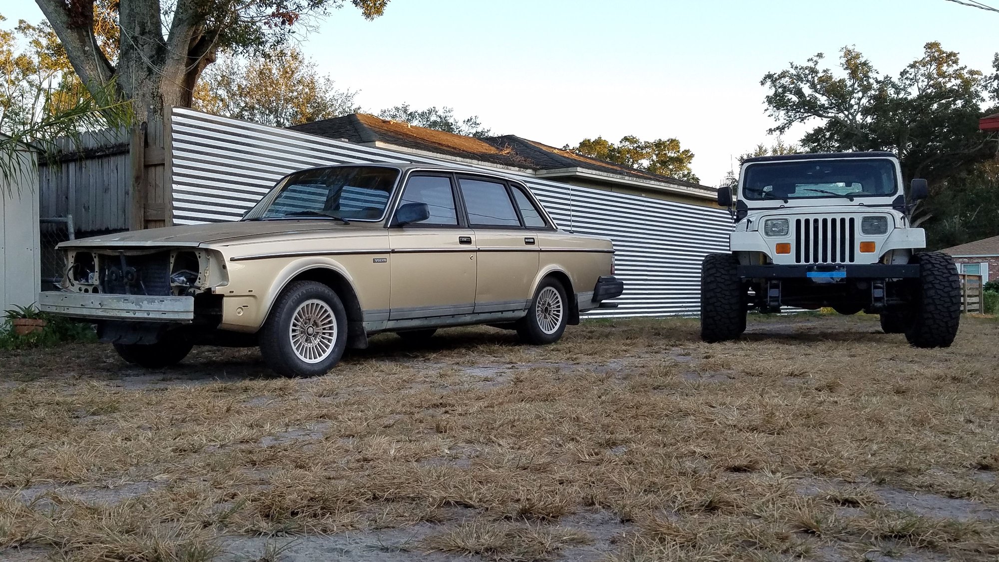

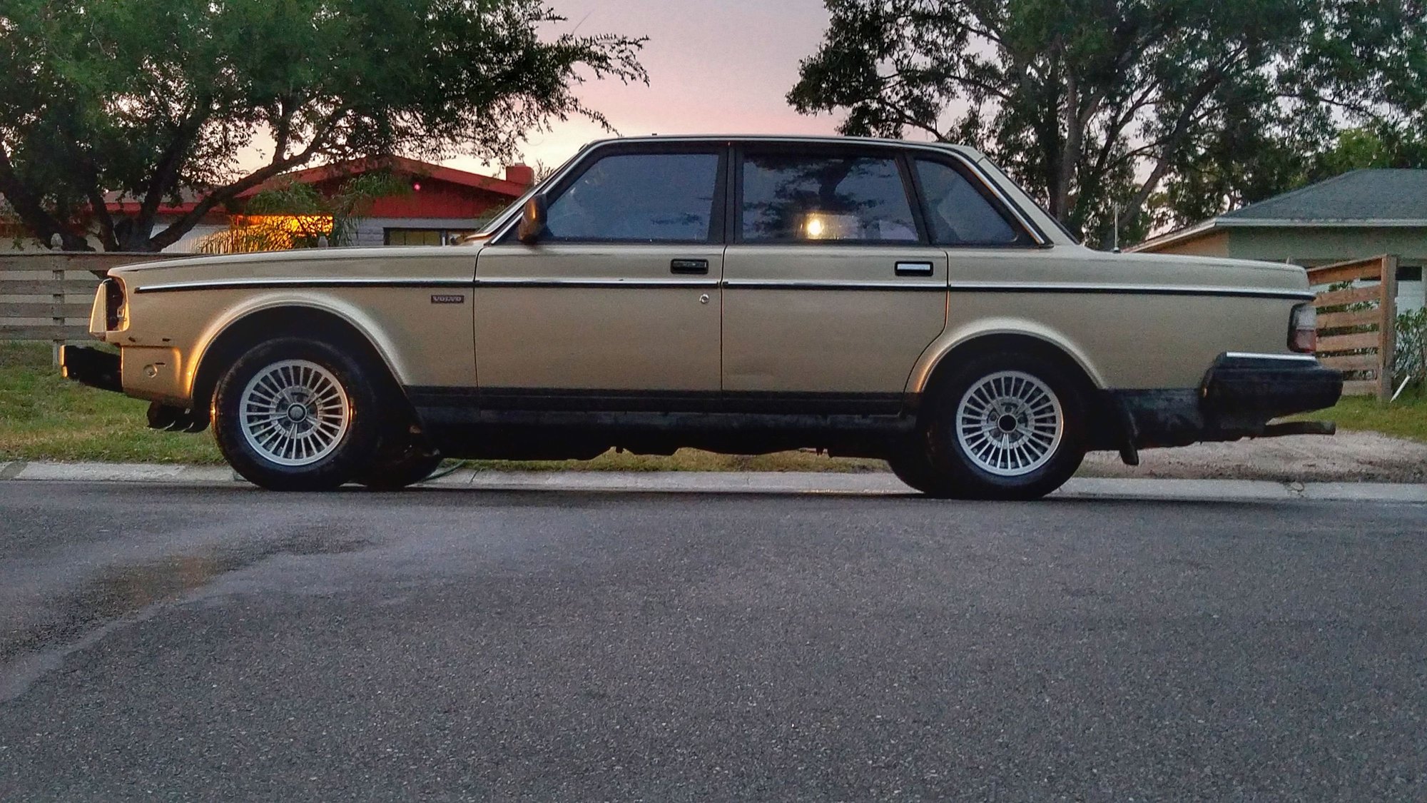

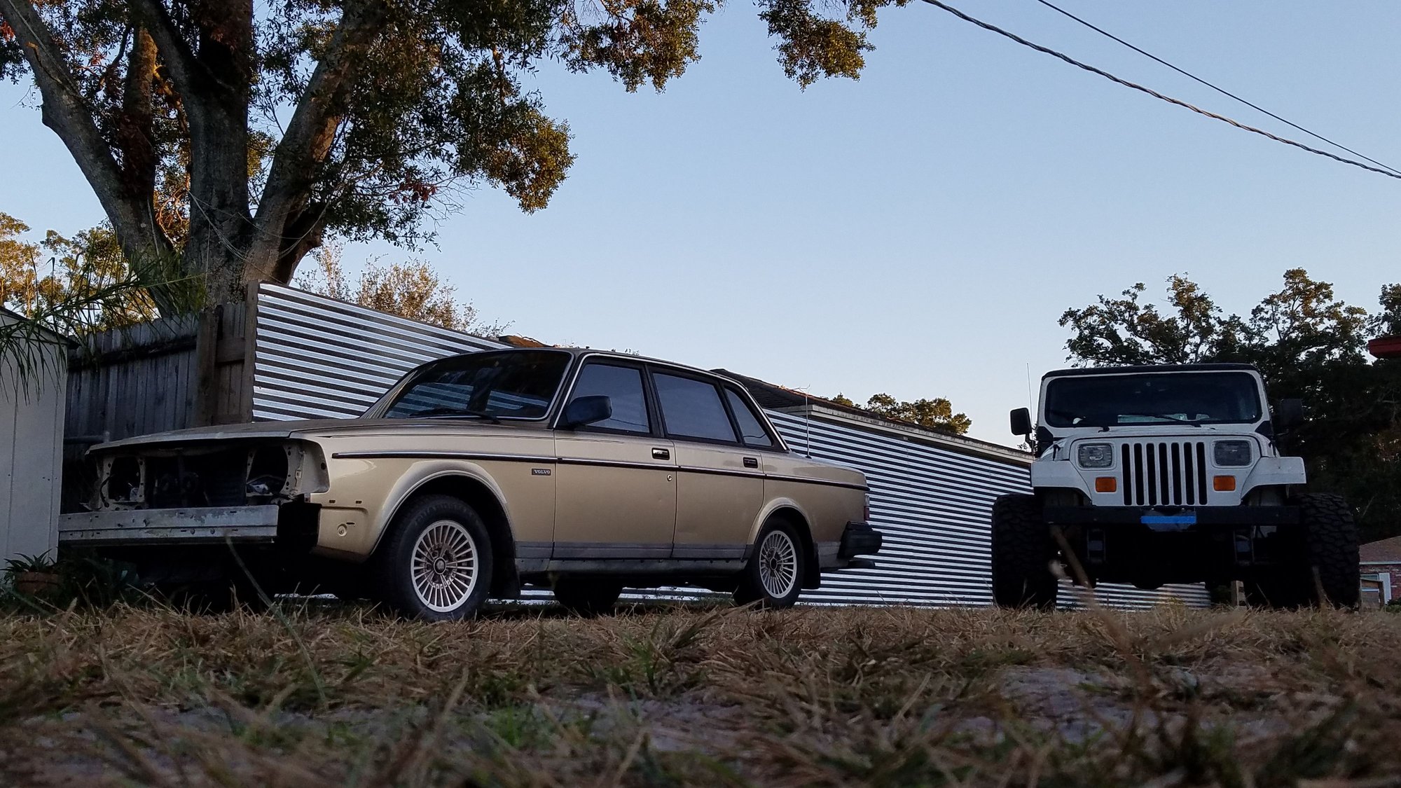

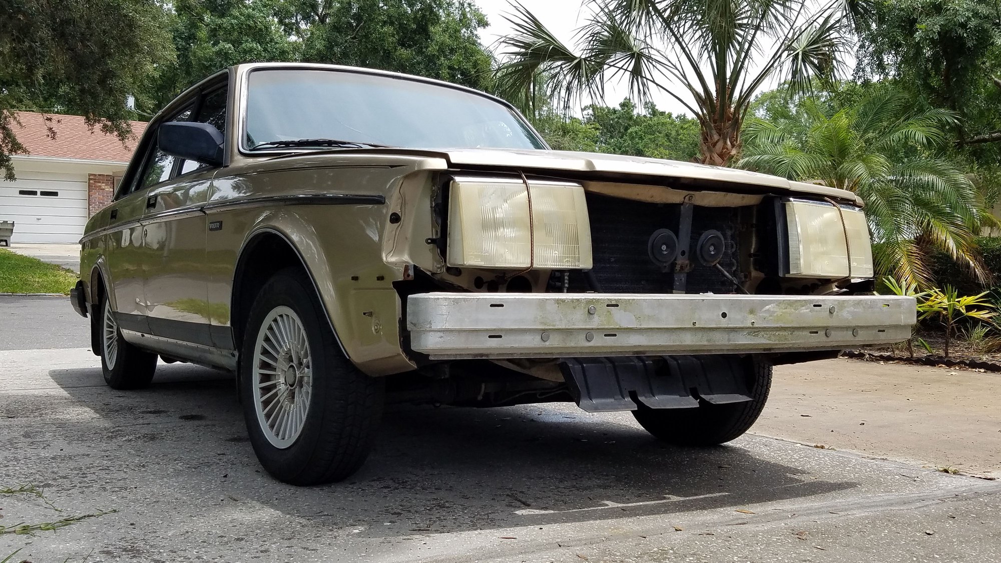

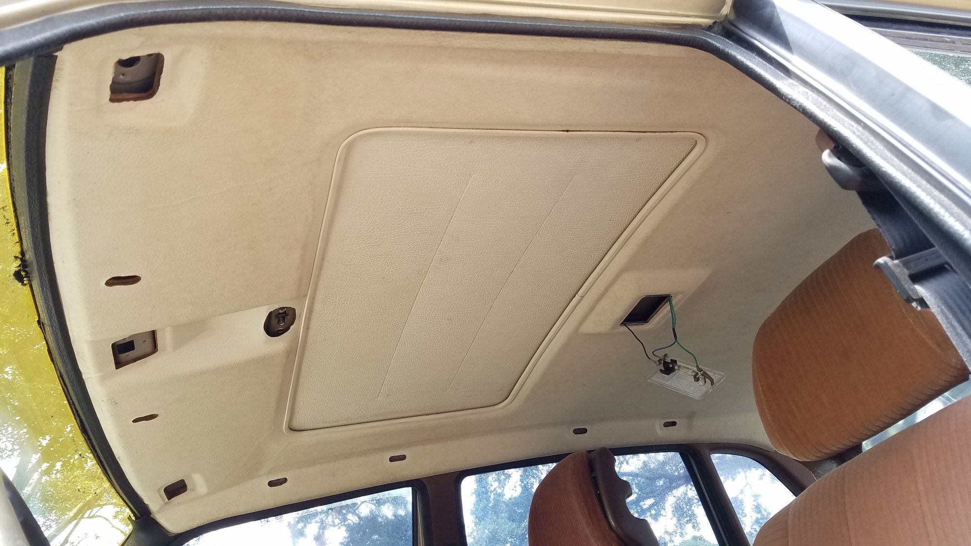

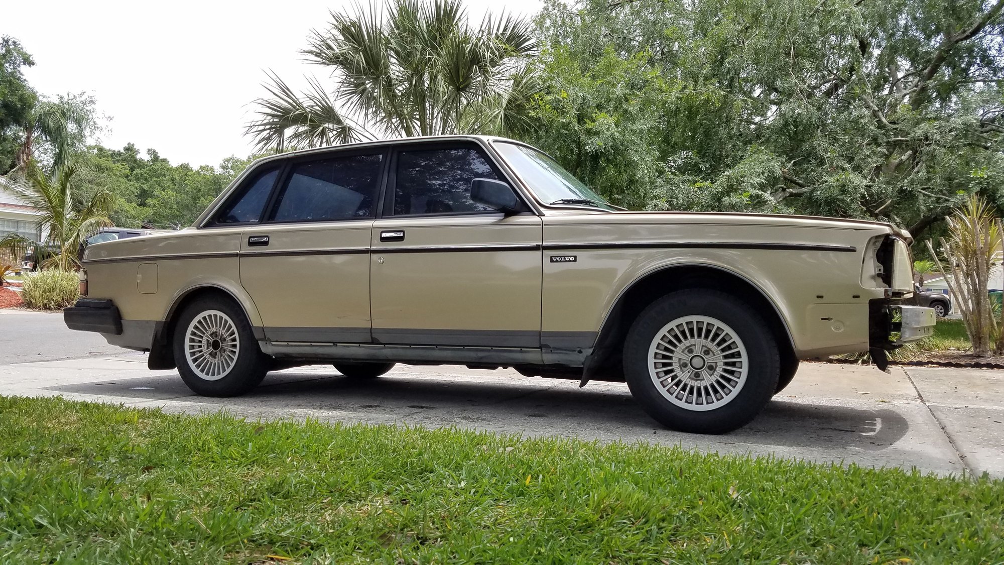

so i haven't done much lately on it, but i did clean it up, got the sunroof to open finally, cleaned the mold that was all over the headliner off, and changed the spark plugs (this was a NIGHT AND DAY difference). i'm in the process of changing the fuel filter because sometimes if you give it too much gas too quickly it will like bog down and have no power, so i'm thinking it's the fuel pump. if not, i read it could be the fuel pressure regulator? hopefully when i get the filter in tomorrow it'll be fine.
here's some mostly current pics.
also, yes....those are bungee cords holding the headlights in LOL. i am working on getting the parts to rebuild the front end haha. it's not my daily so the headlight thing doesn't matter lol.
