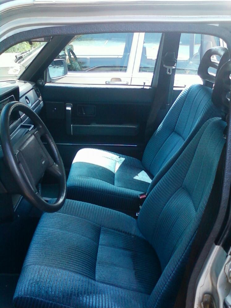

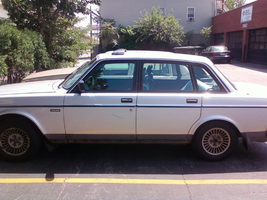

$550 Don't really know much about it so any info would be appreciated. The things that I know are wrong:
windshield wipers and driver side turn signals don't work (front signal is busted)
odometer is stuck at 129000 miles
the up arrow light comes on when i start the car but goes off when I start driving
leaking a little bit of oil
Attached Thumbnails My First Volvo-volvo-240.jpg   My First Volvo-engine.jpg   My First Volvo-front-seat.jpg

Man you got a great deal...! Nice wheels and the interior looks great.....NICE.
A thousand in maintenance/repairs....that is a great investment.
