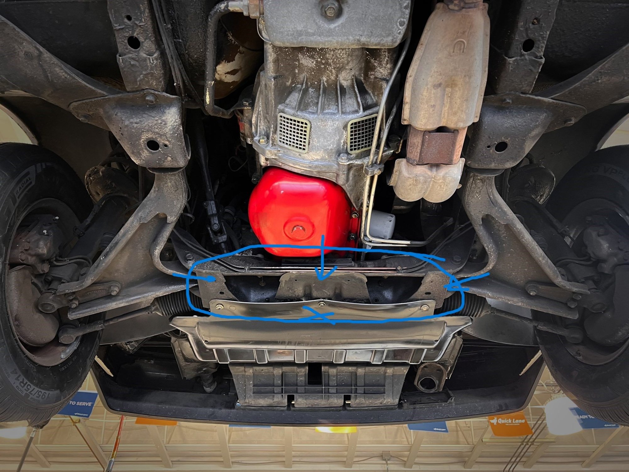

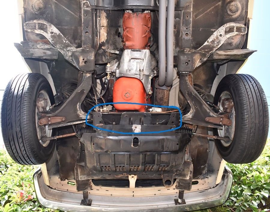

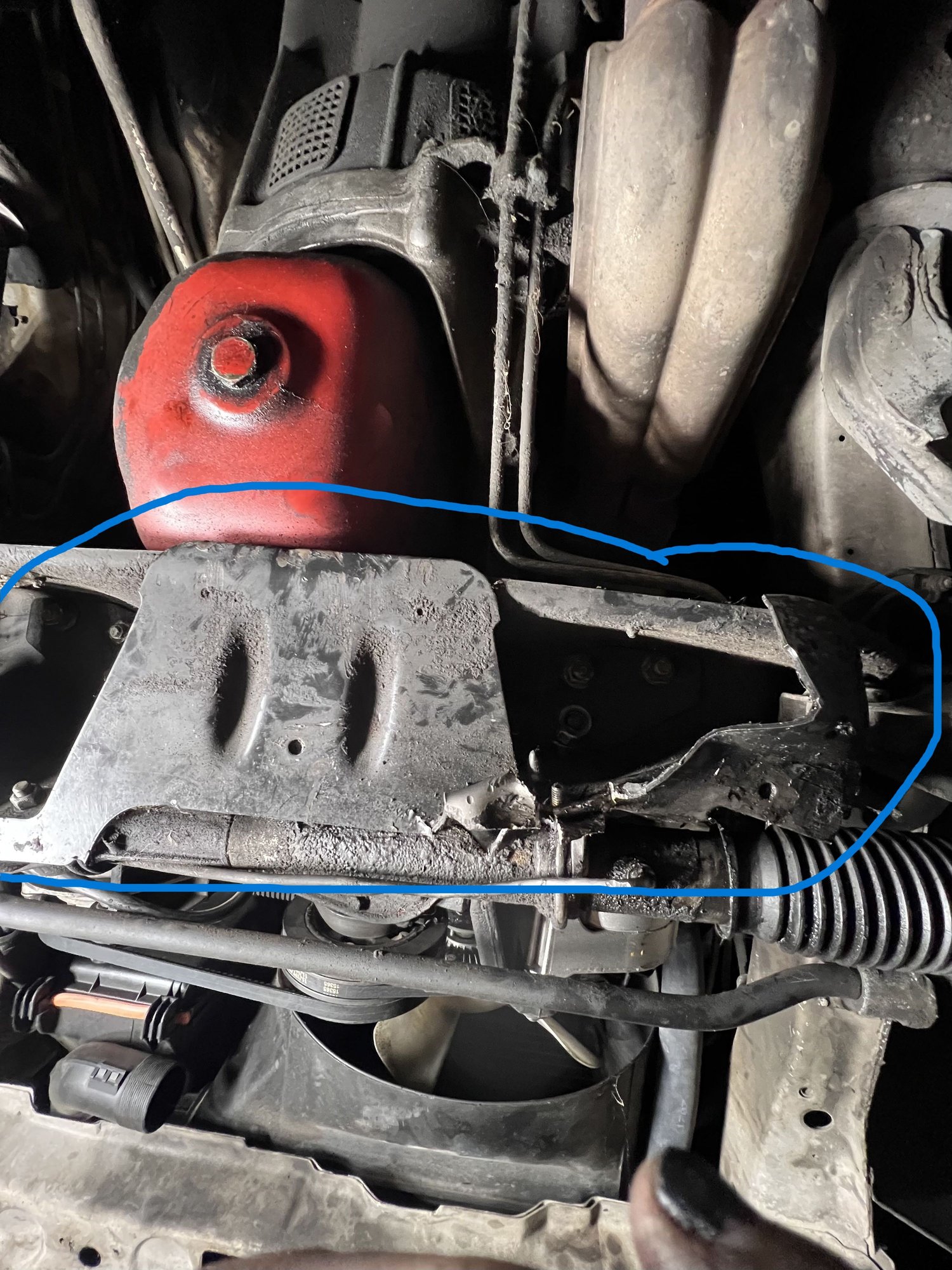

I recently hit a curb somewhat hard in my 1990 240DL and ended up cutting my power steering line but also bending a part which I'm not sure what it is. I'm asking for help in identifying the part which appears to be connected to the control arm and was originally partially under a cover at the front of the car. I'll include reference pictures of the part I'm trying to find and pictures I took of what mine looks like. If anyone can help identify the part and possibly link me to where I can buy a replacement it'd be very appreciated. (also the cut on the part was so I could remove a nut that was stuck from the bend)
Old Nov 13, 2023 | 08:07 PM
That's your front sub frame. Find a 1205674 used if you can. All 1985-93 240's use the same part.
