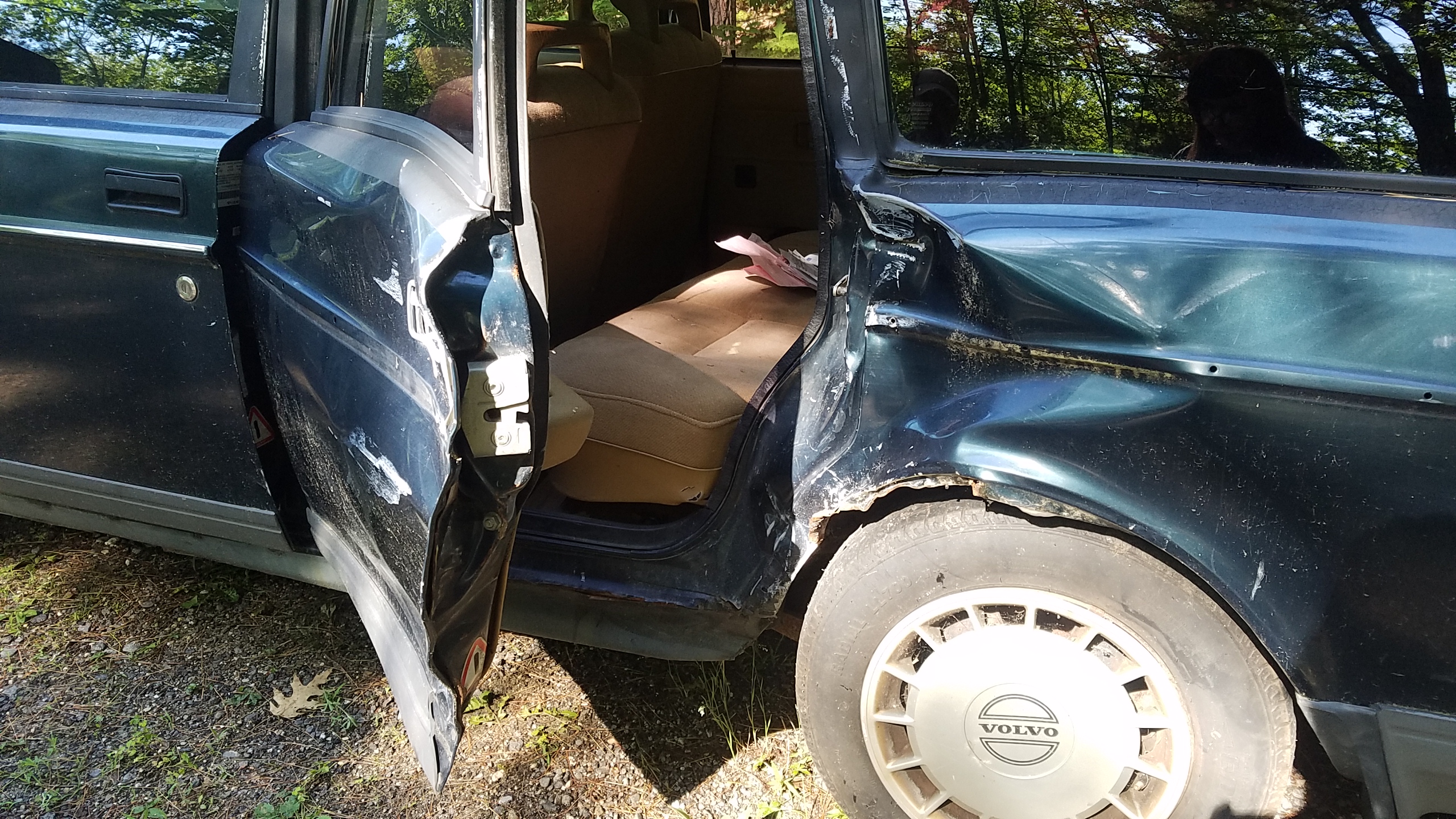

I bought a '93 240 today. I've never owned a Volvo, or a car this old but I'm so excited. The car was sitting for a year after it got hit when the previous owners had it. But we put a new battery in it and it runs great. I've driven it all over central Maine today and it didn't have any problems. Of course, the side if heavily damaged and I will need to find a replacement rear door and rear quarter panel, but I'm excited to restore this car and have it ready for an inspection sticker.

note that rear quarter panels are welded to the body, they aren't like front fenders that are bolted on. Judging from your picture, you'll need the wheel arch piece behind the quarter panel, too.
at a JY, you'll need an angle grinder with a cutoff disk (and a suitable power supply, like a gasoline compressor or generator) to remove those.
