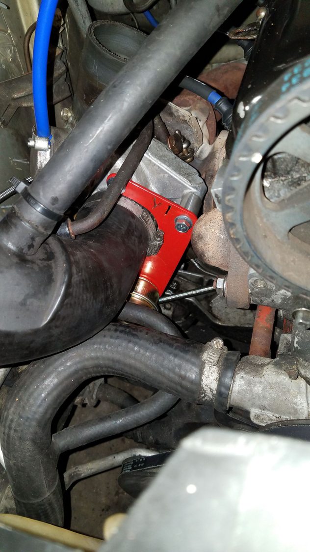

Just got this in from Yoshifab to replace my old and crusty stock actuator and embarrassing bracket. My old actuator was actually bent on the can part, causing the rod to grind against the sides of the hole. This was causing my wastegate to get stuck open.
Seems like a pretty decent deal for only 60 bucks.
