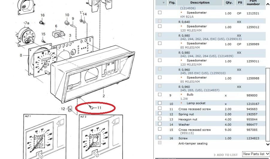

The one in my car is different, it wraps around the cluster. I haven't been able to find any screws to take it off. this is a link to a picture of it (not my car)

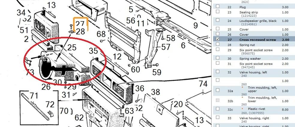

Sorry it's like the 1978 I had. Remove the top of the steering column cover (#25) to expose 2 screws at the bottom of the cluster. And that's a great looking interior for a 44 year old car! Find and install a tachometer in the middle of the instrument cluster for fun.

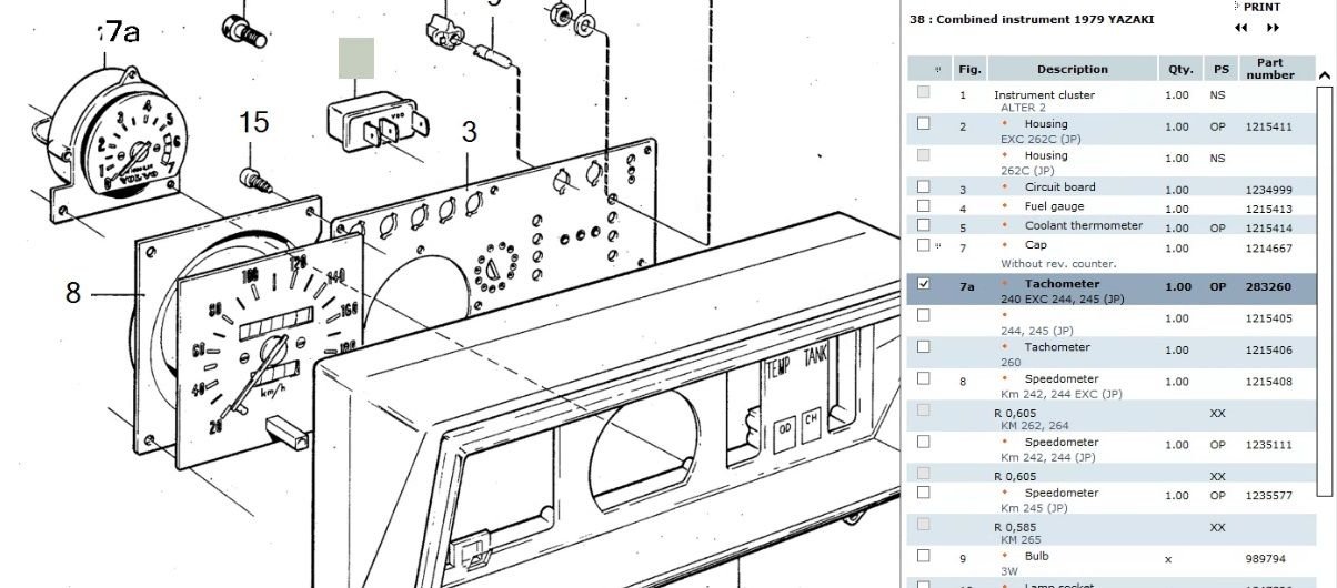

Hi Hoonk, I did as you said and still it will not come out. The instrument cluster seems to be attached to the dash even after I removed the two screws as you recommend above.
I'm at a loss here
