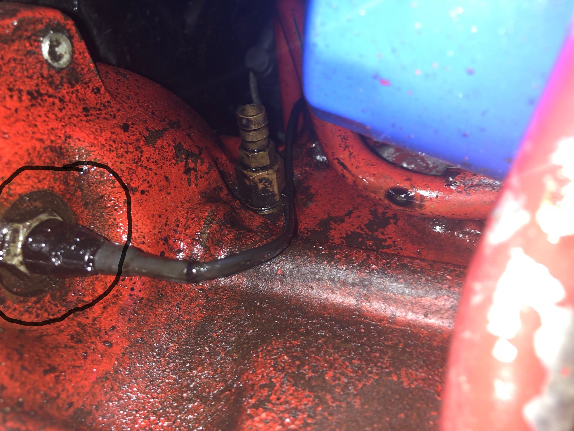

I was wandering if anyone knows what this sensor could be?

i'm not remembering ANY stock sensor there on any of my several redblocks, including a couple turbos. that pipe on the right is the oil return pipe from the turbo, that brass fitting above your mystery sensor is a coolant drain.

Yeah i was thinking this could be were the oil was leaking from and running down to were the trans and engine meet. And on a couple lines coming from the trans. Is there a common area were it could be leaking from to get here?
Old Apr 2, 2019 | 11:07 PM
clean it all off with foaming engine degreaser, and add a vial of ultraviolet fluorescent oil dye to the engine, drive it a short distance, then inspect in the dark with a UV flashlight.
my hole engine and tranny were soaked in oil from a tiny leak at that turbo drain tube I mentioned earlier. it would blow back at highway speeds and cover /everything/

i'd love to know what that "sensor" is, never seen it in any Red Block, this is a B230FT, right, not a six? It doesn't even look like a Volvo type connection, weird! If somebody tapped that in there, why? What is there to measure in that spot?
Apart from that, your oil leak seems to come from above and seems to have been there a while as there is a lot of old encrusted residue all over.
Where does that wire go to, from the sensor to where?

near as I can picture in my head, the only thing on the other side of that sensor is the flywheel/flexplate

I found that the mystery sensor connect to this diagnostic tool on top of the valve cover
Old Apr 7, 2019 | 09:39 PM
'diagnostic tool' ? just looks like a 3-pin connector to me. and, doesn't look like /anything/ I've ever seen on a B230FT engine, either. in fact, it doesn't look like any volvo connector I've seen.

Interesting. It's been there a while for sure. There is just an empty threaded hole in there in the block, what would anyone plug in there?
I guess next step would be to unplug the connector at the sensor, undo the retaining nut and see what's there. At least that's what I'd do... I doubt it has any function at this point, and no way to get a leak from there. You can always put it back in there and it'd be fun to see what's on the other side.

only thing I can see thats back there would be the back of the flywheel/flexplate
