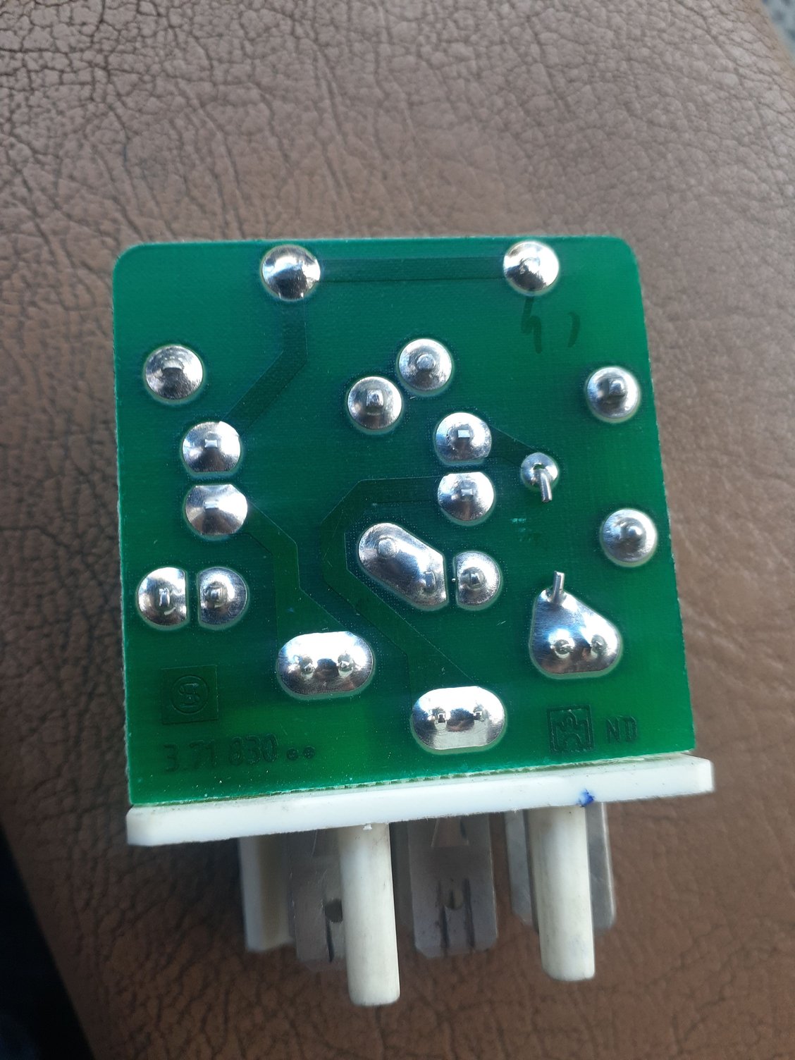

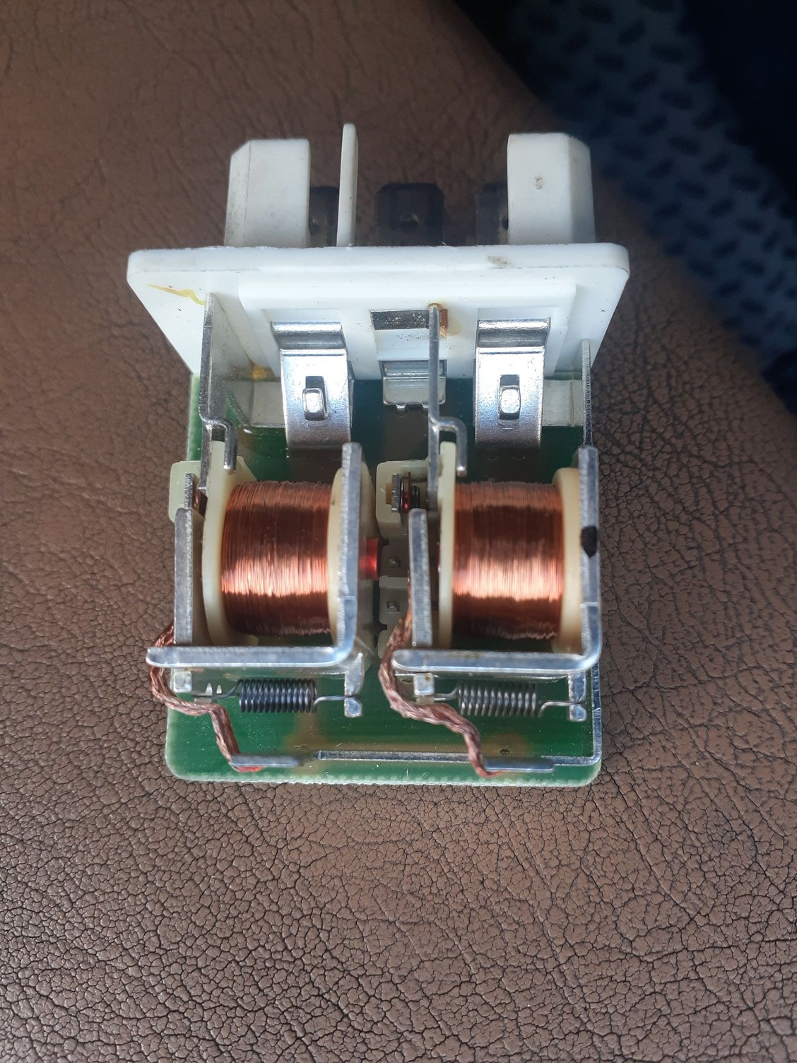

I've tossed about $750 in this car during these past 3 weeks trying to locate the issue, I've had numerous issues with it since I've owned it August 2019. Replaced the head gasket, thermostat, water pump, and timing belt last September when the hg failed. Anyway, I can feel the fuel pump relay clicking when trying to start but I did notice the date on it says 2003. I opened the relay up and it appears to be okay with no noticeable wear or cracked joints. Could my coolant temperature sensor be a problem? I'm not sure if i should even try taking the car back to that shop since they kept it for over 2 weeks and only wanted to throw parts at it.

The fuel pump relay is the last thing I can think of to replace since it appears to be 18 years old, my rsr is less than a year old and clicks a couple times when trying to start. Will be going to the junkyard to grab that relay, anything else I should grab?

Default Dont give up!!!!!
Definitely get that thing outta there!!!!!! No matter if clicking or by looks.
last component to try or look at is a completly shot or dead ecu.....

Replaced the fuel pump relay with no luck, used a known working relay from my friends car. Out of ideas, having the car towed back tomorrow.. Will have to try another ecu if they cant pinpoint the issue.
