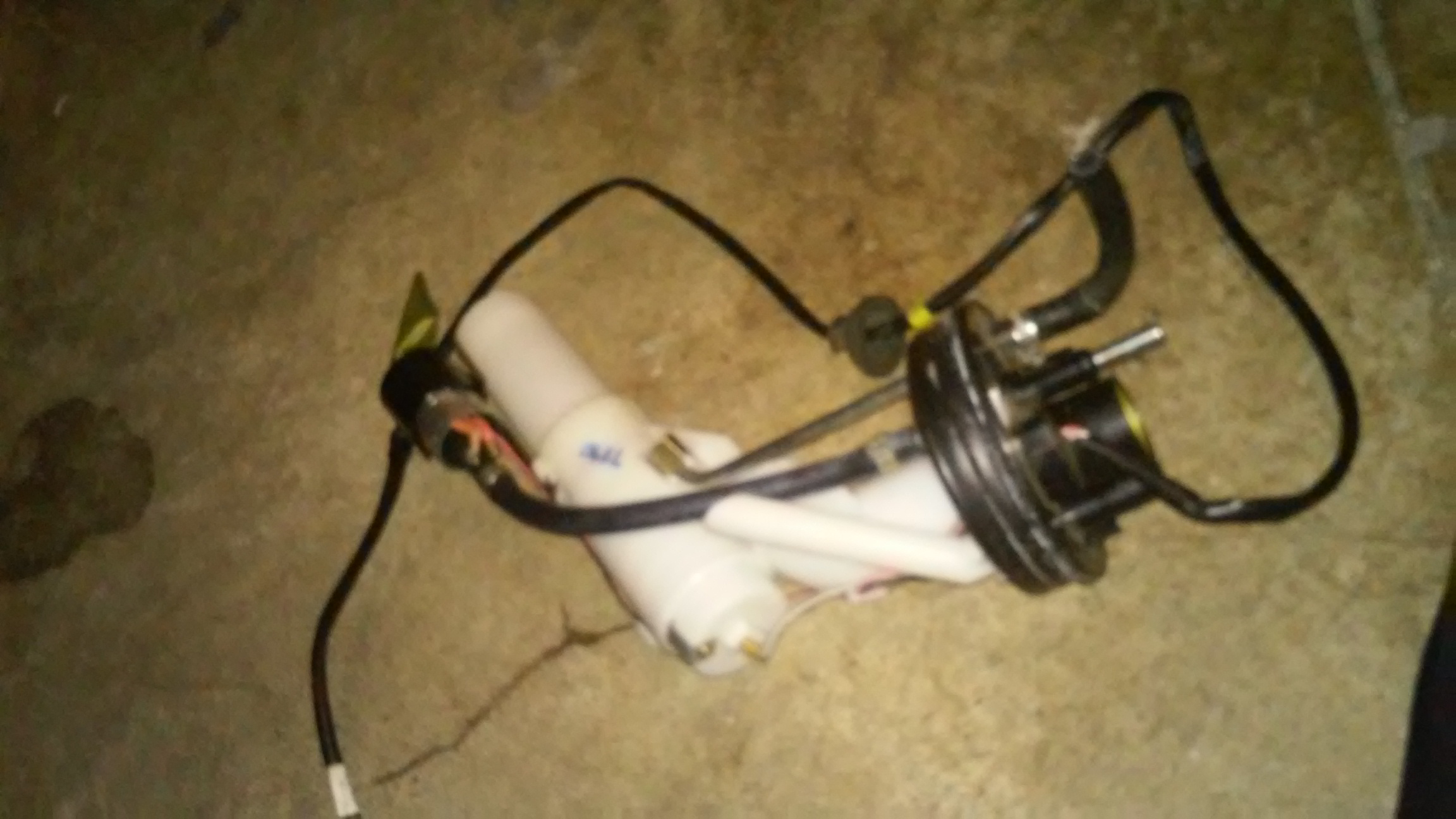

A 1990 740 na showed up at the pnp.
It has what looks like a regina coil...
but i pulled and bought the fuel pump and filter assembly from underneath the car...
and i pulled and bought the fuel pump / sender assembly from the fuel tank...
Both of these pumps i expected to only find on a Bosch system...but that first pic is a regina coil right?
Attached Thumbnails regina vs bosch-20160124_100249.jpg   regina vs bosch-20160124_114148.jpg   regina vs bosch-20160124_115043.jpg
Old Jan 24, 2016 | 11:18 AM
regina and bosch LH use the same fuel pressures and delivery volumes, so either pump system works for either type. yes, I've heard of hybrids that had regina injection/ignition but bosch pumps.

So i could use these fuel pumps on my 1989 740 with the lh2.4?
And could i use the underneath the car pump on a 1992 240 with the bosch lh2.4?
I bought them with the hope/belief that i could...and the fact that they look new and cost $40 for the pair.

If this car had both pumps and a Regina coil then it's one of those rare "hybrids", in some 1990 only I believe... The fuel pumps must be Bosch then with the Regina coil--the pumps wouldn't readily swap into a true Regina car... Uncharted waters for me at least.

Of the 3 non turbo redblocks our household is driving right now 2 have the Bosch lh2.4 system ('89 740 and '92 240) and 1 has the regina ('92 940).
The regina car had its fuel pump replaced a few months ago. That car has only the one fuel pump in the tank.
The 2 Bosch cars are running on their original fuel pumps so far as i know. I'm thinking the main fuel pump under the car that i bought should work on either the 240 or the 740. But I don't think the in tank pump assembly will work on the 240...only the 740.
I'll find out someday I'm sure.
The car at the jy was 1990...musta been one of them hybrids...with a wrecked front end.
