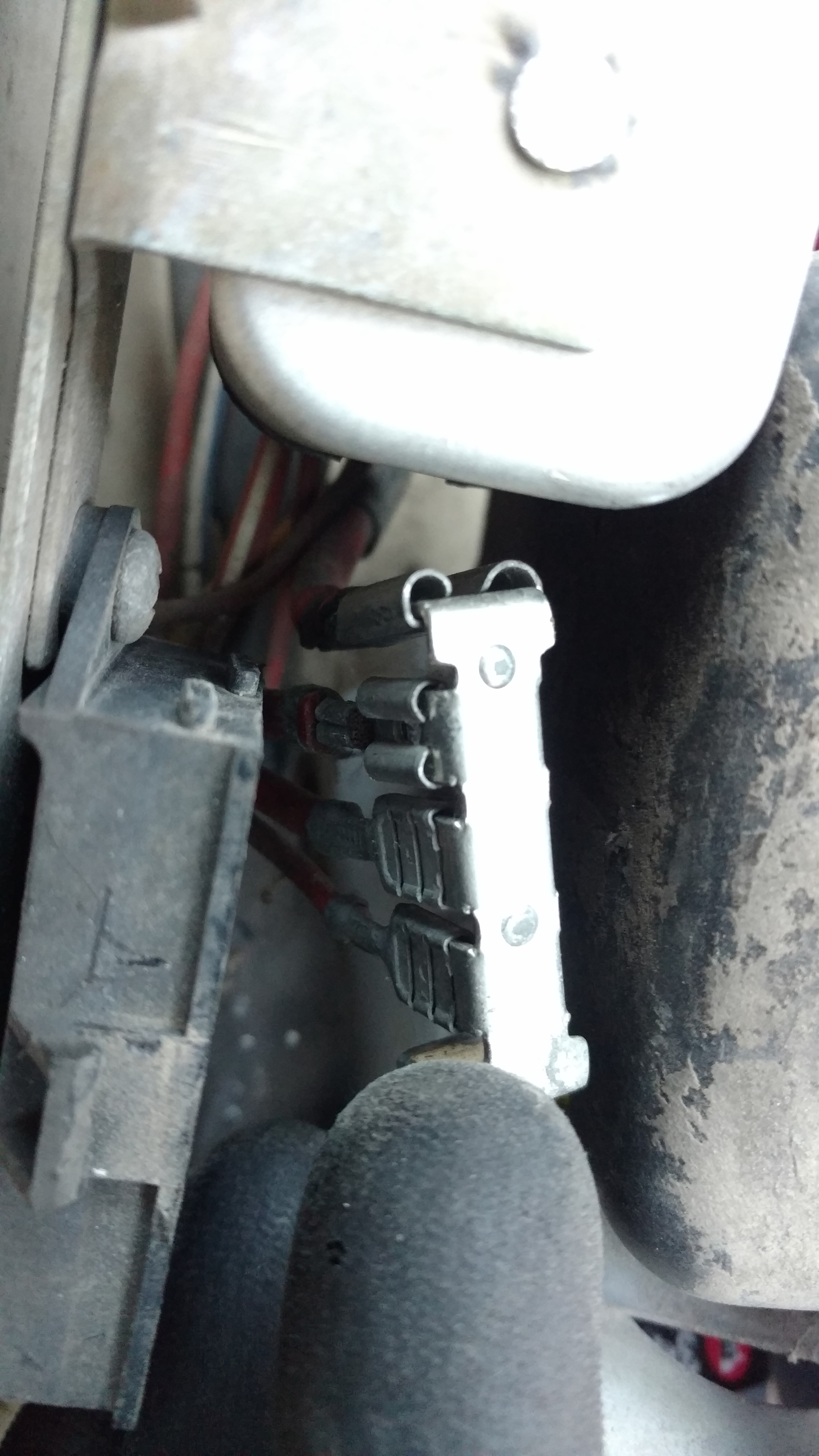

Anyway, the old 240 has a draw on the battery; pretty good draw! Like 60 ma! It all has to do with the little slim box by the battery. It has 1 large spade coming from the battery and feeds 3 smaller spade connections. The one drawing the juice is the first one next to the large spade.
Any ideas what I need to look into here?

hard to tell from your picture, but if thats all red wires plugged into a metal terminal strip, inside a black plastic slim box, thats the 'positive terminal', its just a distribution point for unswitched/unfused battery power. disconnect the circuit that you think is drawing this power, and see what all isn't working.
60mA is actually NOT much draw at all from a car battery, thats 0.06 amps. clock, radio memory, and so forth can be that much as a whole.

Well Pierce, when you put it that way, yeah! That's not much juice. The switch won't engage pretty much anything when the wire in question is disconnected. Further monkeying around has me questioning the Integrity of the starter. Today, twice, the starter has failed to engage. All its doing is clicking now. Ill do further draw tests tomorrow if it isn't to cold here. Hopefully I can get it to turn over and find out if its dragging the amperage down to hard. It could have a short to ground. It was -9 here this AM. Hopefully it'll be a little warmer tomorrow.
There were a number of things wrong with this car when I got it but the price was right. I've got a good feeling about this one. When its running it sounds real good and has good power when driving. I've done nothing in the tuning dept. yet. Can't wait to get her percolating good.
thanks for the input
BTW, your guess was correct on where the pic was taken. I got it zeroed in to close. Hard to tell where it is that close up.
