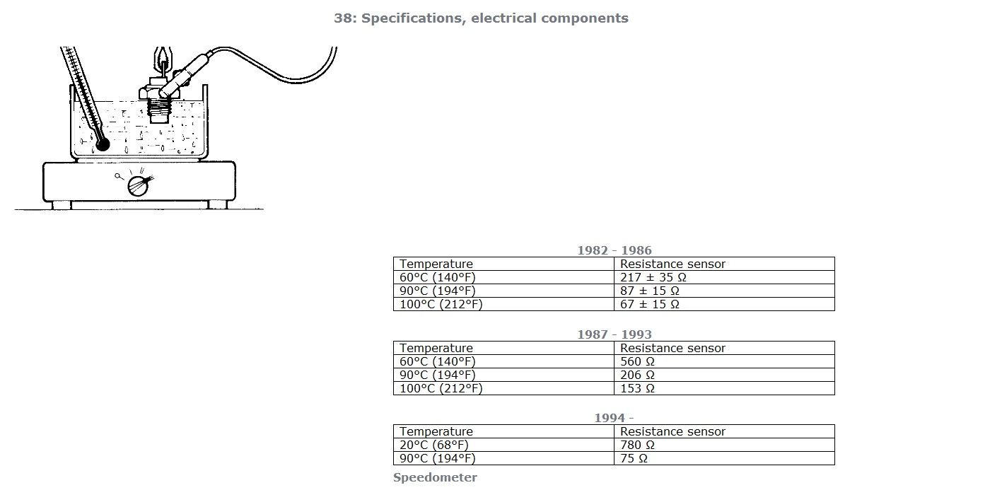

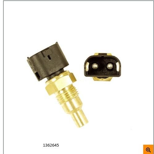

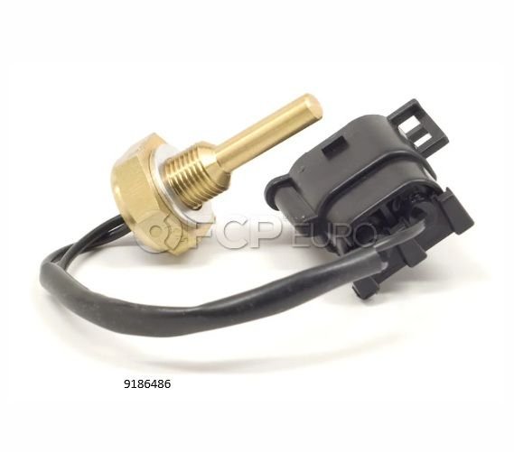

The tach measures ignition pulses - the 740 tach will look for 4 pulses in 2 rpms and the 960 tach is looking for 6 pulses. So the 740 tach will not indicate correctly. Temp sensors - Don't think a 740 sensor is going to fit in a 960 head - measure the resistance (in each sensor) at various temps to see if they are similar - Below is a chart I found in vida with resistance values.
