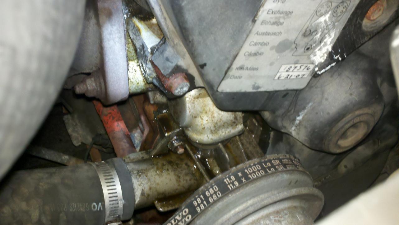

Default it is oil
think/hope it is from the camshaft seal, but may be due to clogged oil trap? Don't know
Attached Thumbnails so...what it is? and what to do!?-2010-11-13_17-01-23_340.jpg

It's hard to tell from your picture, but a very common coolant leak is where the top of the water pump meets with the head
there's no coolant at the camshaft seal, just oil.
the waterpump is a much better suggestion.
Old Nov 14, 2010 | 01:31 PM
if its OIL thats dribbling out, and you previously had an event that blew out the seal on your oil filler cap, then maybe its the valve cover gasket thats failed. thats no big deal at all to replace, at least, not nearly as major as a head gasket. in the valve cover there is only oil, no coolant water.

I pulled the timing belt cover off and it is definitely leaking from behind the camshaft pulley. I am going to attempt to clean the oil trap with carb cleaner and change the oil, hope this is effective and stops the front seal leak as well.

From the sticker in your pic, it looks like the timing belt was replaced at 187k. If you have 247k on it now, you are nearing time for a replacement. That is a good time to replace the camshaft, half shaft and front crankshaft seal as well.
