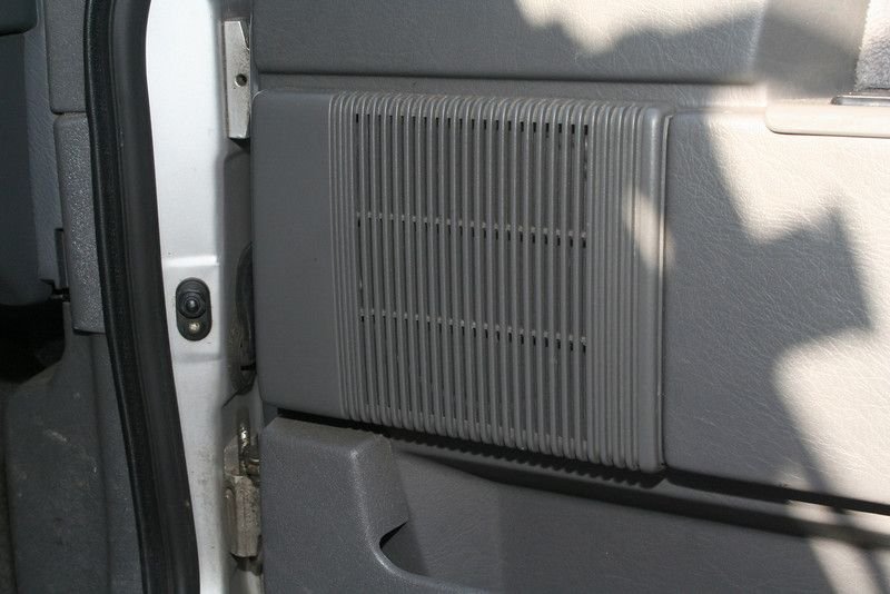

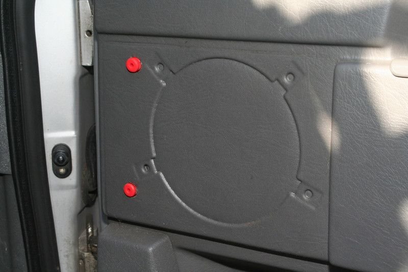

so original door:
6,5" speaker (which required the flange be trimmed so the OE cover would fit...
(fyi, the adapters are on the INSIDE of the door panels, glued in place with Silicone 'RTV', I also use a light coating of RTV on the speaker itself where it goes against the door, this prevents air leaks that reduce the bass, and also reduces rattles/buzzes).
rear door w/ coax...
