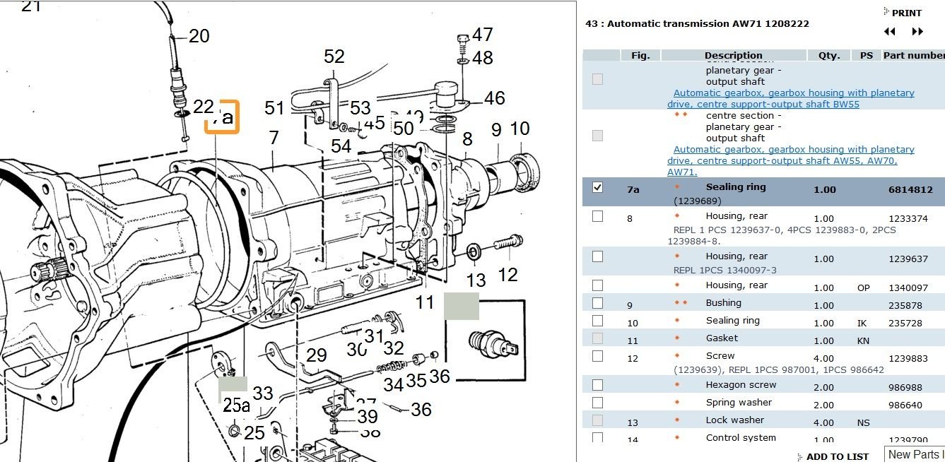

The bell housing orings can leak - there's really no cure other than replacement - the parts are available - and it does not require "overhaul". It does require removal of the transmission to be able to get the bellhousing on and off. Below is a link to one of the orings - there are 2 different part numbers for the 2 orings. I would not count on a seal swelling stop leak product to make an old hardened oring swell up enough to solve anything. (the rubber orings would usually break apart during removal the rubber was so hard)

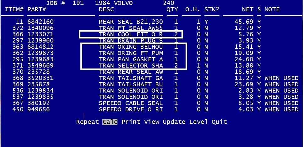

There are many seals that can leak and the fluid ends up dripping from the oil pan. Cooler fittings, selector shaft, bellhousing orings and the pan gasket itself. Not included in the list below is the oring on the kickdown cable. Only the bell housing orings (and the front seal) require removal of the trans to replace.

Three different mechanics have advised me over the years that my leaking seal, which is near the solenoid, can't be fixed without removal of the transmission.
Old Dec 9, 2023 | 01:14 PM
  #17
That would be the bell housing oring - 7a
