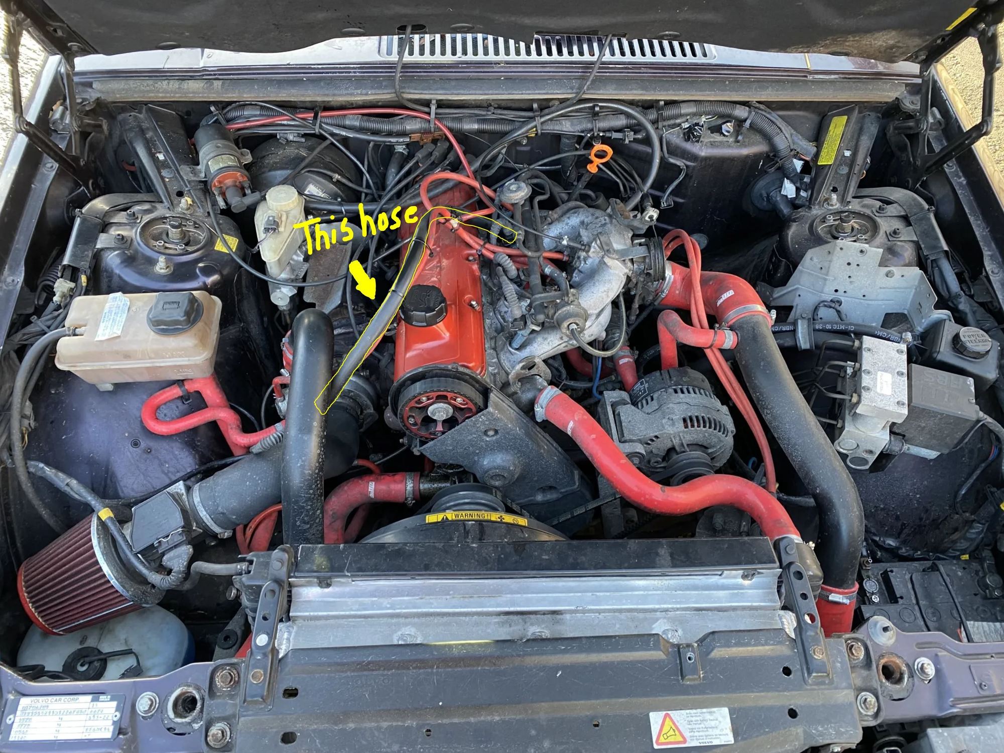

I also provided a screenshot of the evap hose I referenced for clarify/further information.

Evap hose I referenced (not my engine bay)
