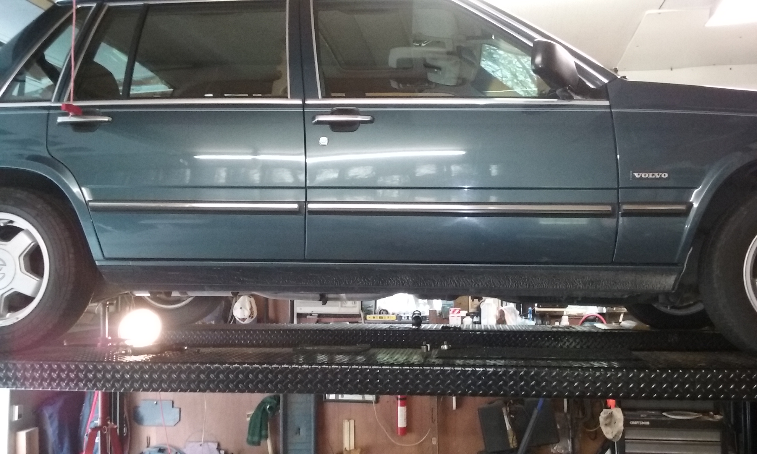

I got that problem solved.

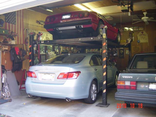

I had to get it for the extra parking space but it has been useful to service all of our vehicles. Believe it or not I just looked it up and I bought this 18 years ago.
